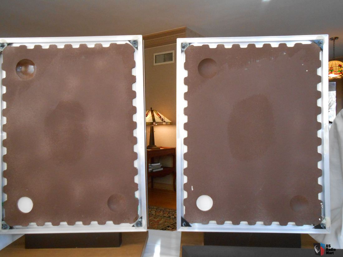

Bertagni Electroacoustic Systems (BES) SM-100 Speakers Photo #1096125 - US Audio Mart
So the panel is "contoured" expanded bead PS right? What in the upper right? Is that a "tweeter"?

Yes it is Expanded Polystyrene (EPS). The upper right is a exciter that is used as a high frequency transducer, while the other exciter in the middle is used for the low frequencies. The exciter used for the high frequencies uses a single non polarized electrolytic (16uf) capacitor, which is around 1200khz.
Bertagni speakers are a advanced design as you will either have to have a CNC machine and or be a experienced sculptor. I have 4 years of sculpting experience LOL.

I agree DMLBES, but in this instance I was commenting on the fact that both units have the tweeter on the left side, and are not mirrored on the front. Unless, this pair is made up of two left or right units? Looking closer I now see that they are consecutive serial numbers, so it appears all units were made the same with no designated left and right speaker.
Not quite sure what this 'brown stuff' on the front(?) of the diaphram is? Some form of damping?

I like how this looks covered with a grille - although it looks more like a conventional speaker now.
Looks like a custom molded ribbed EPS foam is the main resonator panel. is the corner tweeter an isolated small panel of just another driver attached to corner?
Looks like the front radiator is covered with open cell foam?
I think the brown foam may actually be the both the suspension and damping material for the EPS panel, given the corrugated dovetail edges.
So open cell foam bonded to the EPS radiator panel on the face, but attached to the frame at the edges to "float" the EPS panel in 3d space.
