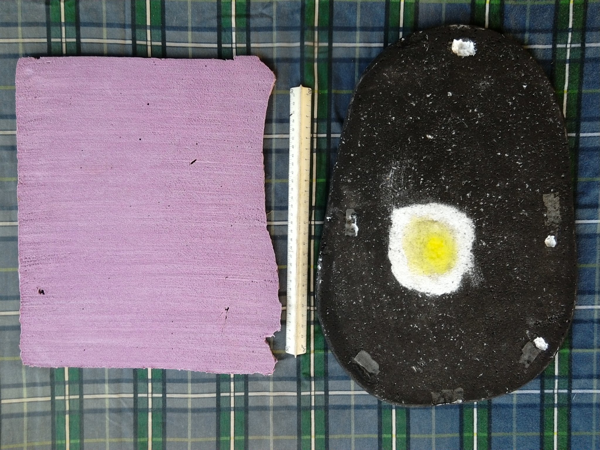

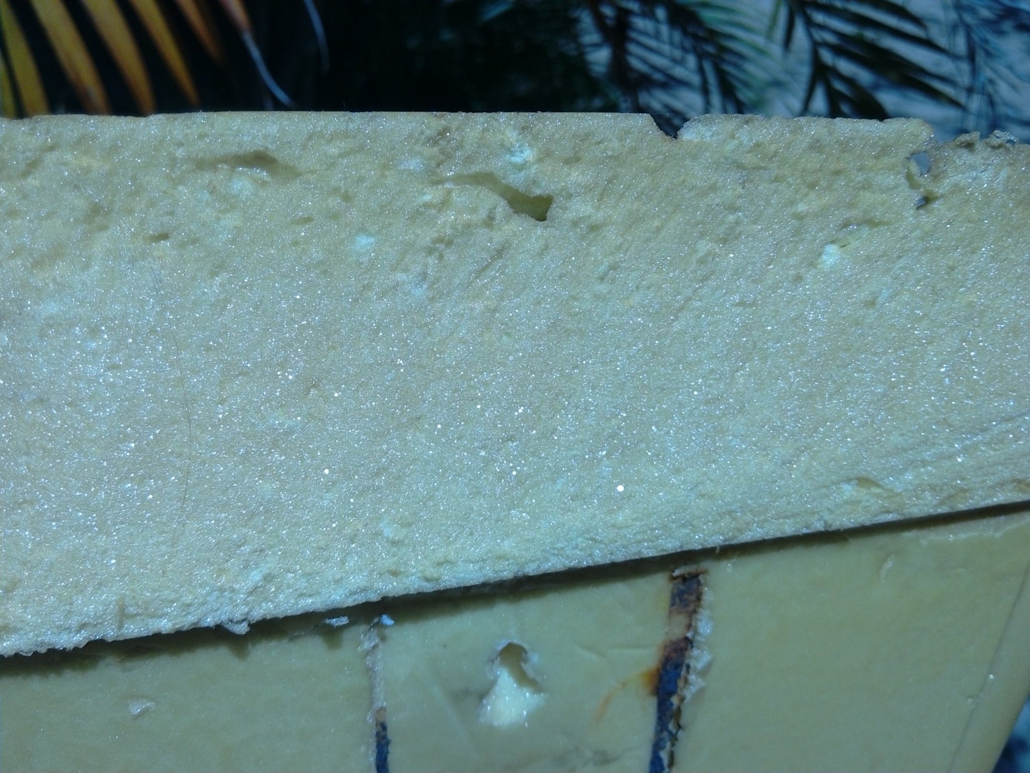

This is the material I have been referring to as high density EPS, came from a very large cooler. I know that EPS is made from beads of foam within a mold so am really not sure. It sounds way more natural than the really hard Pink Panther material that I have which is for sure XPS. Regardless, this is the best sounding material I have tried so far. I'm still going to revisit the canvas panels later but for now am happy.
Any thoughts from the photos would be appreciated:

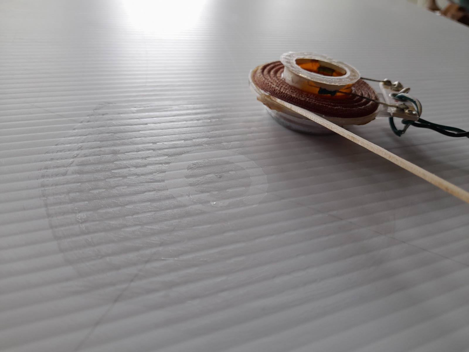

I was thinking of trying the 2 mm protex material for one of my small panels ?
I also noticed that they make a 3mm panel.
I can get the 2mm from wickes down the road, but probably won't bother getting the 3mm + postage.
the two types of panel you sent me have a pretty good sound, with very little build time.
you just have to cut them to the size you want.
I'm going to try my thin strip of paper and see if this improves things a little ?
I'm sure most people would be happy and surprised at the very good full range sound quality produced but these 2ft panels.

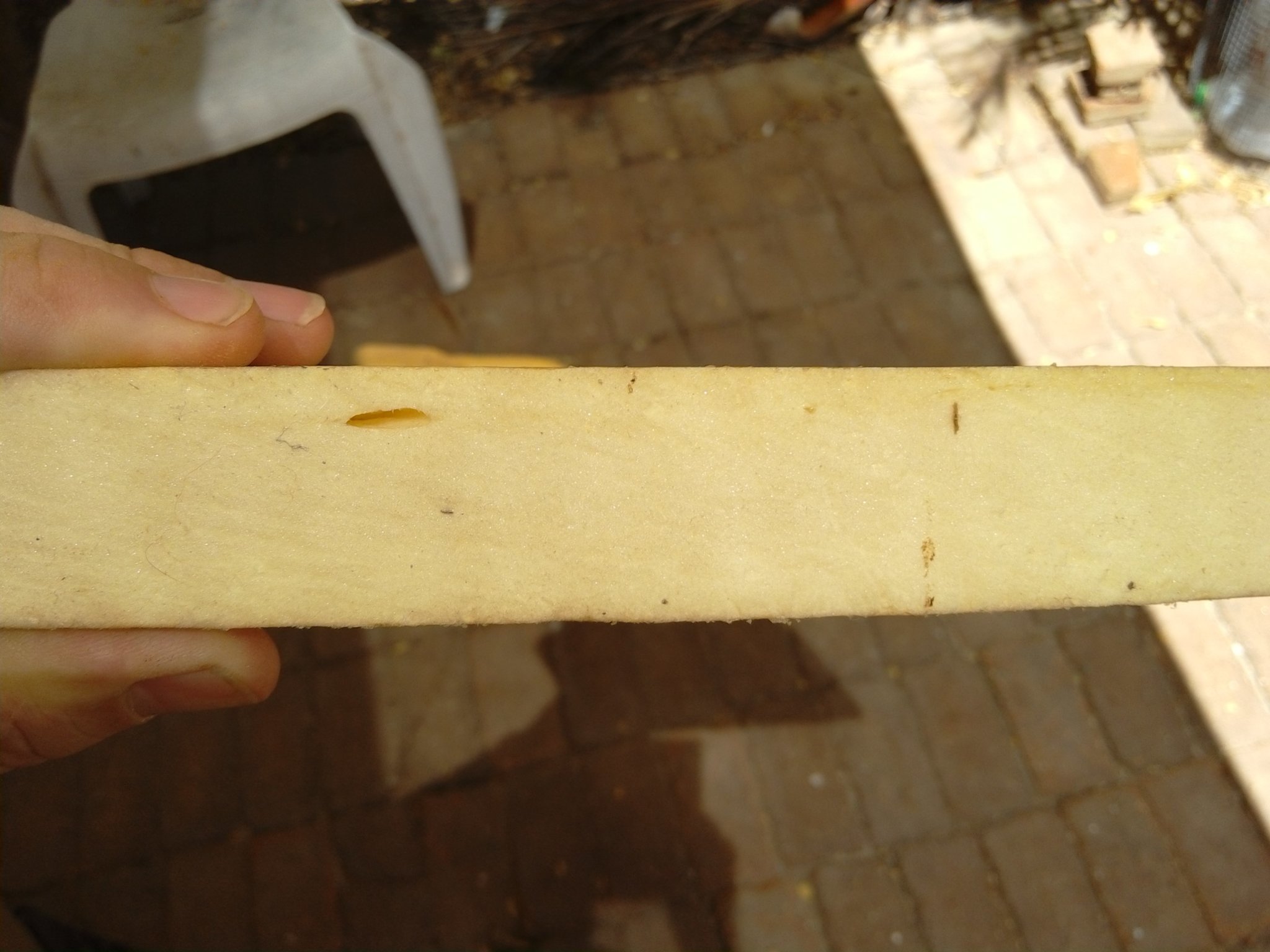

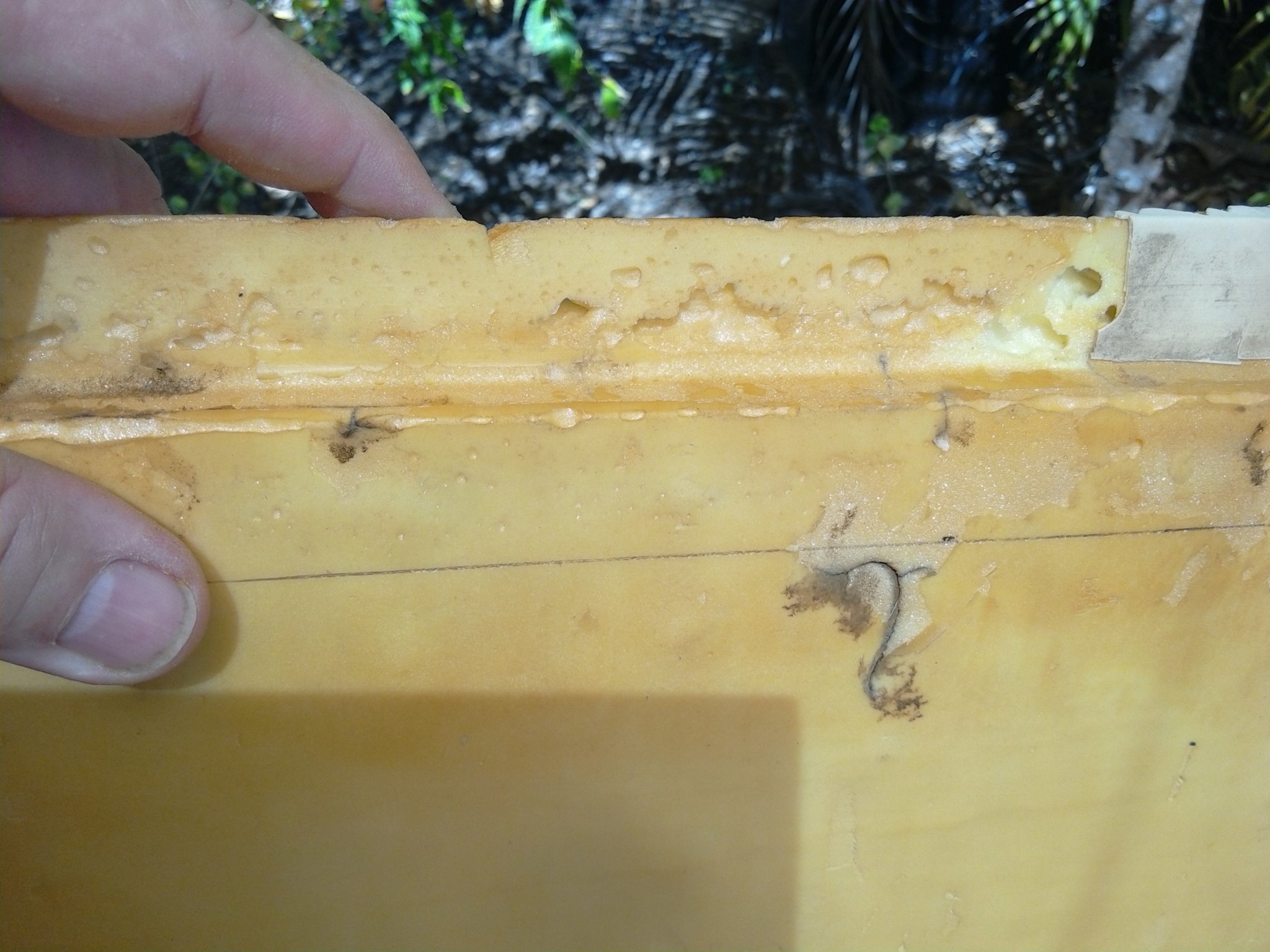

Steve, this was my exact thought upon first seeing and holding it, the color and everything. I have used can spray foam many times. "Spray foam insulation is made by combining isocyanate and polyol resin into a foam. Polyurethane, a polymer made of organic units, is the most commonly used material for spray foam."Toddincabo.
this material looks like the expanding foam used by builders to fill in gaps between piping and walls ?
As well as insulting fridges and freezers.
not EPS.
Steve.
This stuff is way more dense than what I've seen from the can. Below photo shows the pink stuff and I guess a medium EPS panel. I use the "rope saw" strung taught technique from one of my earlier posts to thin my material and this stuff was dry to the bone and extruded a very fine powder dust. The EPS and the XPS pictured had more of a faint "rubbery", thick dust.
I'll call this material "Poly"? I mounted the exact exciters to the Poly and the EPS pictured with the Poly panel being 16"x10"x1/2" and the EPS being 18"x12"x1/2" and did an extensive A-B comparison. The medium grade EPS was more efficient/louder but did not sound as natural as the Poly. These Poly panels are amazing at wood instruments and vocals as well.
"Polyurethane, a polymer made of organic units". These panels are for sure the most organic sounding panels I've yet tried, which is my preferred taste. We just may have a contender here.
I guess a thin form could be built and lined with whatever skin desired and spray some high density can foam into it, remove the form, cut to size and Voila! Man, that's all I need is a new project, but will keep this in the back of my mind.

OK I will wait and see what you send me.
If the panel is too floppy , I will just make the panel smaller.
I did have my eye on the 3mm anyway.
Personally I avoid panels that are too rigid.
Its not just that the panels you sent me are usable, it is the fact that they are easy to make.
I just stuck the exciter on the 2ft panels you sent me and that was it 😀
I did find today that my strips of paper , does help the sound, in my opinion ,that is.
but the sound from get go was good.
good enough for me to keep listening, and playing more CDs.
I had no problem with the performance of the corrugated cardboard I first started with , it was just the sound of the cardboard .
The panels you sent me have quite a neutral sound , with low coloration.
although they have a good flat response to 20k ,the hf is a little subdued, similar to the podiums.
I have mainly been listening to jazz, using the panels full range, listening to close mic recordings of the double bass.
So far no problems, in my room anyway ?

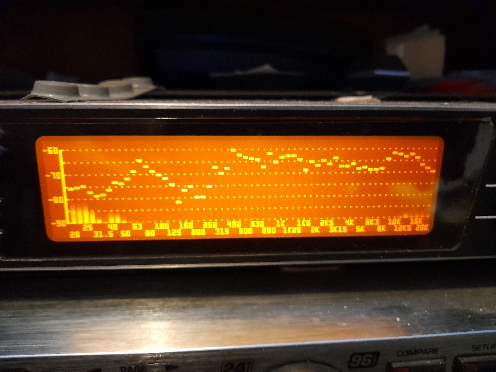

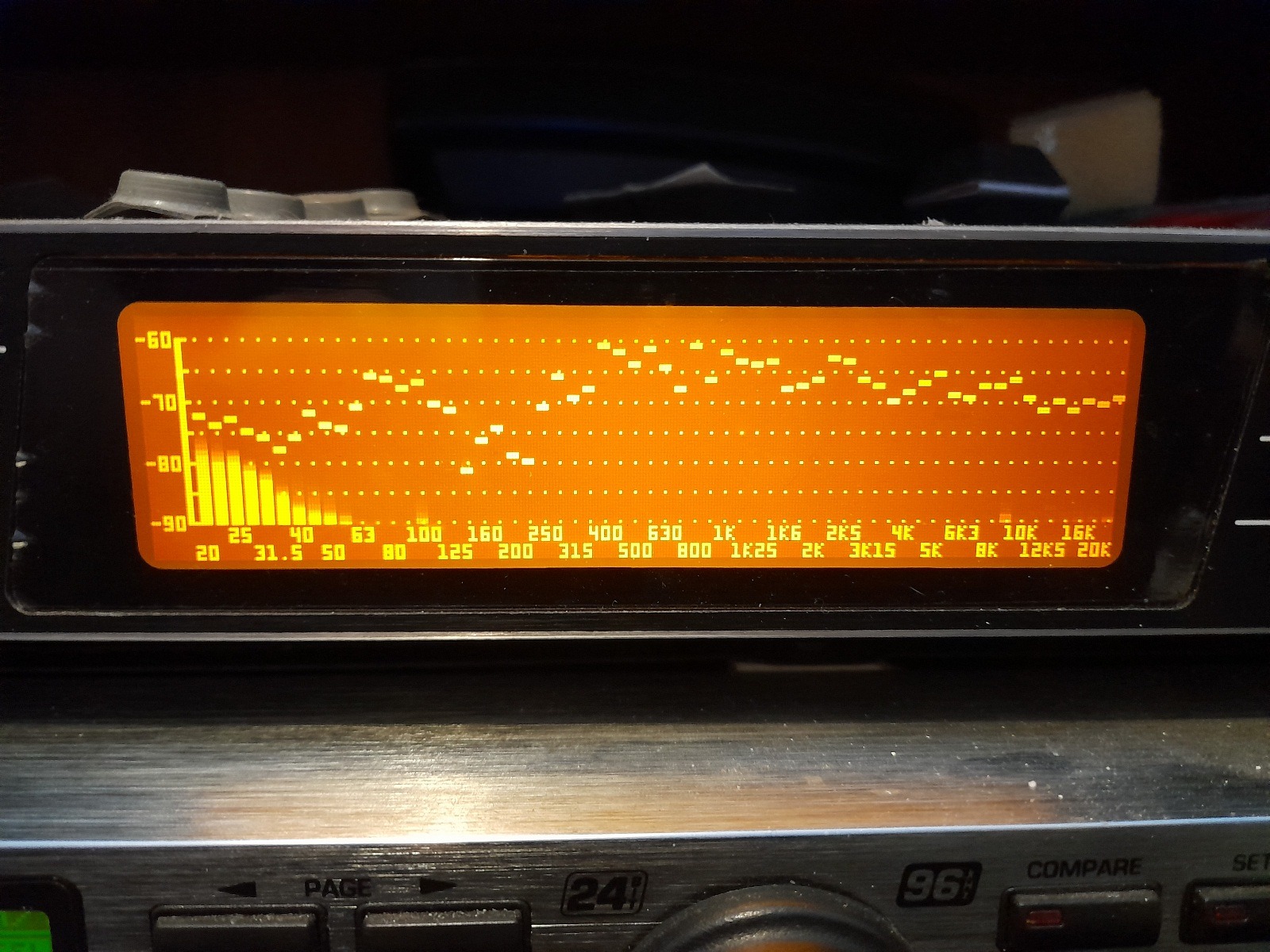

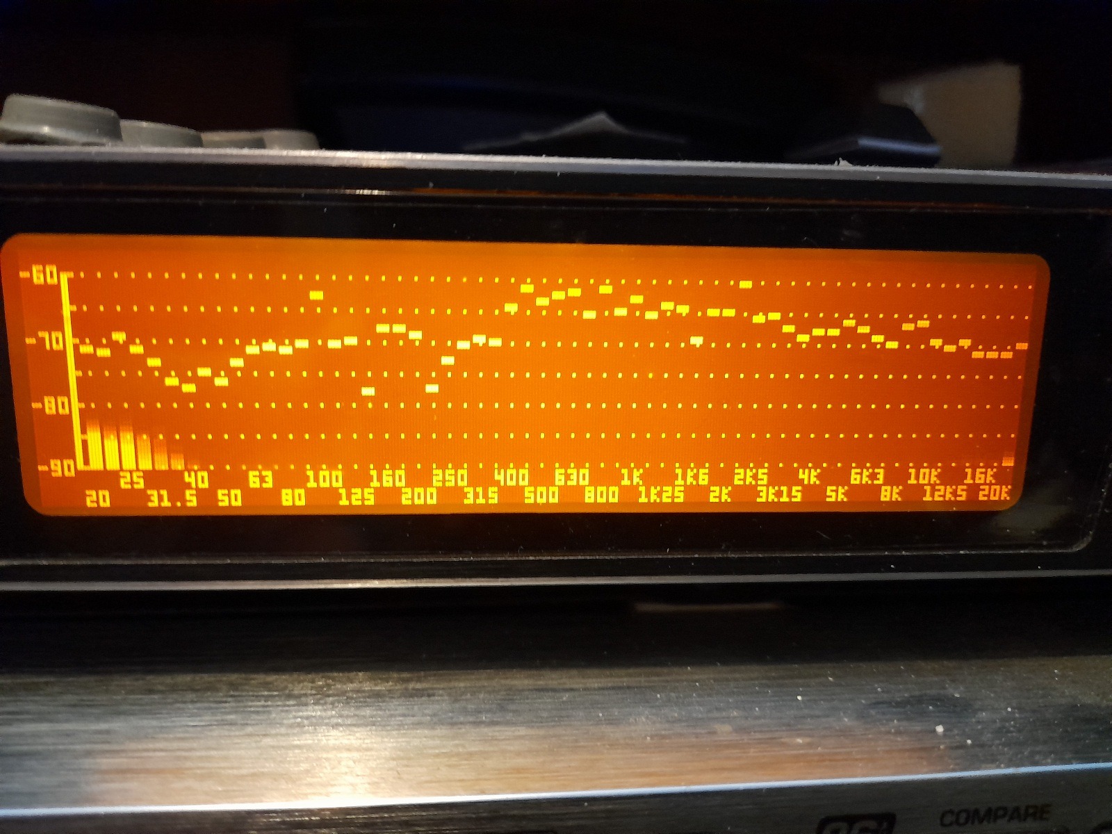

i was half way through this recording when the wire from the left exciter broke.
that is another reason its a good idea to brace the exciter, to stop the wires flexing and eventually snapping from the terminals .
but the recording shows the low end performance before terminating .
i was playing the music quite loud and the AVC kept cutting in, which was annoying .
i did try recording at a lower volume but the same happened.
my 10watt exciters were starting to get warm using them full range, so a more powerful exciter is needed for that.
but it shows good output to about 30hz with a little roll off from 40hz in my room.
nice and solid.
as you can hear in the recording.
the mic was at about 1m and the panels were pointing straight down the room ,with no toe in.
steve.

I might try 2 or 4 of my 10watt exciters and see what happens with the low frequencies, I could Even try the tectonic mounting method ?
I'll have to think about how to implement this ?
But there is no rush.
I did a quick test with some small weights to see if I could fill the usual dip in the response in the 100hz to 200hz .
I had some success, but the low frequencies suffered a little.
Maybe the extra exciters would sort this ?
So with a more powerful exciter or with more low powered exciters , this could be a good full range panel ?
It would be interesting to know how powerful an output in the LF this 2ft panel could do ?
My single exciter is at its limits , let's face it , they were never designed to go this low, let alone at this power rating !

Look what I found on my way back from London ,late last night .
Three new dml panels 😁
I can now do some proper testing of this material.
this material is very bendy and springy.
not like other plys, which are more rigid.
Is this the magic of this material ?
Steve

Some very quick measurements from my seating position ,showing the room dip at about 160hz .
I just quickly moved some weights about the panel to try to fill in the gap, with some success.
The first pic is without the weights, the second is with the weights.
With a little more time (and a computer program 😁) I could do better.
The third pic is with two strips of paper 😱 which I have never done before, heaven knows why ? But it has overdone it a bit above 10k? But still sounds good to me.
Dml panels are very flexible (pun intended) and are very easy to mould into the sound you want.
You just have to know what you are doing 😁
Steve.
Steve.
As I have to remove the exciter to fix the spider, I thought I would test how strong the glue was holding.
I did try prising off the exciter with a Stanley knife but thought I might damage something or me.
So I decided to use an old tried method of just dropping the panel on its edge .
This has worked in the past when I have accidentally dropped a panel 🙄
And yes it worked perfectly.
On the panel in the pic you can see the area I applied a neat coating of pva before gluing on the exciter.
As you can see, There is still a ring of glue on the exciter foot
You can also see the strip of wood showing where the spider was coming away from the exciter.
I shall probably apply some pva to this area.
Problem solved.
I also noticed that the screw I was using to mount the panel was slowly sagging as the surface is not strong enough to hold weight of the panel and exciter.
So now have inserted an elastic band through the hole, which seems to be fine for now.
Steve.
Problem solved.
Steve.
