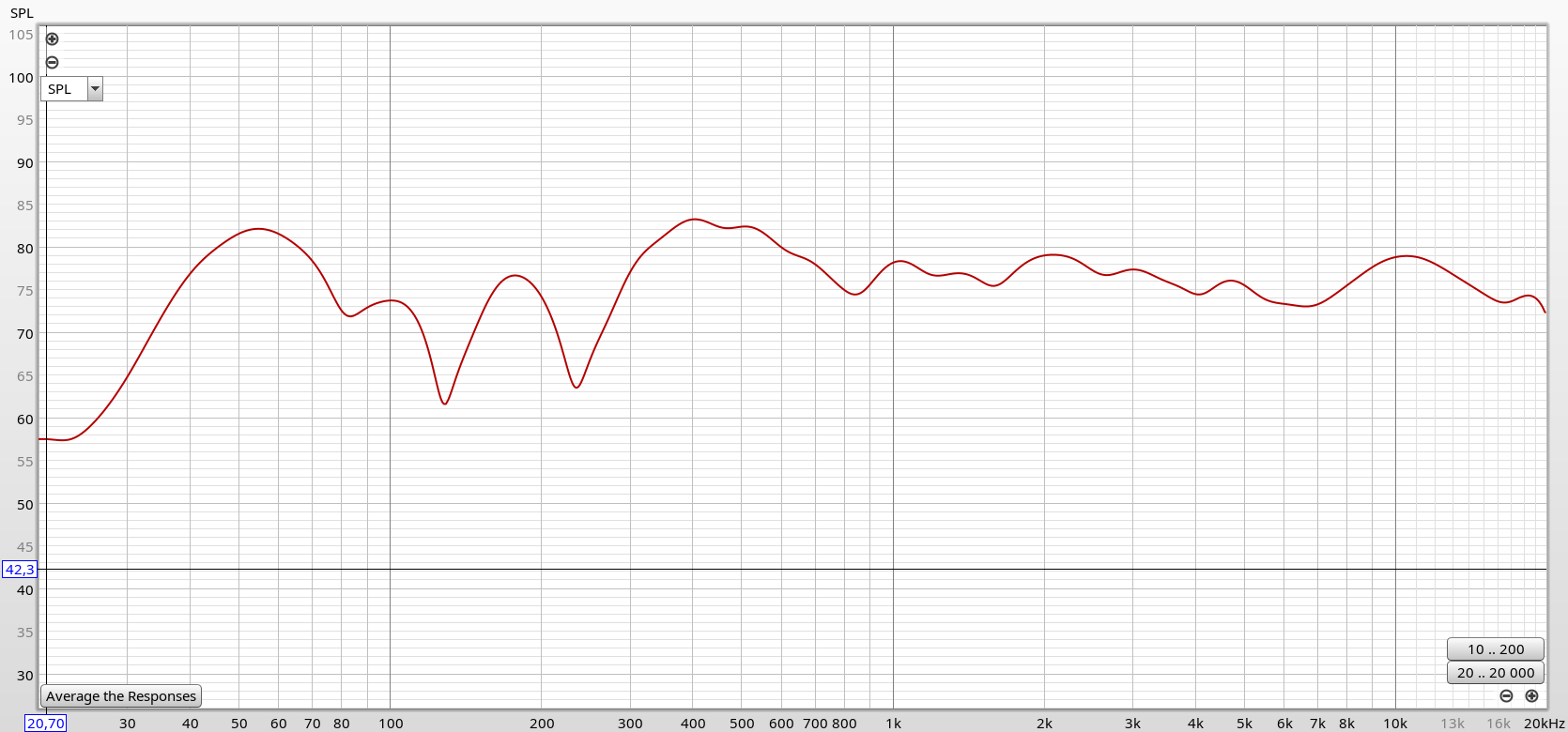

Just to add an element to the "high frequency" topic. Today, I made a new FR of my canvas panel (see below). The HF above 10k is higher than what I get with other panels. Here, there are 2 layers of 1mm balsa (the pad of this canvas panel) behind the canvas itself. It is the same exciter I use on the plywood panel (DAEX25FSHE-4). One difference here, it is epoxy glue.
This seems to be an impressive panel, Christian!
I can vaguely remember somebody saying that one needs a very stiff surface, that the exciter is glued to, to produce good HF.
I would have considered Balsa rather soft/flexible.
What are the dimension here?

This is a canvas panel where the canvas acts like a membrane more than a plate. The canvas is a linen one, 41x33cm. At center, a pad of balsa is glued (PVA): one layer 15x10cm, rounded corners and then a second layer 10x10 grain in the perpendicular direction of the first layer. The exciter is epoxy glued at the center.Ha!
Best wishes,
Sebastian
What is impressive is the 1st mode which gives bass to this low dimension panel. 40Hz from a 41x33cm speaker without rear load. There is a lack of level at 150Hz and 220Hz.
Even if I prefer the sound of my 3mm plywood panel, it is a good wide range.
Christian

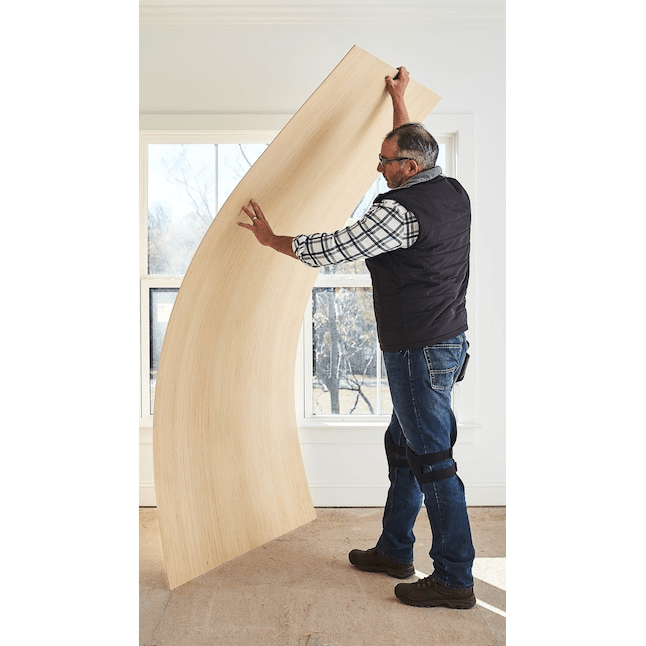

SebastionThat is cool! I don't think I saw Valeric's panels before. It looks like he did merely the same thing, but kept the corners unsuspended.
The sheets i bought are here:
https://www.lowes.com/pd/SurePly-1-4-in-Whitewood-Plywood-Application-as-4-x-8/50124674
They are also available in 8fx4ft and unfortunately, if i would have know that this all works out so great, I might have gone with the bigger version. My sloped ceiling has enough space. But I also need some space for sound treatment....
May be for the house walls towards the backyard :-D
Sebastian

My exciters arrived!
Unfortunately, this week is very busy for me and I won't be able to work on the panels before the weekend.
However, based on Eucy's post I realizedthat something must have gone wrong when I copy&pasted the url from my browser:
This is the panels that I got. I am so sorry Christian:
https://www.lowes.com/pd/RevolutionPly-5mm-Poplar-Plywood-Application-as-4-x-8/50121135
And as an additional note, the 4 ft version does not bend as much as depicted in the picture.
Sebastian

I was (very) unconvinced about using plywood for DML panels. I tried locally available 3mm building ply from our equivalent of Lowes (Bunnings) and it was bad- floppy and very dull.
My first build was therefore made from solid Western Red Cedar boards (stored for over 20 yrs in my garage) laboriously thinned down from 12mm to 4mm and they sound excellent.
After watching @typicaben's bamboo ply panels demo on YouTube () I decided to investigate further.
The material Ben used is called LaserPly (https://plyco.com.au/collections/laserply)
I ordered a sample pack and tap tested them and then tried each with an exciter. The bamboo Ben used was I thought perhaps the dullest but others were worth a try.
In possibility order the first 4 were Tas Blackwood, Poplar, Hoop Pine and Birch. Surprisingly, the poplar sample, which was 6mm thick (2x the others) was very bright and the loudest under excitation and way different from my Bunnings ply material.
I subsequently ordered 3mm Blackwood (5ply) and 3mm Poplar (3ply) sheets and cut them into 900x300 panels for testing. The Blackwood (Acacia melanoxylon) is 2x the density of poplar and very stiff. The 3 ply poplar has low transverse stiffness due to the 3ply construction.
Under testing I found that the Blackwood gave a nice tone and a little more even frequency response than the poplar but because of it's density, it was harder to drive with my exciters (DAEX25SHF4 Steered High Flux 25mm Exciter 20W) even though they pack a sizable punch for their wattage. So currently I'm focussing on the poplar even though it isn't as visually appealing as the Blackwood.
Get to the point Eucy!!
My (longwinded) point is that based on my tests, I reckon a good quality 5 or even 6mm 5 ply genuine poplar panel like the laserply (ie your local equal) should give a significantly better result than the RevPly with far less need for support and for the low cost should maybe given a test before you install the current panels. The poplar appeals because it is a lot lighter than the other species which is important for a ceiling install.

I don't understand how you can conclude from the picture that the revply is not a good material... The results from other revply DML builders are if remember quite good. The picture shows simply the bending of a low thickness plywood.
If you have measurements to share, it would be interesting for all to see the behavior of different woods.
Christian
No problem Sebastian. Thank you for the new link.My exciters arrived!
