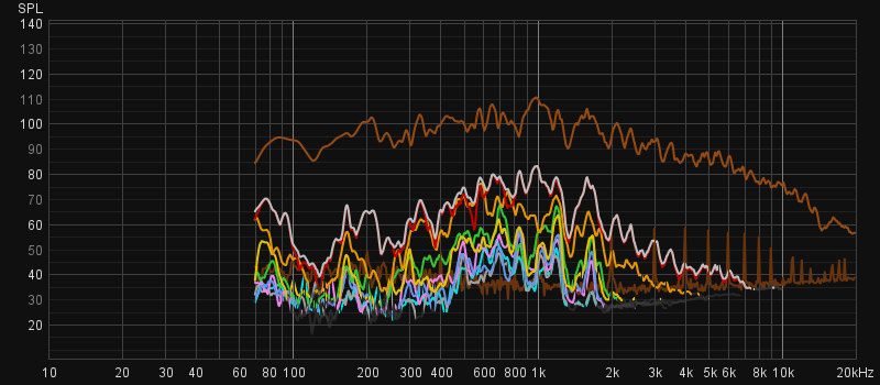

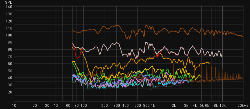

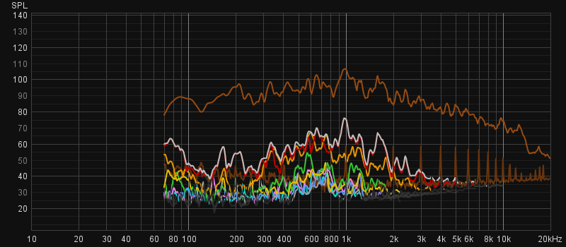

Did some tests with two 50w exciters on a Neopor 500x330x25mm. I really need to work on a good suspension solution, the plate is starting to behave quite wildly!
I don't have the distortion measurements with one exciter to compare with, but my impression is that plate perhaps starts reaching a limit, and distortion becomes obvious at around 60% power, slightly earlier than before. Hard to say when listening at those levels though, and cannot measure since with over 50% power REW will abort the test due to excessive clipping, so as expected the mic cannot handle the SPL.
Attached are distortion graphs for 25% 40% and 50% power. Also attached is my Tannoy Reveal 802 at 50% as reference (although a bad one, since they are active speakers, so not using same amp as for the plates). It is clear that around 50% distortion is starting to become a problem, both for the plate and the Tannoys.

Interesting... We don't have many posts about the distortion. Thank youDid some tests with two 50w exciters on a Neopor 500x330x25mm. I really need to work on a good suspension solution, the plate is starting to behave quite wildly!
If, at about the same SPL level, both distortion are similar, it is a very good point.
Have you checked the distortion spectrum content for both : H2 and H3? DML are said having H2. There are papers saying we like H2 and distortion spectrum with a nice decreasing in the harmonics.
What is the "red" curve with spikes at 2k, 3k...? I am still with the previous REW version!

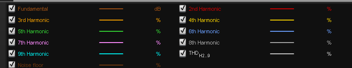

This is the legend for the graphs:Interesting... We don't have many posts about the distortion. Thank you

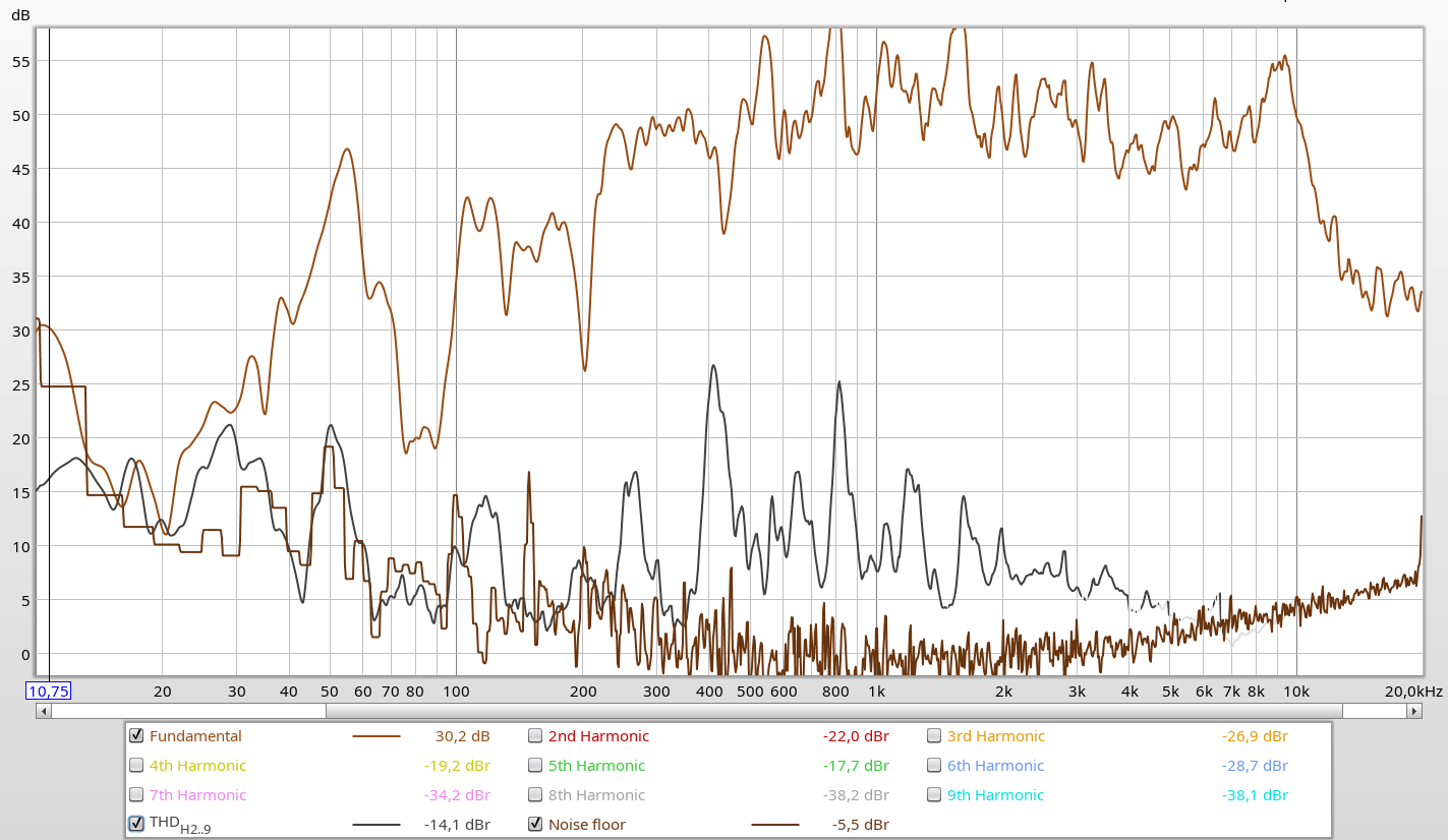

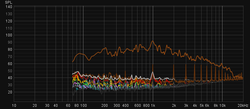

It just had a quick look on the FR and distortion of the small panel I am testing : the THD is mainly based on H2. Seems there are peaks locally with much higher level of distortion. To see if we could link that to modes.
May I suggest you have a look to the noise floor. The spikes each 1kHz are noise. Not sure they have an impact on the over all measures... nevertheless they have nothing to do here. Do you run the test with a laptop? If yes have look using it on the battery. It might be some noise from a switching power supply, an halogen floor lamp variator?
The spectrum below are not shown because relevant of a good panel or even a good measurement. It is just some tests on going to help in understanding DML, REW use and so one.
This leads me to think for next steps for material evaluation we might decide to get the distortion for a given SPL (70dBA?), and the spectral contamination at also a common level.
Here are FR (fundamental), THD (black) and noise floor (brown)
Here FR, H2 (red) and H3 (orange)

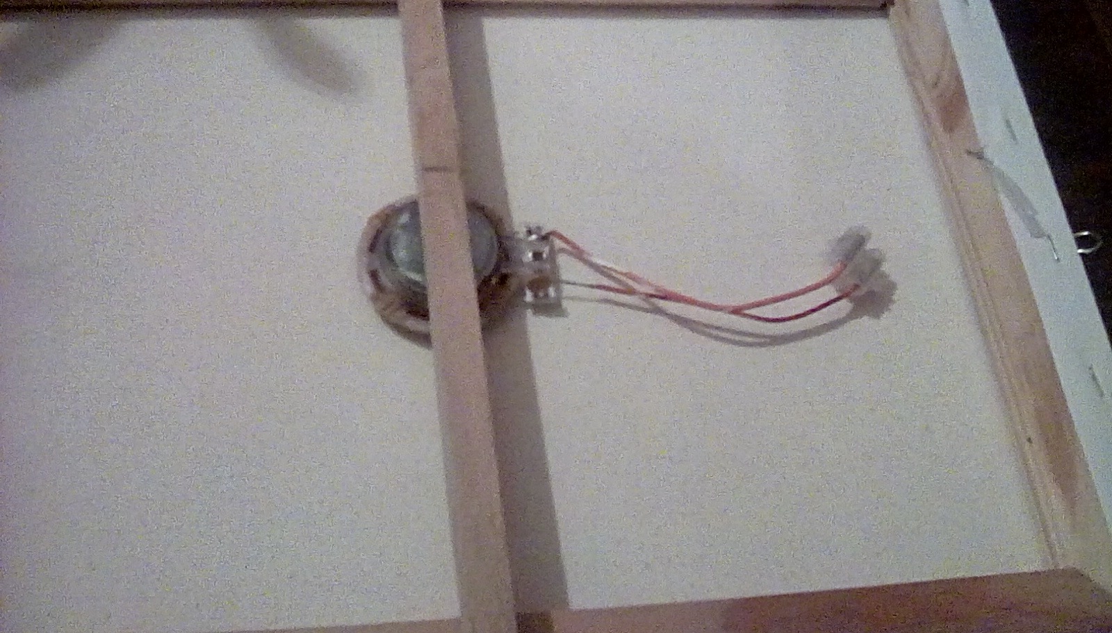

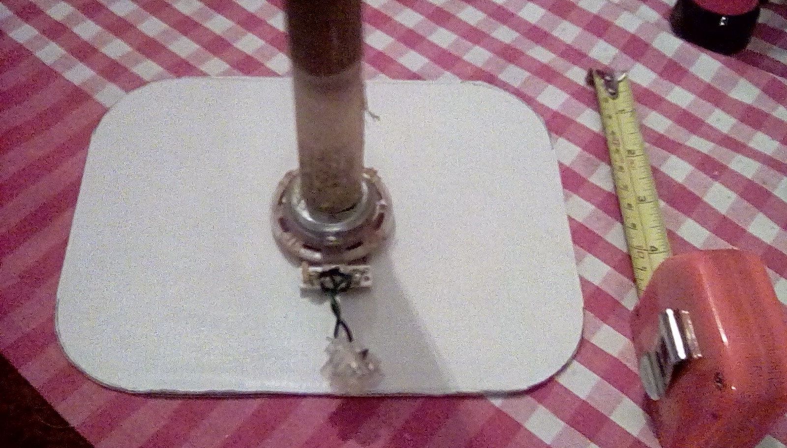

This bracing on an art panel is only 1cm by 2cm and does not badly affected the sound from the exciter and panel.
The other picture is of the sort of mounting I would use for my card or veneer panels, this would leave the dml panel totally free floating only supported by the coil spider.
This is a 25mm wood dowel ,this would be attached to whatever I chose to mount onto.
The card coated in epoxy only weighs 25g ,is balanced and puts very little strain on the exciter coil spider.
Steve.
