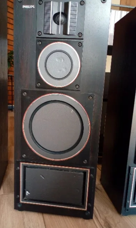

Around 40 years ago, very big audio companies (Akai, Aiwa, Philips, Technics, Sony) had done research and had presented the world with unique speakers. Some can be found in the 2nd hand market today. At that time bluetooth was not invented, but now it is the life.

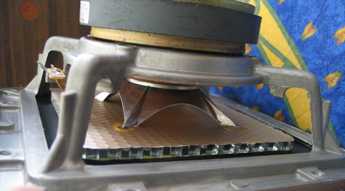

If anyone is interested in how a specialised speaker maker connected the aluminium honeycomb panel to the voice coil. This is one of the many such connections. Here, they had used an aluminium "cone." The honeycomb panel is suspended on a flexible surround. The "cone" is there to stiffen the 4 legs that transfer the vibrations to the flat composite panel.
On the other hand, on our "exciter," a small disk is connected to the coil.

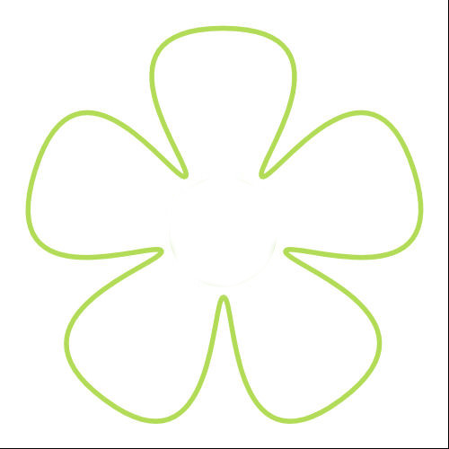

How about using 5 petal flower panel, the OP had done that with OB. With OB speakers, the baffle and any sides attached to it would also vibrate and give sound, even though the OB users won't speak about it. Most OB speakers have a large baffle, after all.

It's cool and all but at the end of the day it's an OB and not a DML. Now if it was a DML midrange with a center mounted tweeter it would belong in here. ��
For a DML, you can use a flower shaped disk/panel with the exciter on the back or front.
"The flower shape reduces edge diffraction effects."

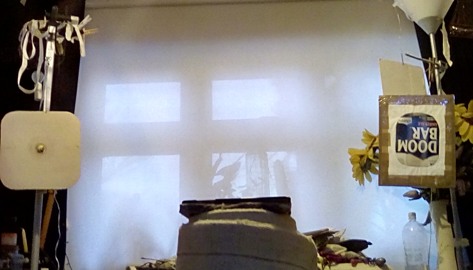

I gave up waiting for my recordings to upload from my phone ,so I thought I'd just show a picture of the recording in production, that is on my tablet.
The phone is just resting on a rolled up rug.
There are two recordings ,I might have to upload them one at a time?
Steve.
