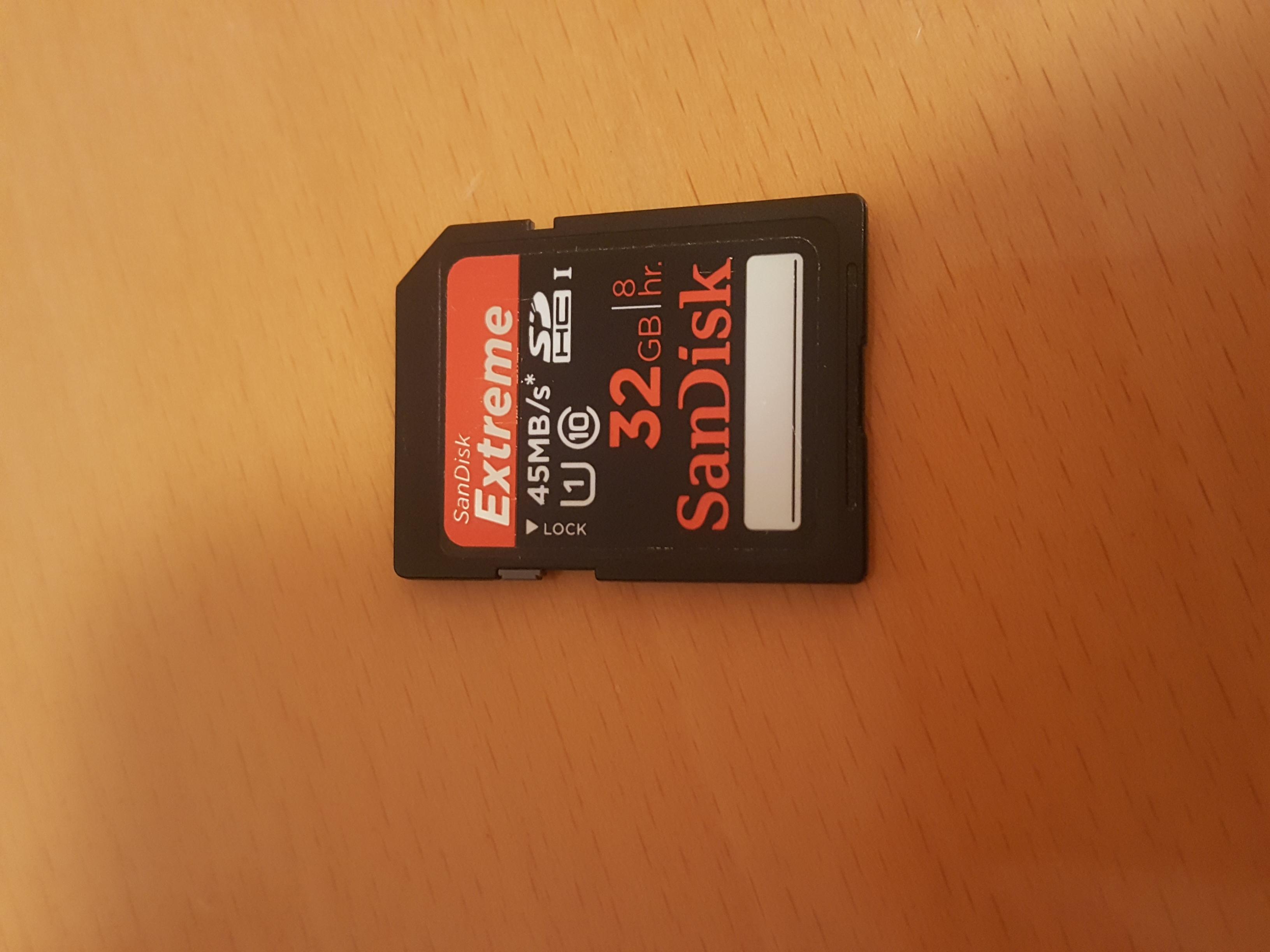

This is the picture of the SD card. I think it's fine and within those specs? 🙂
Yea that as card should be fine but have you tried another one, just in case? As I said I know of two with the exact same SD player that have no problems - one other possibility, there is mention of firmware update on some sites that sell this but no idea how you get the firmware or instructions on how to update? They seem to make a big deal about the card having the latest firmware so maybe your problem is the sump prom of the old firmware?

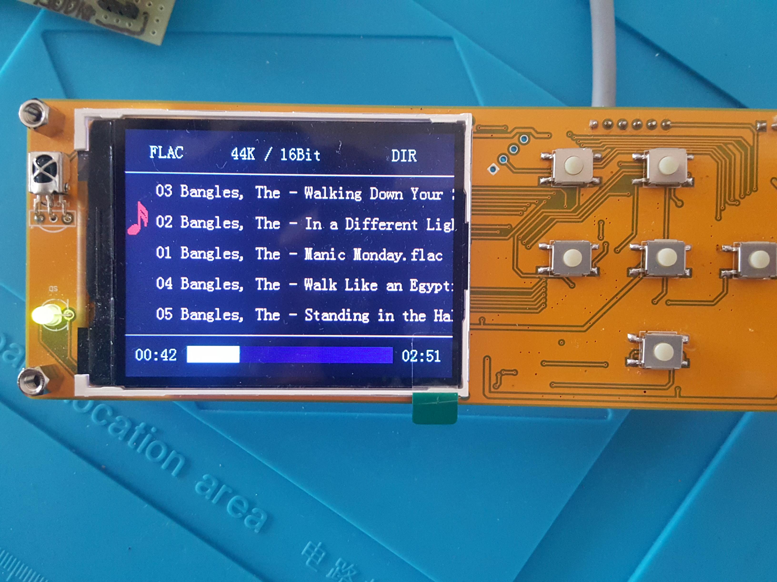

Hello!
just checked, yes it plays FLAC files as well (note photo). A few more notes..
The software is a bit buggy.
Please note (photo) that it does not order the songs correctly (just in FLAC).
The folder name appeared in chinese in previous screenshot.
Sometimes a song title is not displayed correctly (in WAV, but song plays okay).
No static burst in FLAC even though I used default settings (in dbpoweramp).

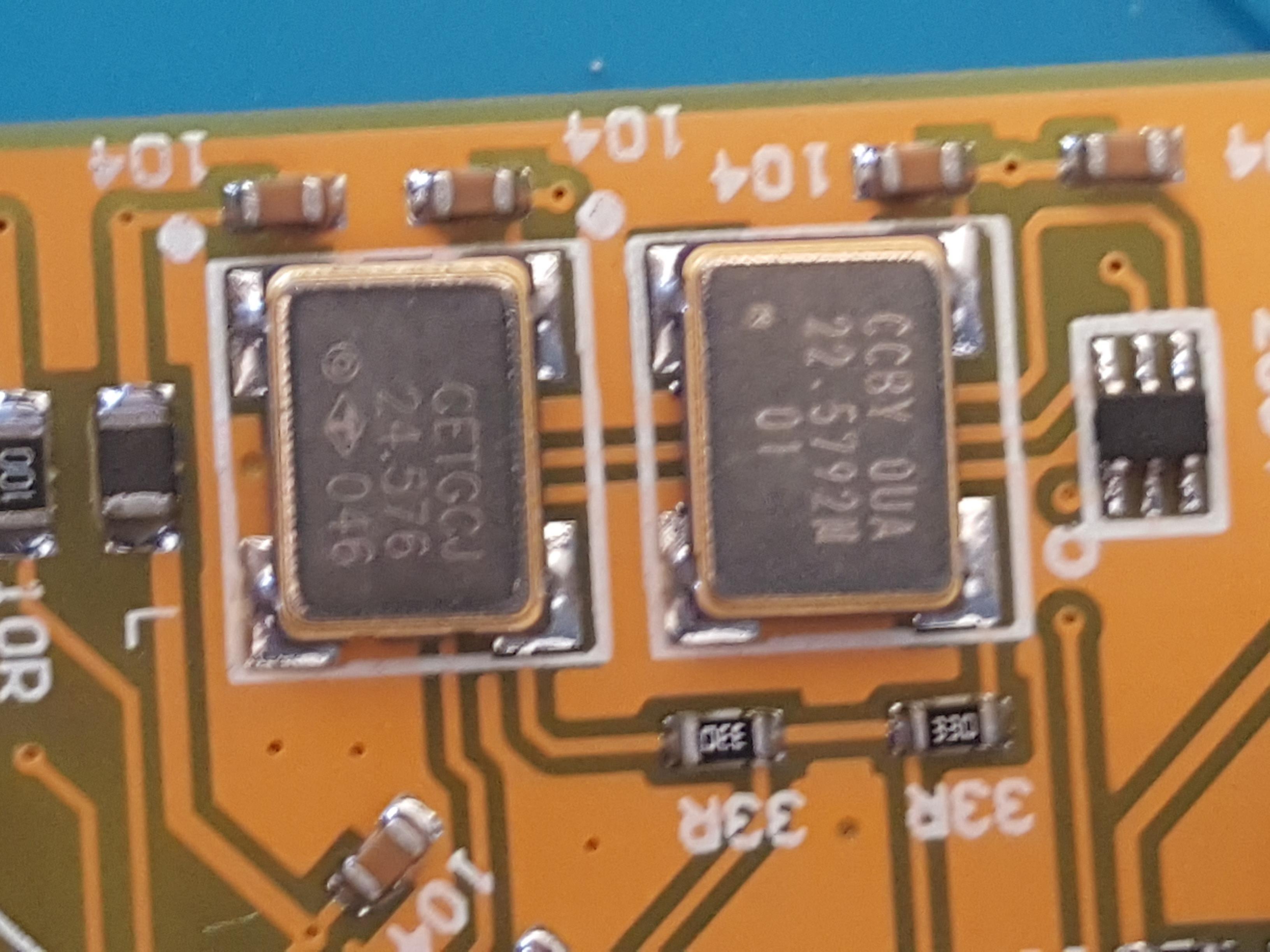

Player has two clocks for 44.1Khz and 48Khz (photo) .
( I wonder if you'll want to upgrade those. What I also have in my mind is placing a very good 44.1khz clock right next to the DAC and feeding the player with it 🙂 - losing 48k probably)

As far as the clocks are concerned - you need both clocks - the ARM processor uses one of these audio clocks as its system clock & switches between them depending on the samplerate of the audio file being played.
Why not use two 'good' audio clocks & Flip Flop to reclock the I2S stream just before DAC input. Feed the clock signals back to the correct on-board solder pads & also connect each clock enable signal from the correct solder pad to the correct clock.
In that picture - Bottom right corner pad of each osc is clock signal output
Top left corner pad is enable signal pad for each clock

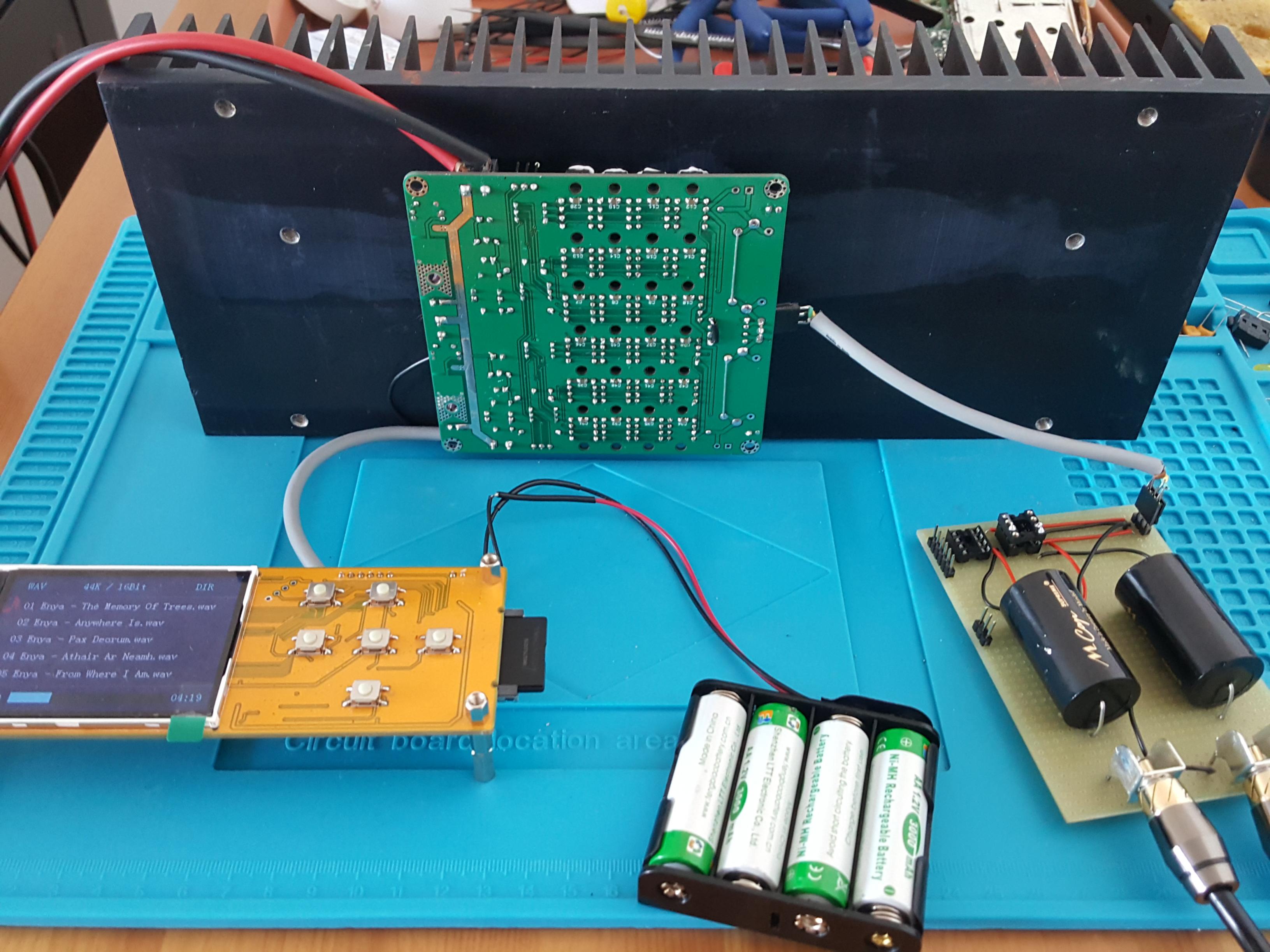

Anybody paralleling 24x @9V: this is the *required* heatsink.
Heatsink measured at +9 degrees C over room temperature 🙂

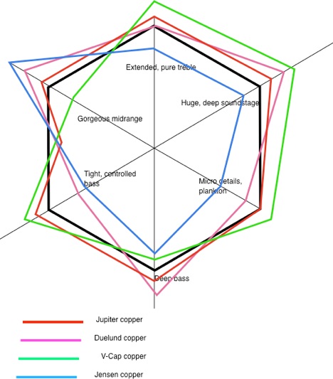

If you are focusing on bass, maybe you will also like this "capacitor map" that I found on lampizator.eu 's site.
