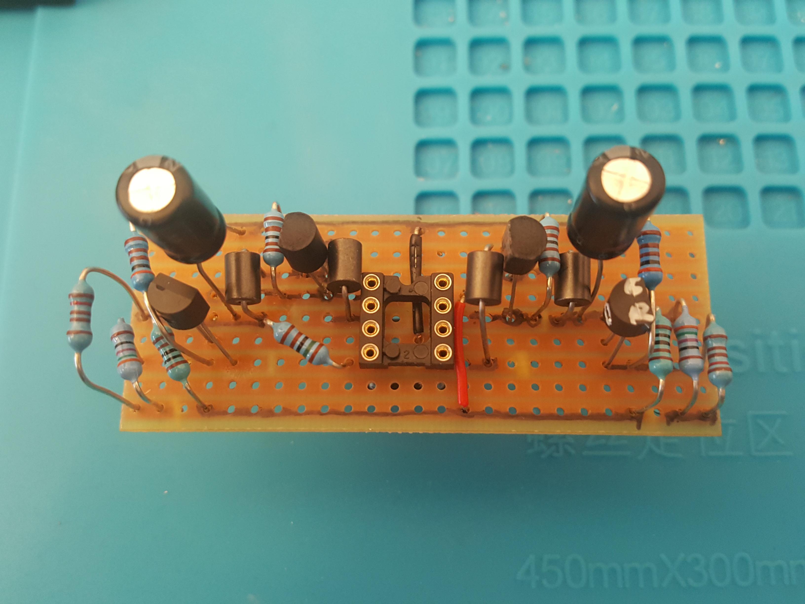

Hello Abraxalito,
I've built the circuit you suggested.
("Single PNP transistor in common-base mode. DAC output goes to emitter, I/V resistor between collector and 0V." for TDA1543)
It sounds divine !! Much better than the single TDA1543 or 24x TDA1543 with Output resistance to ground. Really appreciated the tip !
I'm only having this little trouble: It played fine for a few minutes, then there was a pop and it when virtually quiet. After testing for everything else I figured maybe there was trouble with the BC807. I replaced it and it played fine again! After a few mintes it went quiet again. 😀 (Attached are the components I'm using; After Ferrite Bead we have a healthy +3.79V)
What am I doing wrong ?

How are you generating the reference voltage to feed to the bases?
Its possible you've got oscillation - try putting 220ohm resistors between the Vref and the base of each transistor. I think my original schematic had a ferrite bead on the base but that's not enough to suppress oscillation in every condition.
Hello !
I am strictly following your schematic (+3.8V from TL431, and pulling the +6V from the power supply - the same one feeding the TDA1543)
http://www.diyaudio.com/forums/digi...elp-noob-building-9028-dac-2.html#post5256178
Yes! your original schematic has a ferrite bead on the base. I marked it red in my photo (too small?).
Ok I'll try the 220ohm asap ( and get some spare BC807s 🙂 )

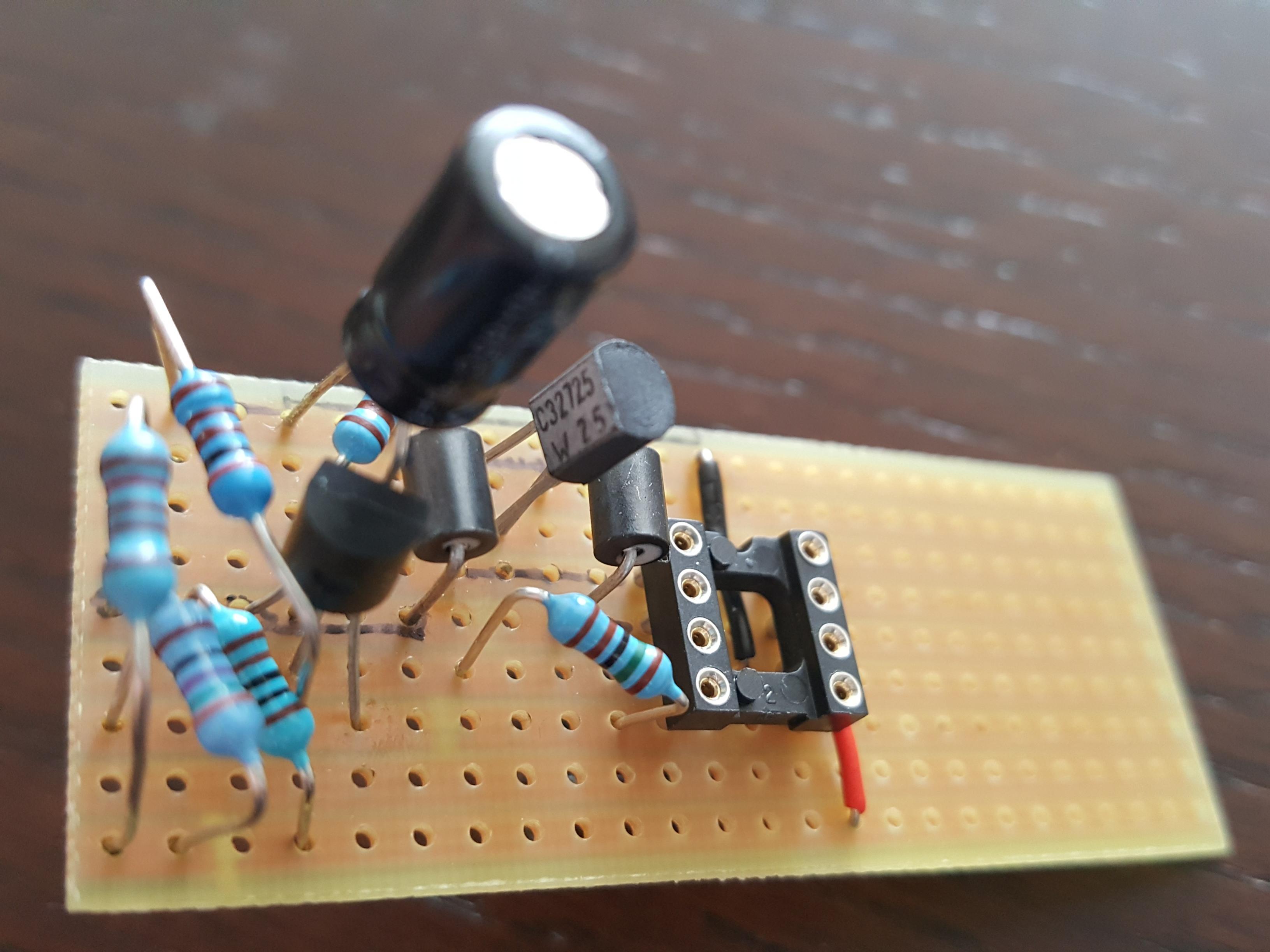

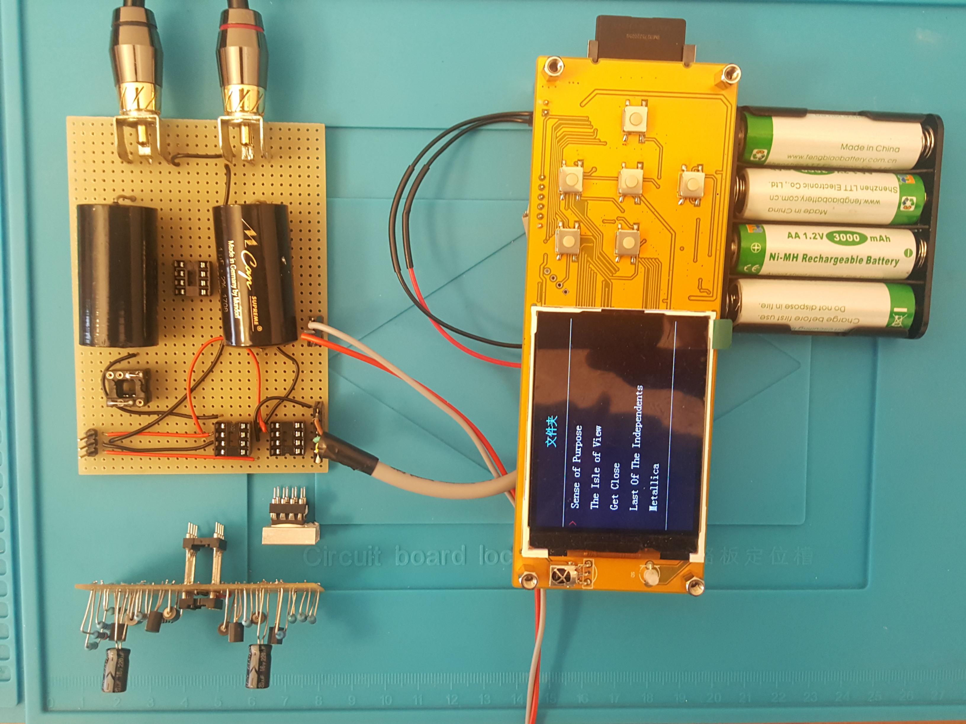

Ah OK, I got a bit confused because I wondered where the TL431 was. But now I see you've only built up one channel, the 'transistor' bottom left is actually the TL431 right?
Yes, bottom left is the TL431 !

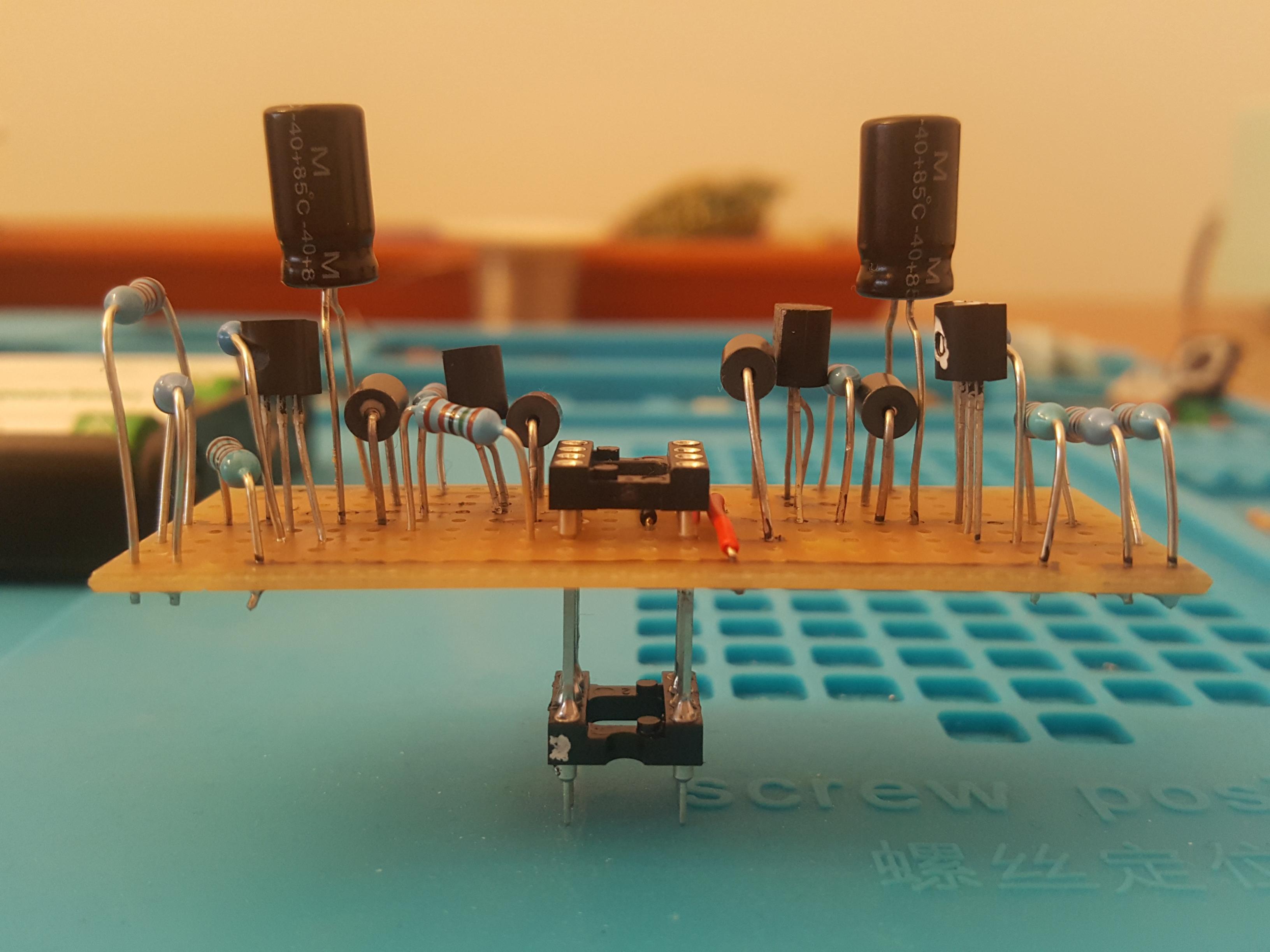

Meanwhile I've added the second channel (it's a bit neater) 🙂
Here's a few pictures of the complete setup, with "plug ins" next to their seat.
(the two extra 8 pin holders are for components that are not in use)
The TDA1543 is under the little alluminum heatsink. I use this board also for the 24x.
( Waiting to buy BC807s 😀 )

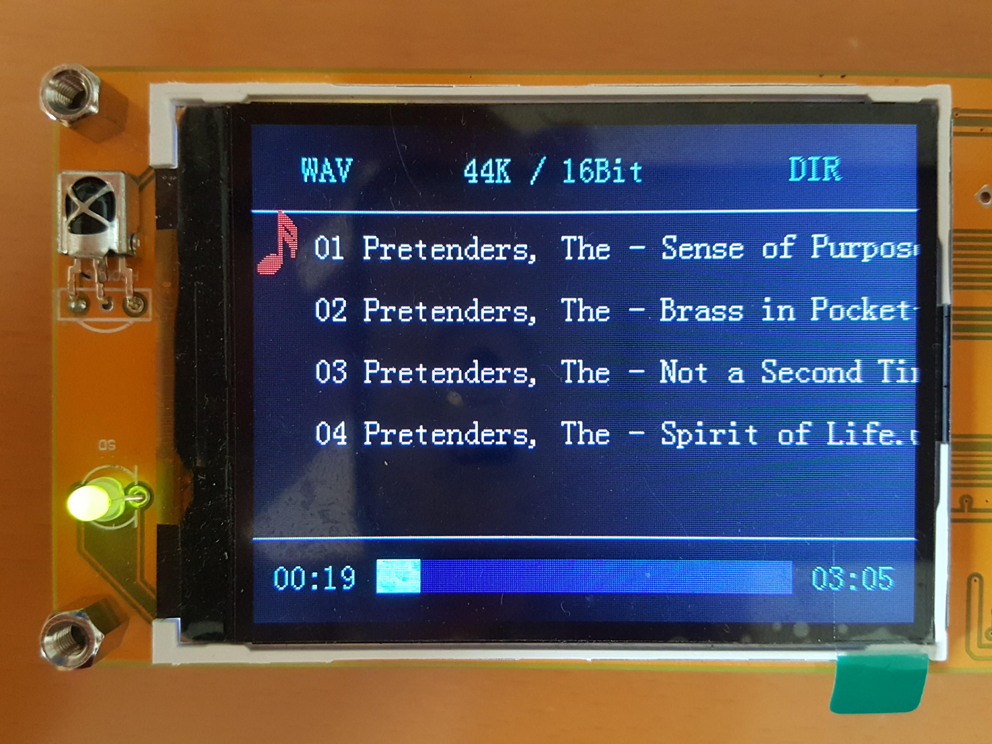

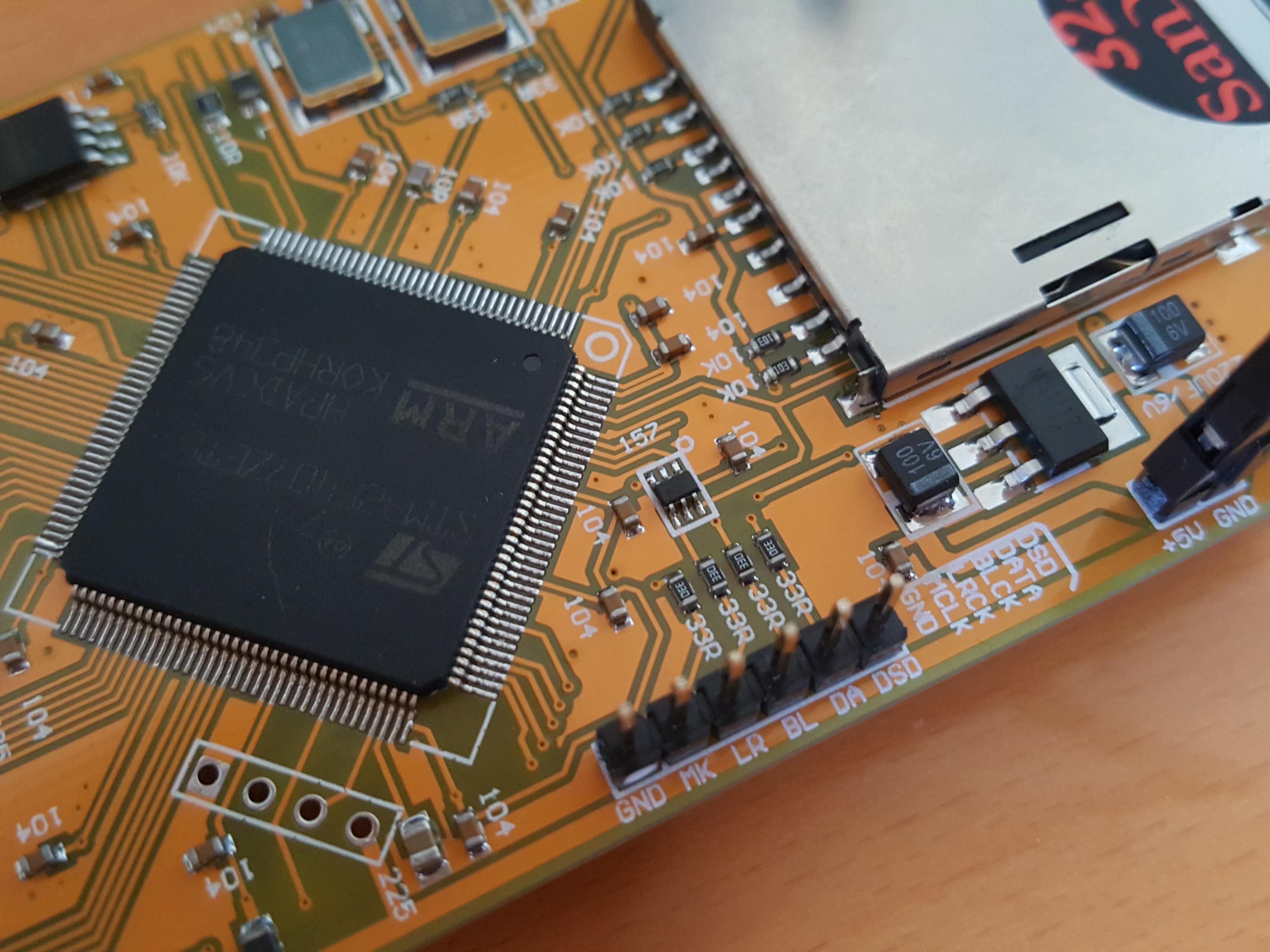

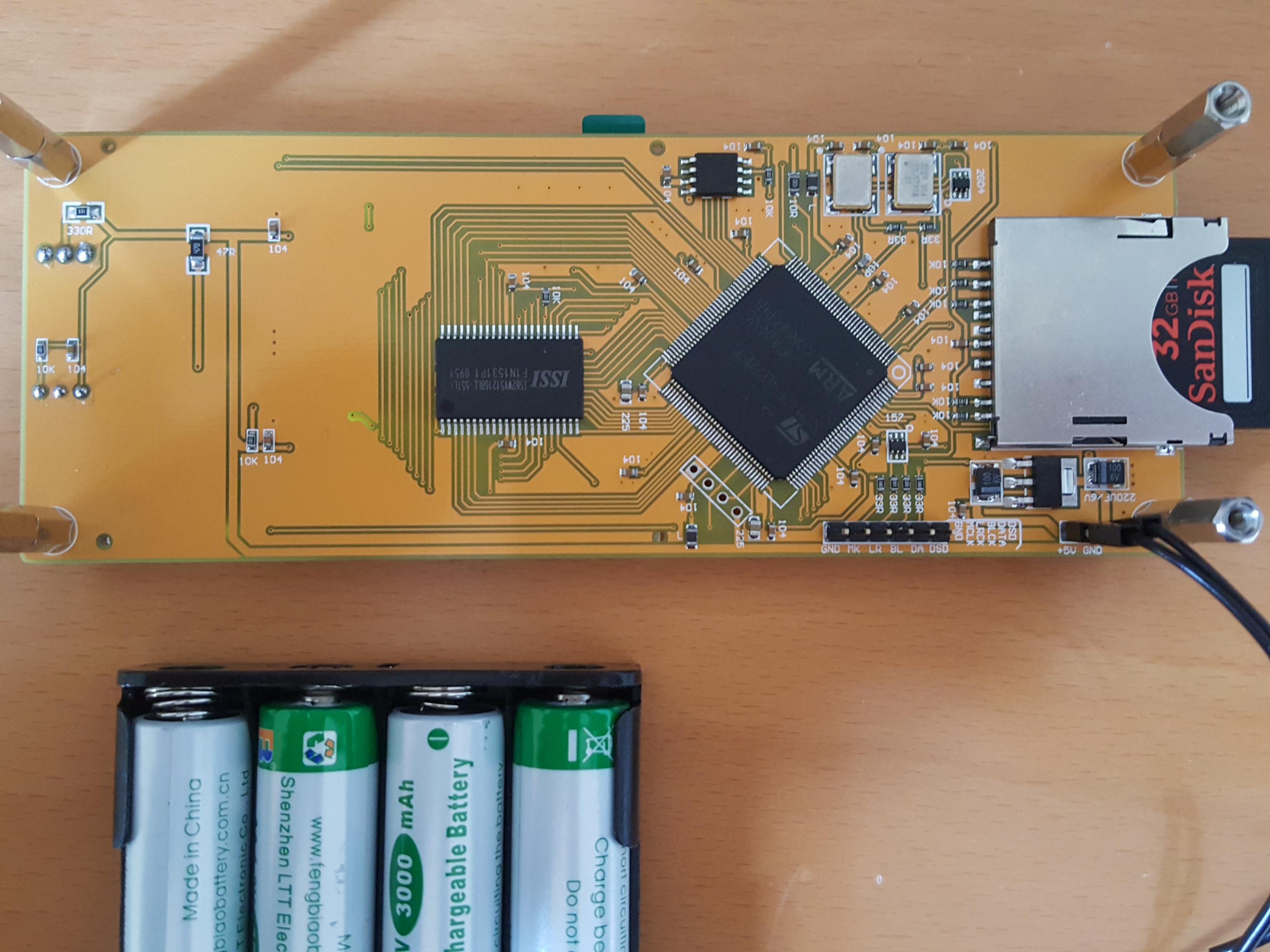

Interesting that you're using the same SD card player that I've had my eye on for a while. From 'College Audio Store' in Aliexpress?
Actually I bought it on ebay, but this is the one that is having static between tracks,
so I would not recommend it. I am actually looking into this one:
PJRC Store
It is 44.1Khz 16 bit, I2S ouput, can be slaved (!), and has a "play wav" library ready.
I'll write some code as soon as I get the screens.

Hello Abraxalito,
please correct me if have misunderstood you: I've added two 220ohms between Vref ( TDA1543's pin7 ) and each transistor's base (BC807), next to the ferrite bead.
Something is not right though: all is silent, the circuit's consumption (including the TDA1543) rises from 0.04A to 0.10A and the +3.8V at the (transistor's) base drops to 2.9V. If I remove the 2 resistances, it plays fine, but I keep it short not to burn the transistors again 😀

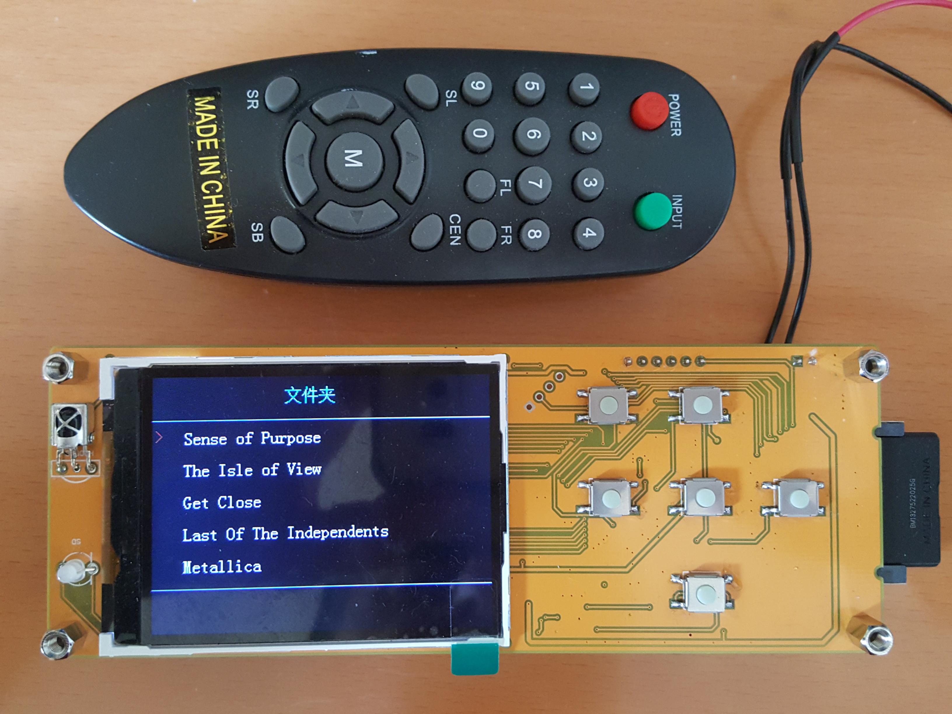

Ps here's the player if you want a closer look.
What SD card are you using with that SD player - I suspect that might be your problem - it requires a fast HC SD card
"Only supports a subdirectory, only supports 32GB of memory card (memory card must be CLASS6 and above, must be a HC card)."
I know 2 people who have this same SD player & no static although clicks & pops if a slow SD card i sused
Did you leave the ferrite bead in circuit? What my intention was for you to replace the ferrite with the 220R resistor. I can't see why adding the resistors in parallel with the bead would change anything at all. So you're right, something's definitely not right. Power consumption of 100mA is also not at all right. With the TL431 voltage dropping it tends to indicate you didn't connect the resistor in parallel with the bead, rather it went some place else...
BTW, Bart, do you have a link where you bought on ebay - I see it comes with remote control but I don't see that remote with any other offerings?
I just want to get the IR codes sent for each of the buttons: up, down, left, right & play/stop. You don;t happen to have an IR learning device, do you?
