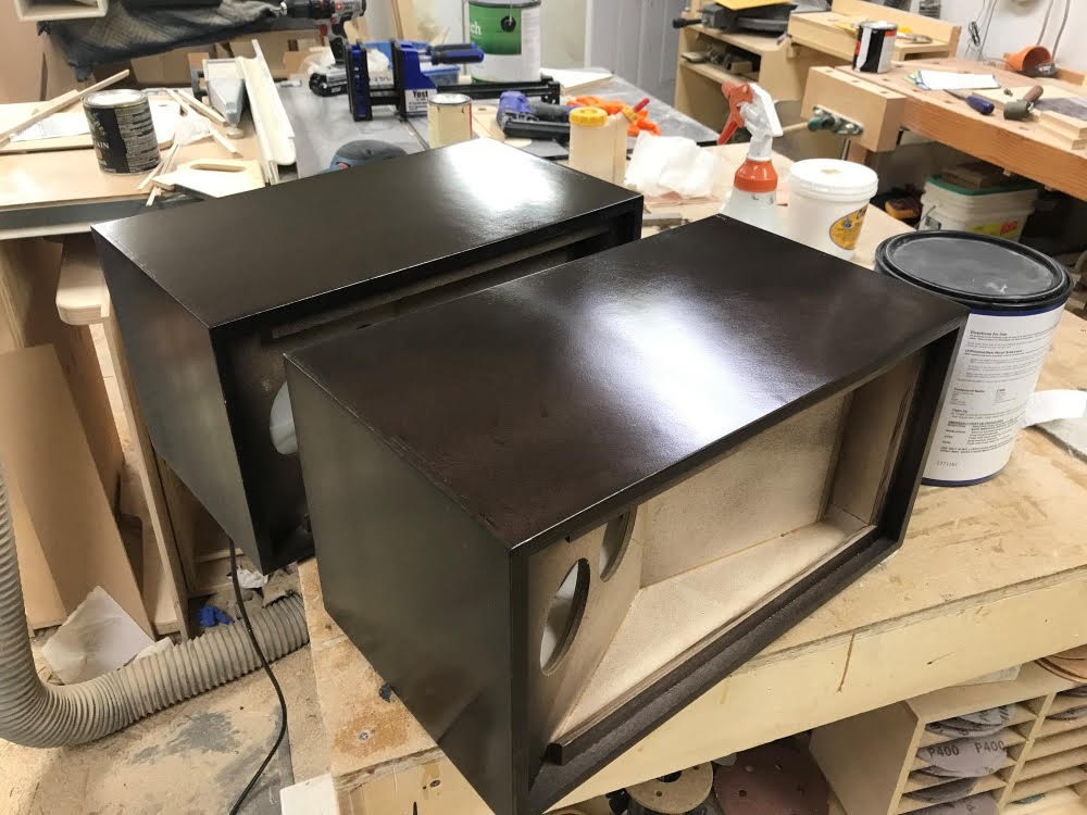

Hi Ripson,
You might want to post your question in the Karlsonator thread:
Mini Karlsonator (0.53X) with Dual TC9FDs
The 0.53x with dual 3FE25-16 that was made for me by Jhofland indeed had two long internal ledgers to hold the front aperture. I had another set made by my cabinet maker using the same plans and you can see the long ledgers here:
That’s 14 coats of hand rubbed lacquer (mixed with some stain to give it the espresso color).
https://www.diyaudio.com/forums/ful...onator-0-53x-dual-tc9fds-334.html#post5832154
