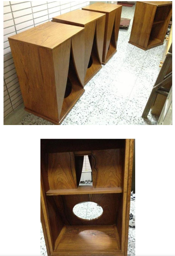

There is a market for old style K15’s in Taiwan?
That pricing is aimed at audiophiles with bank. The cabinets do look beautiful though - are they veneered or is that solid cherry or walnut? In which case, the price may not be unreasonable as it is like furniture.
