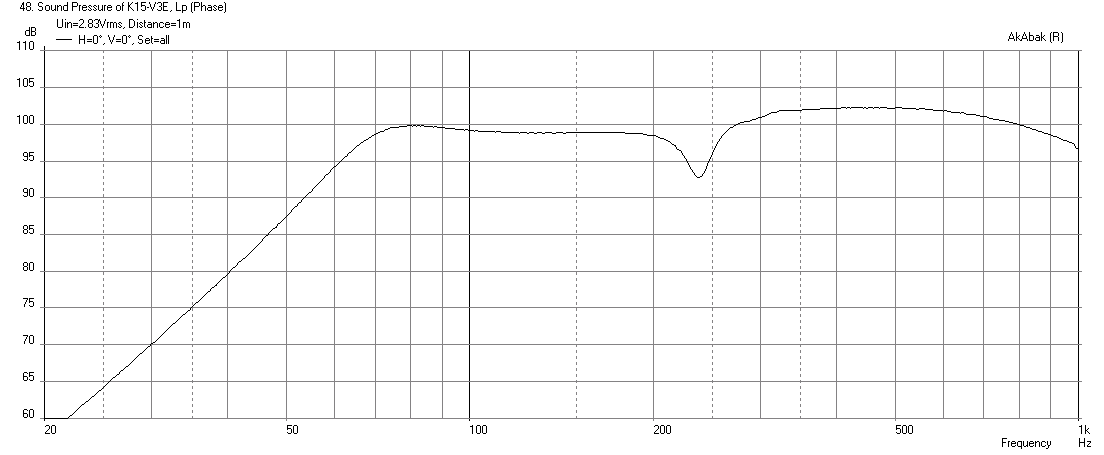

hi xrk971 - - do you have any further thoughts as to which 6.5" might work well in the 0.35X K15? If the vent is blocked, would response (assuming the driver's TS allowed ~flat response with a sealed back chamber) remain reasonably smooth ? - or might it depend upon backwave fill thought the vent? proportion-wise, a 6.5" speaker in a 0.35 size is like an 18" in K15.
hey xrk971 - - lets say I want to reduce my 0.62 x K15 for a 10 to a somewhat smaller size and not lose significant performance - can the baffle angle be pulled up to reduce front chamber size and a bit cut "here and there" in overall dimensions and come up with a very good and punchy "K10" ? - the goal is to get a powerful "hit" in the smallest box, retain good dispersion and sound quality. Seems like a 10" is just about the smallest size speaker which can play decently loud midbass with acceptable excursion levels.
Freddi,
It's doable what you suggest but I am not sure reducing front chamber matters that much. I am guessing that the bass will go to about 90Hz in the scale you suggest. Is that good enough? If you need more maybe an XKi for a 10in driver?
60-70Hz pretty solid would be great - if it doesn't overly compromise power handling - low enough cutoff to give kick drum and lower tom drums a good representation. Kappa12a is good as I have those unused plus its close cousin pym1298. We know from sim that a 0.8 K15 should be pretty good with Kappa12. I like the 10" size a lot as know it can play well but Delta10a has quite a peak - guess a proper xover should take care of its audibility. I have one new spec Eminence B102 - not real hot in the mids, 2-Beyma 10G200 never loaded and going to waste. The new XKi would go up against a 12" folded midbass horn and would be nice for the little K to hit ~120dB up close.
Freddi,

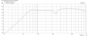

I actually ran a sim of the Kappa 12A for you way back when - I found the sim results on my hard drive. Anyhow, I did re-run it given the request for max punch and 60-70Hz reach. If you just put it in a standard K12, it would be quite happy and get you 97dB bass level with -3dB at 48Hz. However, if you scaled the box by 0.67x in height and depth but by 0.80x in width you get something perhaps closer to what you are looking for with about 99dB and f3 of 63Hz:

Well, that's how the model sees it. It's really about volumes for the chambers and not "height" for a K15 as it operates as a 6th (sometimes 8th) order series band pass. So, I squashed the height to reduce the volume. If one wanted to keep the height so it looks normal, I suppose you can reduce front to back depth, but that is hard to put in my model.
For the Karlsonator, it is a TL, so length makes a difference.

here's X's prediction of Kappa12a in a 0.8 scale K15 - I'd be happy if it could reach F3 ~60-65Hz
It makes a difference if the aperture comes to a narrow cusp vs a slot. Wider aperture pushes it up to 100 Hz.
