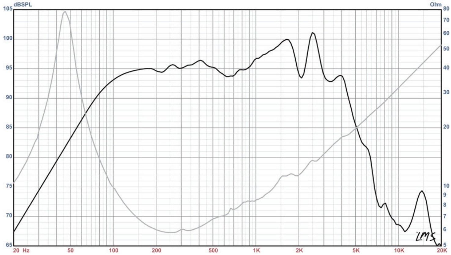

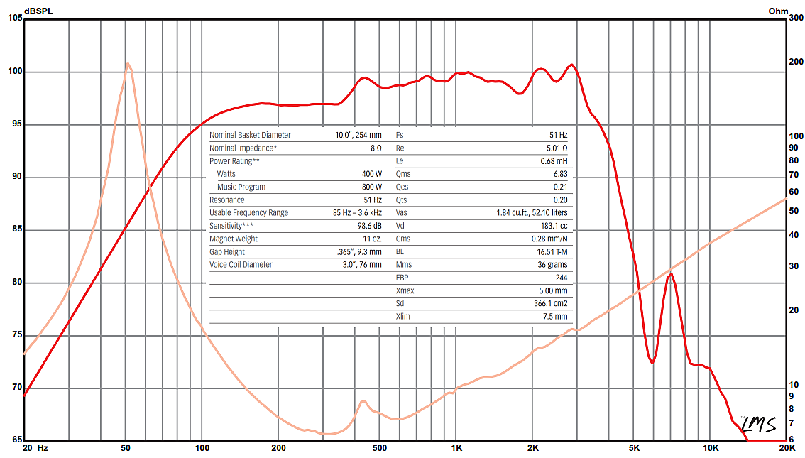

for a traditional K using a 10 - which of these woofers looks most appropriate ? - are they all too strong to get a solid 70-80Hz? - are there choices with better subjective midrange and lower treble?
10FW65
10HPL64
3010HO
10FW65
10HPL64
3010HO
Basslite S2010 worth considering... Under $90

3010MB does look very nice (and you did a nicer job of putting its parameters into the graph)
Delta10A is a strong driver but sometimes I wonder if its peak won't contribute coloration even with the lowpass flattening response (?) - with pink noise and the driver in free air, that peak sounds horrific. Is it mainly a function of the 10" size and cone geometry? The new B102 could be used but its sensitivity is less than the original B102 - perhaps that could be a plus in a small (~0.55-0.58 X K15) K-coupler in a small room
