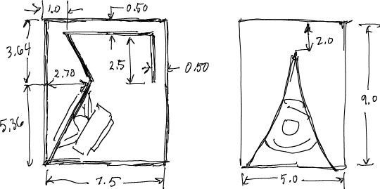

Carl's klam10 for Eminence B102, Beta10cx, etc. - a great size
rough description of Carl's klam 10 dimensions - these need to be double checked
you want the radial arc aperture to open up near full width - my previous builder went by a dimension
and the aperture ended up too choked

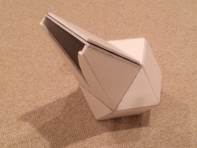

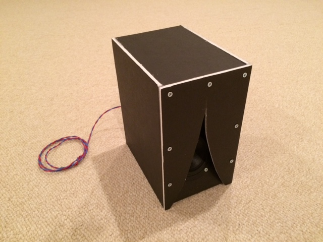

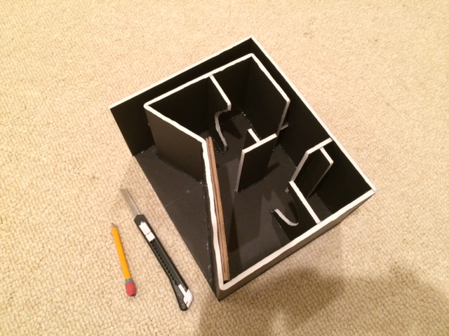

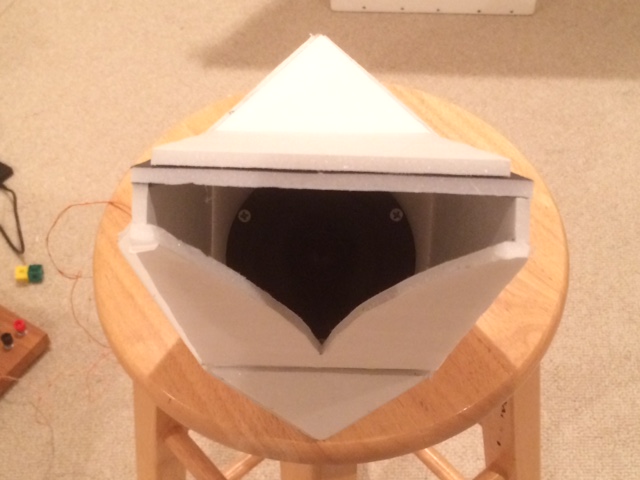

Ok Freddi, I built a foam core Klam!
To save time, I tacked it onto an existing Hypercube for the rear sealed chamber. I sort of guessed dimensions and set it based on the Hypercube edge face which is 4.75in wide. So the Klam is 4.75in wide x 4.75in tall x 8.5in long. There is a 0.5in gap at the end of the Klam where the opening is widest. I used CLD on the main flat panel to reduce vibrations and harmonic distortion. I hot melt glued the Klam onto the Hypercube.
Here are some photos of the little Klam, ain't it cute?

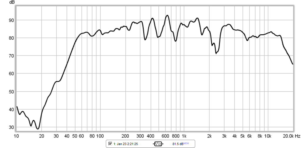

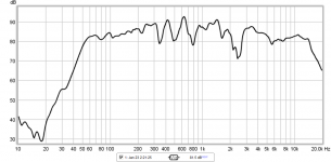

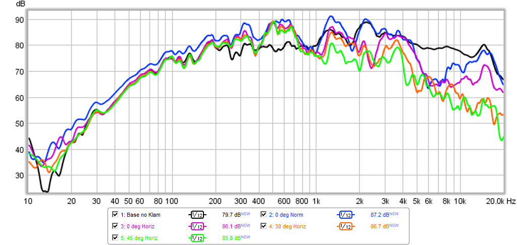

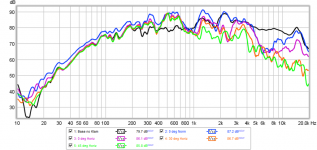

Here are the measurements at various angles with the baseline being the bare RS100-4 at 0 deg. The driver aims up on the Hypercube so once I put the Klam on, I tried a measurement of the mic normal to the driver at same position before I glued the Klam on, and also 0.5m away from the Klam aperture and horizontal. It does add to the midrange, but is peaky (typical of a horn that is not well impedance matched), and falls off steeply after 5kHz:

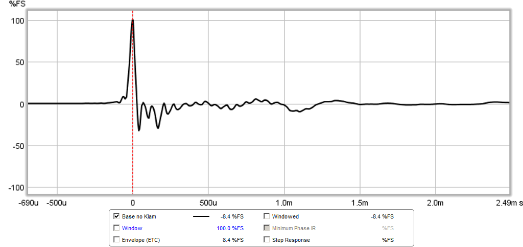

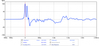

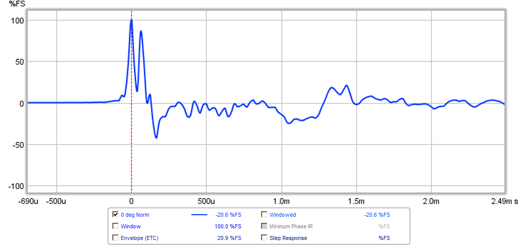

Here is the impulse of the bare RS100-4 in the Hypercube:
Here is the impulse at normal to driver with the Klam in place:

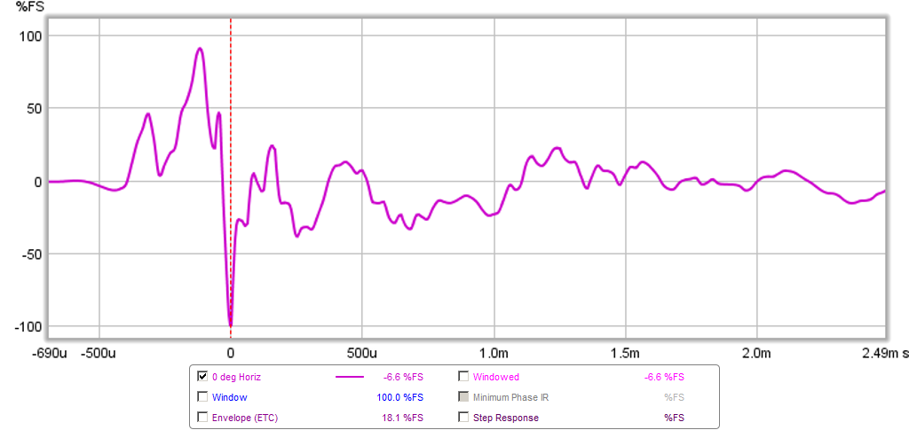

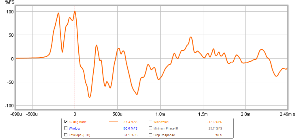

If I move to horizontal, the impulse is a total mess, full of reverberations and echos, delays. This is not the speaker for clean transients:
I listened to it and just too much coloration and transient smear - don't like it. Sorry but the Klam is not for me...

I converted these volumes and vent dimensions into a box that has internal dimensions of 5in wide x 9.0in tall x 7.5in deep which then provides the correct volumes once the vent volume and driver volumes are subtracted. The front K-aperture is sized to have the same cross sectional area as a 5in dia hole, which was approximated by the area of a triangle that is 5in wide x 7in high, accounting for the curvature and offsets near the bottom.
The box design looks like this:
Here is a photo of the inside during construction showing the bracing and folded vent arrangement leading to the top of the front chamber:
Here is the completed speaker - still retains the look of a very small K15:
And here is the measured frequency response about 0.5m away along the axis of the driver centerline - it has the characteristic Karlson "W" dips and a falloff near the bandpass followed by the direct radiator output which lets it reach up to the HF limit of the driver (about 14kHz in this case). The measured f3 is 51Hz! An amazing concept for anyone who has ever tried to scale a K15 down will realize. Predicted max SPL at 4mm xmax is 98dB in 2pi space:
How does it sound? I got to listen to 1 minute of 1 test track and it sounds very nice. Did not audibly notice the dips. Dispersion was very good and transients were clean (the impulse response was clean and I will show that later). So I think I have finally cracked to code on how to make a very small "Karlson" that has good bass extension and transient dynamics. At 5in wide x 9in tall x 7.5in deep, it is a pretty small speaker - suitable for desktop or bookshelf use. With an f3 of 51Hz, it is pretty impressive.

As a test case, I designed a box that can reach 50Hz using a nominal 3.5in driver - the Dayton RS100P-4 (paper cone). This driver has a suitable moderate Qts to allow fb to set below fs and has good xmax of 4mm and a relatively powerful motor. The 6th order bandpass design was a 4.0 liter rear chamber and 1.0 liter front chamber with a 0.5in x 5.0in x 9.0in long vent, and a front chamber vent consisting of a 5in dia aperture.
Now, the neat thing about this methodology is that if a 3.5in driver can hit 51Hz, a 6.5in or 8in can probably do 40Hz. This can also be used for a sub woofer with a good pro audio 12in driver like the Faital Pro 12HP1030 and achieve 120dB SPL and mid 30Hz...
