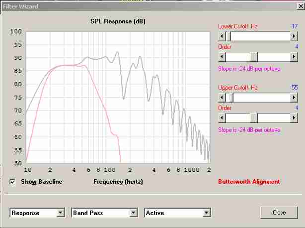

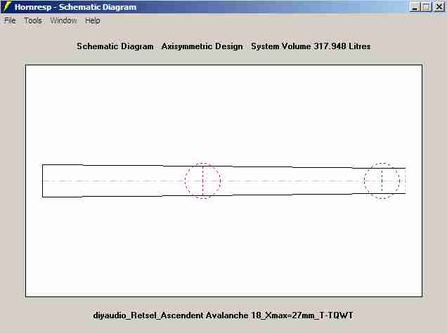

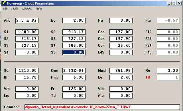

Hi Y'all,
I would take a look at bjorno's T-TQWT. I'll attach a starter Hornresp simulation, you can take it lower, higher.... And, it's not very big for a driver of this class.
It would be nice to have measured T/S parameters.

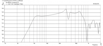

Hello all,
A friend of mine (cellist) asked me to put together a speaker for an electric piano he sometimes uses as accompaniment. This electric piano playing its own speakers sounds distorted and small paired with the cello.
Do you think a Karlson+12LTA can do the job?. And what's the best for 12LTA, K12 or K15?. How much power can handle?
The music hall is small, max 150 people.
Hello all,

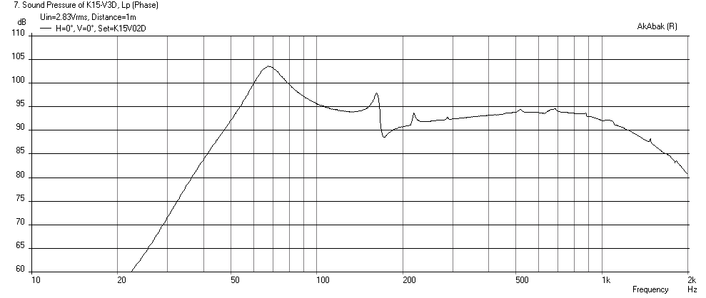

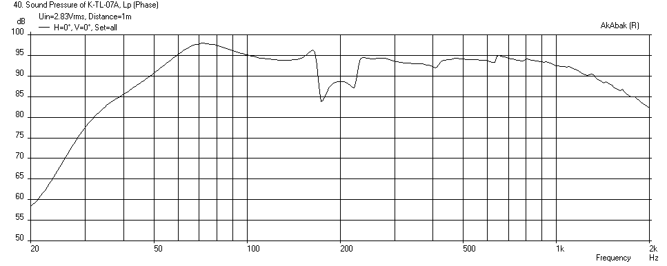

Vittorio,
The Beta12LTA doesn't work so well in a Karlson K15 (multi-chambered bandpass style). However, it seems to look pretty good in a full size Karlsonator.
Freq Response simulations for: K15, Karlsonator
I would think K15 would work with 12LTA. 12LTA is a low power wideband with high sensitivity - probably as the coil winding depth is only 0.08" more than its gap height. You should probably add a K-tube tweeter but I'm not sure how much treble power and extension is needed for cello reproduction.
I think 12LTA would probably hold up if things aren't too loud. K12 would be a lot nicer to carry than K12. K12 could also be vented with a single vent or two instead of the distributed slits.

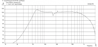

K15 with Kilomax 15 Driver
I was getting some questions about the K15 proper over in the mini Karlsonator thread and thought that redirecting some of the questions here would be better to stay on topic.
Here is the post from the mini Karlsonator thread and answer:
http://www.diyaudio.com/forums/full-range/239338-mini-karlsonator-0-53x-dual-tc9fds-49.html#post3845405
http://www.diyaudio.com/forums/full-range/239338-mini-karlsonator-0-53x-dual-tc9fds-49.html#post3845662

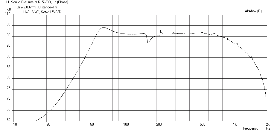

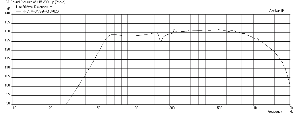

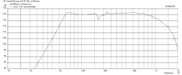

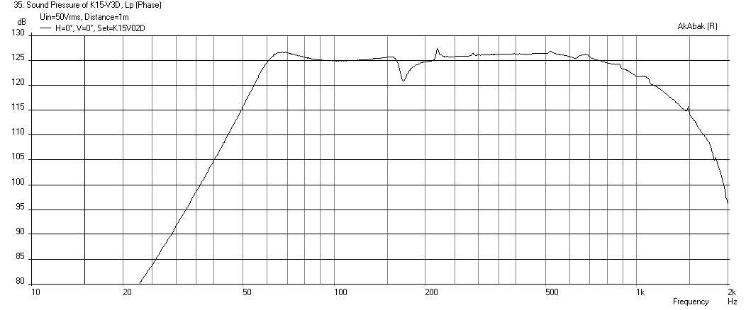

After seeing how good the Kilomax 15 looks in the K15 at 2.83 volts I decided to push it to xmax to see what this speaker can really do in a large space.
Adding a 3rd order high pass filter at 35 Hz to keep the low frequency excursions under control, it took 50 volts to make the Kilomax 15 hit its xmax of 8 mm (near 35 Hz). Xmechanical is another thing though...
The K15 can belt out a 125 dB SPL from 56 Hz to 935 Hz (-3 dB points) at 1 meter with 50 volts rms. That is about 312 watts - still far below the 1250 watt rating so power compression should not be an issue.
Here are the SPL vs Freq for 2.83 volts and 50 volts at 1 meter.

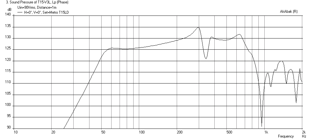

OK, -48dB/oct at 19 Hz HPF applied, now lets us crank the drive voltage up 90 volts rms. True to the Kilomax namesake, 1 kW of drive power get us an average 127 dB with -3dB points at 57 Hz and 1.14 kHz. Ear bleed levels I believe
