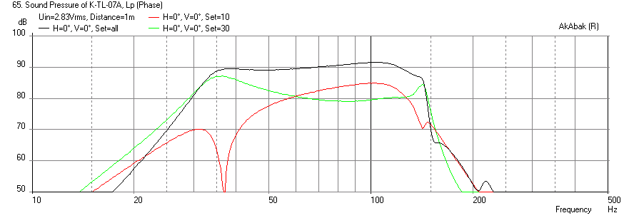

Yes, as I showed in a sim, a scaled up Karlsonator can make a nice sub. This one is 34 in long x 7 in wide and uses a couple of 5.25 inch drivers. Reaches 35 hz flat - really close to a tapped horn. This actually does not use the K aperture - just a rectangular opening.

I have to say I disagree. There's a lot of stuff in the original patents that doesn't hold up to modern scrutiny. If scaling, I'd stretch the height, but determine the width and depth to based air volume requirements for the driver.
Before making huge investments in time and materials, consider making some computer simulations.
If it were me, I would run those Avalanche drivers in 1.5+ scaled Karlsonators. They'd be about 16 cu feet each. Of course, I am very biased towards this design. 😉

I was actually suggesting ~1.5 scaled Karlsonators, which is not technically a Karlson, but a modern design with a different rear loading. Yes, I was suggesting to take the Karlsonator, and scale all dimensions by 1.5 or slightly more.
Considering the expense in time and materials, it will worth your time to do a simulation. For your purposes, the Karlson exit shape could be ignored, and the boxes modeled as tapped horns in hornresp or whatever.
If you wanted to scale the 'traditional' Karlson K15 to work in sub bass, I'll stick to my recommendation to stretch vertically by 3x or more. Alternatively, you could tune one low and EQ the hell out of it like Exemplar. It won't go as low as your desired BW though, unless you scale the whole thing up drastically. IIRC Exemplar used them to supplement approximately 100hz midbass horns - totally different requirements.
