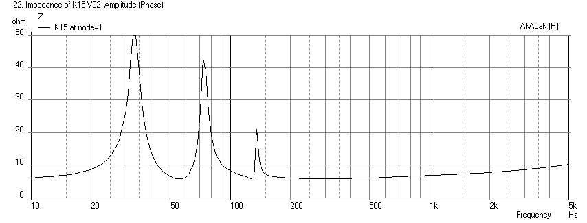

So, there's a 2nd tuning frequency around 160 Hz or so?

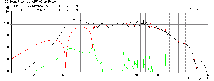

What causes the drop in response past 1 KHz?

in practice there's no HF rolloff - they work very well with coaxial and fullrange. I'd like to know why I've seen a ~36Hz null with a nearfield mic at the center or bottom of the cone - K15 seems to handle more power at 36 than a reflex = to its back chamber volume and same apparent tuning.

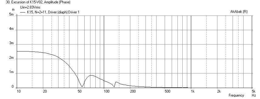

the nearcone null seems to come in around 1/2 octave below fb -- there is legend that K's damp cone excursion below cutoff

You are welcome. The second cone motion null circa 160 Hz is consistent with observations according to IG81. I believe it is similar to the double tuning you get in a dual chamber reflex. There are really three chambers here, the front being open with the K aperture. If you are interested in the model, the details of how I did it in Akabak are in the Karlson thread here http://www.diyaudio.com/forums/full-range/213594-karlson-10.html#post3528706 The response past 1 kHz falls of due to the bandpass nature of the K15 - it really is a hybrid big vent reflex with a dual chamber reflex in the back, with some tapped horn action going on on too. However, in reality, a lot of direct radiation from the front of the cone makes it out past the K aperture, so if you are using a smaller dia full range, you will still get pretty good highs. The natural falloff of the Delta Pro 15A is around 2 kHz anyway so this really needs a CD and K tube to fill out the top end.

Thanks for posting all those impedance curves. That really helps to show that my model is indeed capturing the essence of the K15. Especially the reconed EV in K15 w 30.5 sq in vent. The freqs of the three peaks is almost right on.

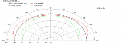

It turns out that your dusty old Beta 12CX with the mis-spec'd Qts appears to really do well in a K15 scaled up just a bit is size to 1.27X (19/15). It rocks with a 100 dB sensitivity and nice even response. Check out the sims, all with speaker 60 in away from back wall and measurements at 1 m with 1 watt input.
- Freq response at 1m
- Impedance
- Cone Displacement
- Impulse Response
- Freq response at 5m
- Polar plot of directivity for 60 Hz, 500 Hz, 1000 Hz at 1m
This driver looks like it was made for the K15 scaled up - very nice set of plots.
This thing will tear your face off with 50 watts input. 🙂
