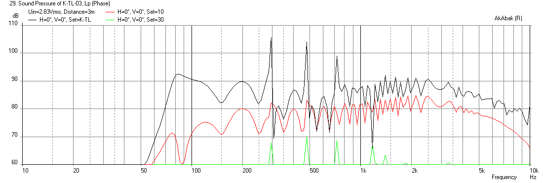

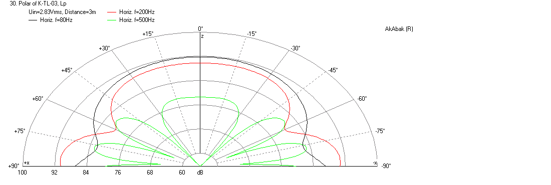

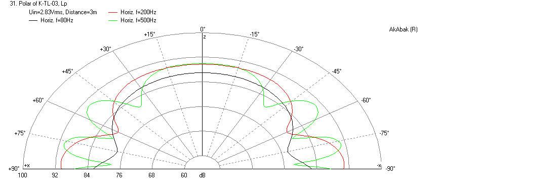

Comparison of With/Without K-aperture on Directivity
In the Mini Karlsonator thread, I was asked to see if changing the K-aperture would affect the resonance bumps in the frequency response - it doesn't. But after I went into the model to modify the K-slot, I realized that this was something I had not played around with yet. Since the K-aperture was defined mathematically as a normalized function (ranges from 0 to 1), all I had to do was to zero out the first two coeficients and set the constant to 1 to simulate the effect of not having a K-aperture. Basically it makes it vent duct on the front waveguide the width of the cabinet (which is the same as not having anything there). Anyhow, the effect of this on the frequency response was minor, as expected, the bass extension decreased because of less mass loading and a shorter effective waveguide - see the first plot. If I put the K-aperture back in, the response pulls the bass down to 70 Hz vs 80 Hz. These sims are for the dual Vifa drivers in the 0.53X scale Karlsonator with the wall 60 inches away and the measurement at 3 m away. As you can see, with 2.83V into 4 ohms (2 watts) the SPL is pretty good for a couple of 3.5 in drivers - and it throws the nice bass shelf out to 3 m no problem.
Next, if we look at the spatial directivity of the sound without and with the K-aperture, it tells a very interesting story. The third figure shows the polar plot of the SPL at 3 meters for 80 Hz, 200 Hz, and 500 Hz without the K-aperture. Below 200 Hz, it is fine, but at 500 Hz the SPL is down kind of low and there is substantial lobing, and you can see the very narrow sweet spot. The fourth figure is the polar plot for the case with the K-aperture put back in. The result at 500 Hz is staggering in its effect! The sweet spot is substantially enlarged, the depth of the lobes is minimized, and it shows why I thought that the sound from speaker sounded almost as good when standing almost 90 deg to the side.
Anyhow, more data as to why the Karlson aperture makes a nice speaker.

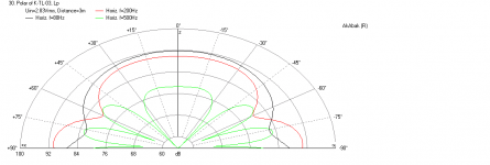

In case you have not seen this in the Karsonator thread, here are some directivity measurements and they show why the Karlson sounds good in a large space - very uniform directivity up to about 3 kHz (for vocals) and a 100 to 120 deg wide cone that is lobe-free.

here are some directivity measurements and they show why the Karlson sounds good in a large space - very uniform directivity up to about 3 kHz (for vocals) and a 100 to 120 deg wide cone that is lobe-free[/IMG]

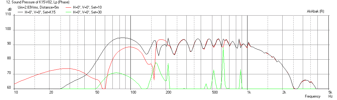

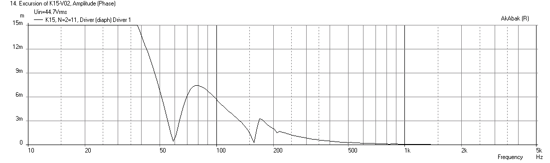

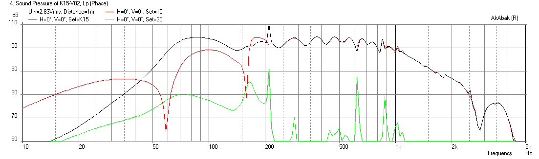

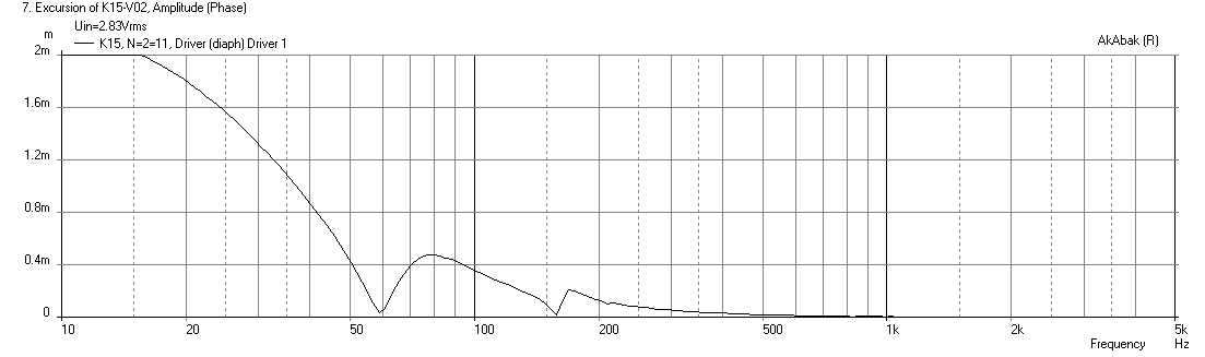

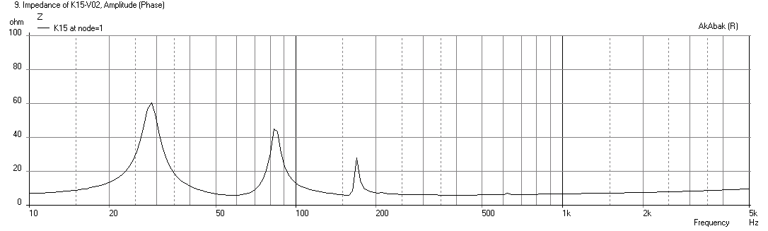

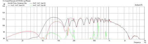

I have sim'd the Kappa 15A but not delta. I will post sims as soon as I have some time. One very nice feature about the K15 is that there is very little cone movement so that you really have a very high SPL system that won't be as limited by xmax like other alignments. It's interesting but in some cases the smaller Beta 10cx outperforms the larger 12 and 15 Kappas in a K15. A tapped horn sub might be a good idea as the K15 doesnt have much below 50 Hz.
K15 with Delta Pro 15A
Here is the simulation of the Eminence Delta Pro 15A. First plot is freq response at 1m, second is impedance, third is driver cone displacement (note how small movement is). Fourth plot is freq response at 5m. These are all for speaker placed 60 in away from a back wall with 1 watt input. This particular driver does not have a nice flat bass shelf that some of the drivers like the Betsy or Beta 10CX. The efficiency is just astounding though: 95 dB at 80 Hz with 1 watt at 5 meters! Fifth plot is the freq response 10 meters away with 250 watts power (114 dB at 80 Hz). Sixth plot is the cone displacement with 250 watts input, still within mechanical excursion limit if a high-pass at 40 Hz is used to protect driver. Definitely a speaker that kicks butt at 10 meters.
