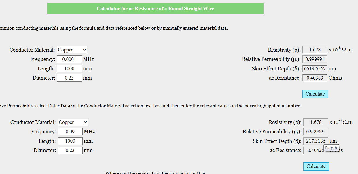

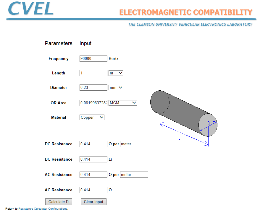

All the online calculators and nomograms seem to agree: for 0.23mm/90kHz, the difference between Rdc and Rac is negligible.Just checking - Rac ~3 x Rdc for 0.23mm wire at 90kHz. That indicates you may be down half a watt.
Of course, this is not an isolated wire, and there are also crowding/proximity effects, but they are of the same order as the "simple" skin effect, ie more or less negligible here

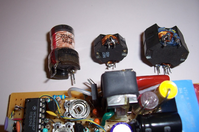

Yes, it is one of the options I already tested:Would you be better off to go to an RM8 or larger? The mT level would be lower, and you may be able to position the coil away from the air-gap (if you were able to get the centre leg suitably ground so that the outer sections had no gaps).
It did work, and very comfortably but it was too large and it would have had to stay off-board.Next attempt was based on a RM8, N67 core, also with a good number of turns. This one worked quite satisfactorily, exceeding the expectations, the only problem was the bulk: it couldn't physically replace the previous ones.
In the mean time, I also tested the RM6/N49 core with real litz wire.
Unfortunately, the one I have is thicker, and I only managed 23 turns.
This resulted in a peak induction of 340mT, which is uncomfortably high, yet it was still the best-performer, capable of reaching 315V on its nominal load without excessive heating of the copper or the iron.
Clearly the way to follow: appropriate litz wire + good ferrite like N49.
Combined with the alternate MOSFet power stage, it could easily exceed 10W output with a reasonable efficiency.
That said, for more modest power levels like 2 or 3W, there is no need to go to such lengths: the standard drum choke I showed would already be vast overkill
Nooo! 😱 Proximity effect is considerably stronger than skin effect, to the tune of an order of magnitude!
What matters is how many amp-turns there are above a given wire/layer. In an inductor, the first layer sees all the amp-turns of the layers above it, so it's a worst case condition.
In a transformer, you have some freedom to control this, by interleaving the windings: if every primary and secondary layer is interleaved alternately, the amp-turns cancel out after each layer pair, and you can get quite good efficiency without too much worry over wire size (such a windup is more labor-intensive, though, and may have too much capacitance / too low an impedance for an application).
