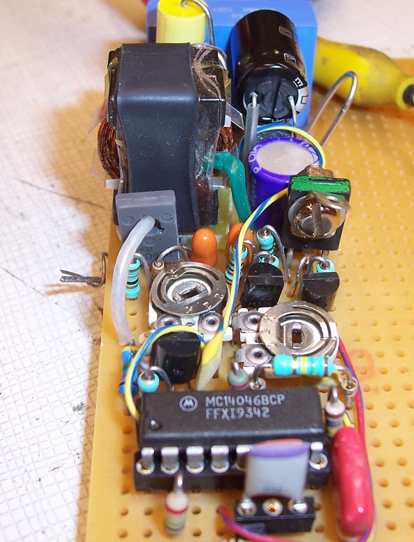

The circuit is unusual in that it uses a CD4046 PLL chip as a controller: it performs practically all of the required functions.

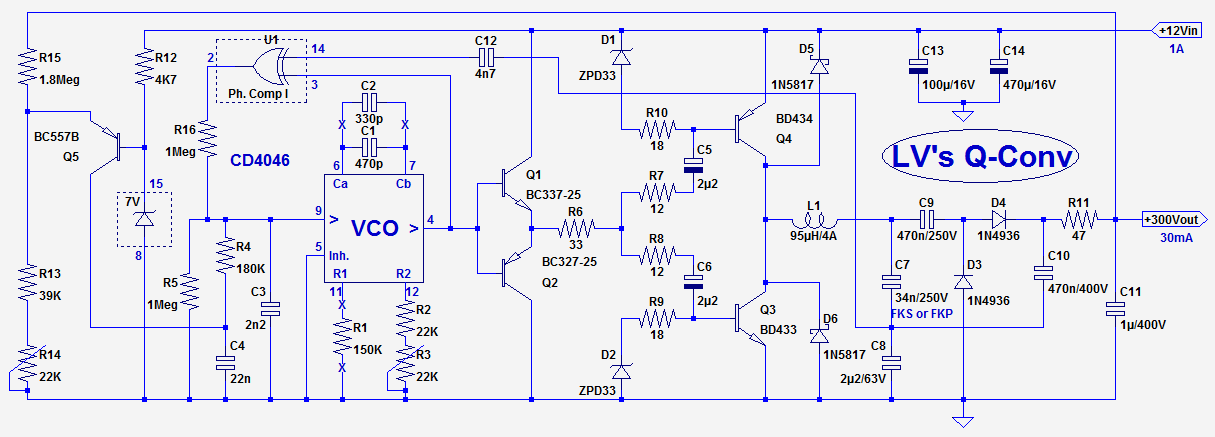

Power section:
The resonant circuit formed by L1 and C7 is driven by a PP of complementary transistors; the topology is not the ordinary follower, but a common emitter, more efficient at generating a rail-to-rail squarewave.
In order to achieve a fast and lossless switching, the driver circuit is rather special: it uses a double interlock mechanism allowing a safe and shoot-through-free switching without resorting to dead-times.
More on this later
The filter extracts the fundamental, and boosts it by a factor of ~25.
The resulting sinewave is applied to a voltage-doubler for rectification. In principle, the doubler shouldn't be necessary, but high boost ratios put very high demands on the reactive elements, and 25 is already hard enough. 50 would be almost unmanageable.
Control section:
The PLL is used almost normally, except it is locked to itself. This looks like an oddity, but is in fact quite useful:
The phase comparator compares the output of the VCO to an image of the current in the resonant circuit, sampled by C8.
C8 takes care of the quadrature imposed by the phase-comparator I.
As a result, the circuit will try to minimize the phaseshift between the output voltage and the current in the reactive elements, ie. drive them at the resonance.
This is quite useful, because it locks the VCO frequency to resonance of the passives, compensating for drifts and inaccuracies on both sides.
It also has another use: since the control is achieved by altering the balance, the sensitivity will be reduced by the gain of the loop.
Throwing control gain away in this manner may look counterproductive at first sight, but is in fact necessary: with a Q of 25, minute variations in frequency would cause huge variations of the output, making the stability control very difficult.
This mode of locking "dilutes" the control range, making it more manageable.
Regulator:
The regulator uses the internal zener and an external transistor: the emitter receives a fraction of the output voltage and compares it to the reference.
The collector generates an offset to the output of the phase comparator.
R5 offsets the initial point, allowing for a full dynamic range control.

Neat 🙂
The nice thing about a resonant converter is it's inherently short and open circuit proof; the output load line is 1/4 of an ellipse, without any added regulation (but tracking resonance).
The Z and Q seem suspect though...
Open, you've got L1 working into C7, which gives a resonant impedance of 53 ohms and "unlimited" Q (so you should have an inverter current limit function, in case the output ever goes nuts).
Shorted, you have L1 into C7 + C9 (and a little less due to C8; curious, why return C10 to C8 by the way?), giving 13.7 ohms and again a high Q.
Under nominal load, you have 10kohms DC, which is probably around 1/4 that or 2.5kohms AC. The tank impedance will be somewhere inbetween 53 and 13.7 ohms, giving a transformation down to 0.35 ohms let's say (Q = 85!), which will draw 17A, which I guess would be mostly reactive...
...That's probably an overestimate for the impedances under that condition. Of course there's no good formula for the average AC resistance of a rectifier. I think 1/4 Rdc is typical for half wave, so it's probably even less for half wave doubler.
Different ratios of C7/C9 would also give different operating curves. I don't know how optimal it is as shown, or what would be better.
Huh... aren't the zener diodes backwards, and/or drive applied to the wrong side of R9/R10..?
This is not a "regular" resonant converter, like a class E or normal ZVS: it is simplified to two reactive elements, which means there is no inherent mechanism to protect against open-circuit conditions. It is the resonant equivalent of a flyback converter
It isn't quite a tracking converter: there is some tracking, but modulated by the control
You could implement a crowbar circuit (zener + SCR or TVS), in case the feedback is interrupted. The problematic is similar to that of a flyback.
I preferred to monitor the actual inductor current; of course, I couldn't return the lower diode to C8 due to DC complications, but the first filter cap was OK
The pivotal impedance is indeed around 53Ω at the "normal" resonance, but this normal case only applies at the maximal output power, and only when it is delivered in normal circumstances, ie with a 10K output load.
At the resonance, the impedance seen by the drive is 53/Q, and the equivalent impedance (from an energetic point of view) presented by the rectifier is 53*Q
In all other cases, the Q is either much lowered, or not applicable because the drive frequency is very far from the resonance: this is the case for a short: the resonant frequency is very much lower than what the PLL limits allow (R1 sets the range) and the load becomes purely inductive, and completely recuperated by D5 and D6.
In case of a dead short, the measured supply current drops to 80mA, which is the driver consumption + the keep alive current for the rest of the circuit, including the power stage (less than 10mA in fact).
The maximum peak current in the transistors is ~3A, and occurs only at the nominal load (in case of an open output it would be much larger, but this is principle not allowed)
One could play a bit with these parameters, but the primary function of C9 is to provide energy storage for the doubler, and reducing its value means a higher voltage in front of the doubler, which is not desirable for a 300V output
No, everything is correct but will need some further clarification as I said, since it isn't obvious or straightforward

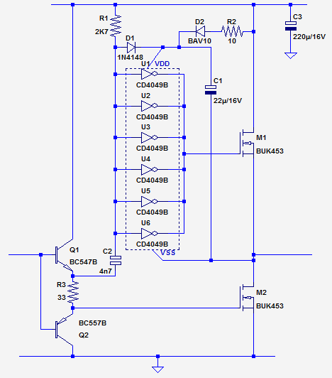

Complementary Mosfets could certainly be used, and in fact I had the intention of recommending Mosfets drivers as an alternative for lower power versions, but you overtook me 🙂
Here is an example of such a driver (I am sure better options are now available, this is just an example): http://ww1.microchip.com/downloads/en/DeviceDoc/21420d.pdf
This one cannot compete with the discrete version I proposed in spite of its 9A peak current capability, but for lower currents, it is certainly an option worth considering
I was thinking more of this type of part:
https://www.fairchildsemi.com/datasheets/FD/FDS8958B.pdf
but maybe shoot through can't then be easily managed.
Their power characteristics are vastly superior to that of a complete driver. Of course, you need to do some homework to make them operate smoothly, but that shouldn't be too difficult compared to BJT's

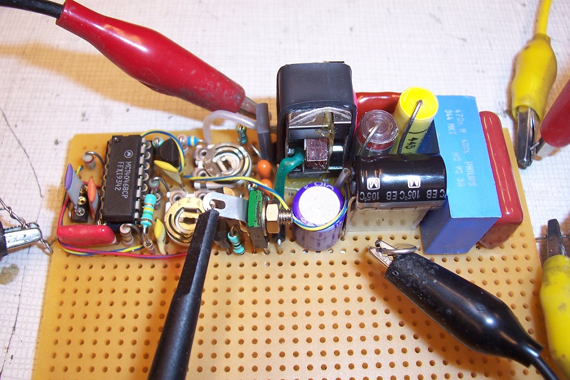

What is the frequency span? Is the inductor a gapped PQ core?

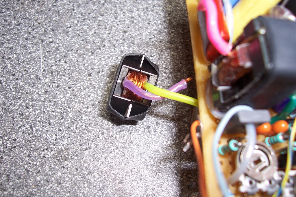

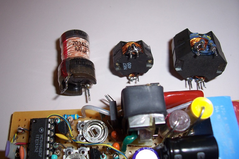

In my prototype, the frequency span is 87 to 90KHz and the inductor is based on a planar PQ core that I gapped myself. Not a very good solution, because the gap needs to be large, half inside half outside, meaning atrocious stray fields (Ok, I could have tried to grind the center pillar, but I have the feeling it would have ended in a blood-bath).
The inductor was the most difficult issue with this converter: I started with a standard power choke, based on a drum core, and it worked, but performances were not good.
I then opted for a custom-made RM6 based inductor. Material grade N67, copper window filled to the rim. It worked, but the iron became hot very quickly.
Next attempt was based on a RM8, N67 core, also with a good number of turns. This one worked quite satisfactorily, exceeding the expectations, the only problem was the bulk: it couldn't physically replace the previous ones.
In the end, I opted for this planar PQ core (N97 I think) with a self-supporting coil. No more problems of iron overheating either, but the huge gap made in an amateur way (with spacers) sent stray field everywhere.
During the first test, with the coil connected with flying wires, everything worked fine, like the RM8, but as soon as it was in its assigned place, things turned sour:the stray field interacted with the cans of the E caps, the foil of the PS caps and the metal tab of the TO126.
This reduced the efficiency and the maximum output power: in its present form, it only manages 290V out on a 10K load.
Here is an outline of the successive iterations:

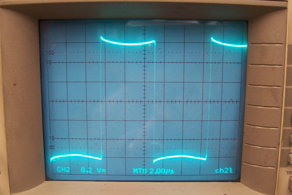

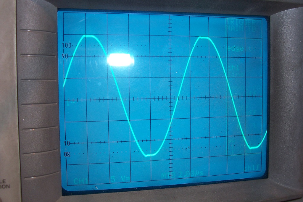

Here are one or two waveforms: the first is the PP output, on the collectors of the transistors.
Output power is maximal, which is visible because the Vcesat modulation is a perfect, well-centered arch, meaning the current is exactly in phase with the voltage.
Second pic is the filter output, just before the doubler. The tops are somewhat flattened by the recifier, but otherwise the general shape is that of a very good sinewave.
Nice thing with sinewaves: the rectifiers don't need to be blindingly fast as the rate of change of voltage is gentle.
The 1N4936 are "fast", but very ordinary: certainly not ultra-fast.

I will now try to explain how the driver circuit works. It is a bit overcomplicated, but the end result is excellent.
Most of the series resistance for base current limitation is common to the N and P devices: R6 is much larger than R7 and R8.
Capacitors C5 and C6 take care of DC level issues, but not only: because each charge balancing diode D1 and D2 is equipped with a series resistance, the capacitors will end being charged at an average voltage > Vs/2.
This means that both devices will bend towards the Off condition. It is a first measure against shoot-through and simultaneous conduction, but not the only one.
Because the bases are tightly interconnected, and because of the bias, a transistor will only be able to conduct if the emitter junction of the opposite one has recovered completely from the forward conduction.
In other words, the drive for a transistor waits until the other has finished recovered.
Of course, waiting for emitter desaturation goes a long way towards a clean and ideal switching, but even when the emitter is desaturated, some carriers remain in the collector junction.
To allow for their evacuation, an additional time is provided by the reverse recovery of the base anti-parallel diodes: that is the reason for using zeners: unlike ordinary 1N4148, they aren't gold doped, and have a significant recovery time: around 150ns in this case. Because zeners must have a relatively thin junction to function, their trr is not quite as bad as ordinary Si diodes, like 1N400x.
Many years ago, it was possible to find GP diodes that were not gold-doped like the OA200 series or the 1N646, but today the simplest option is to use a zener (avalanche in fact).
The secondary delay provided by this diode only starts when the first one is cleared.
This timing sequence provides an adaptative delay, meaning no added dead-times and inherent temperature compensation: if the temperature increases, the collector desaturation time will also increase, but exactly in the same proportion as that of the compensating zener.
The result is near-perfect at 100KHz using slow transistors, and could certaily be pushed to 200 or 300KHz using the same devices.

To adapt the frequency, change the capacitors C1/C2, but keep the resistors value.
Note that for the 4046, there is a wide spread of oscillation frequency between manufacturers.
The schottky' across the transistors are not indispensable: they are completely inactive at resonance and serve only when reactive currents need to be recuperated; without them, there are alternative paths, but they increase the efficiency at loads < maximum

It can be seen in the voltage waveform I have published: even though the 1N4936's are crap by audiophile standards (not very fast, and not super-clean recovery), they produce no visible unpleasant artifact, for two reasons: the capacitive source I mentioned, and the sedate rate of change of current and voltage.

I have developed an alternative power stage based on MOSfets, but this one uses only N-channels, which are cheaper, more efficient, and exist in a wider variety than P-types.
The job of inversion/bootstrap for the upper device is carried out by an IC, but it is again a commodity, an hex CMOS inverting buffer.
An ordinary 4069 hex inverter also works, but the 4049 gives slightly better results.
As a result, the efficiency of the converter is somewhat improved because the driver's consumption is reduced (~1W for the Bjt version), and because the squarewave swings closer to the supply rails.

Some background. For quite a while I have been searching for sinusoidal (to minimize potential noise problem) HF HV DC supply and HF LV AC filament supply for a compact DHT hybrid amplifier. So far the alternatives I found require SMD parts which I am hesitant to use. Very happy you decided to share the Q-Conv which generate 150V sinusoid at 90kHz, just what I need.
I'll first build it as designed but without the doubler. I can get gapped ferrite EI core for L1, if that does not work I know how to make a gap on ferrite toroid by using a hacksaw and mini grinder. I'll tinker with the transformer for galvanic isolation later. I hope I'll be able to get the adaptations I want well enough.
I'll first build it as designed but without the doubler. I can get gapped ferrite EI core for L1.
If you have the choice, try to use a modern, high performance ferrite material: for example, 3C98 in the ferroxcube system or N49, N97 for Siferrit.
Standard power materials like N41 won't work well.
Even with "good" ferrites, stay below 150mT^ induction, 100mT^ is even better if you're not space-constrained.
For the winding, use preferably litz wire, or at the very least multistrand.
Do not be too generous with the current density: this may look paradoxical, but since eddy current losses are the dominant factor for this kind of inductor, reducing the bulk of copper to the strict minimum is beneficial
In the end, I managed to pack the inductor into a RM6 core: I used N49 material with a self-supporting coil, allowing for a bit more turns.
The peak induction is 210mT, and the iron only heats up mildly.
The only issue with this choke is the wire: too few strands for the section, but the temperature rise remains bearable, and with this choke, the converter has no problem reaching 300V and beyond into its 10K load.
With proper litz wire, it should work even better. That will be the next step

Do you recall what was the peak voltage across the winding and the peak between two turns on different layers? .
The total voltage is 150V^, and there are 37 turns in 5 layers (some 7, some 8).
Maximum voltage between two turns is therefore for 8+8=16t, about 65V
As it is a sine current, with low harmonics, what wire diam would want for skin depth
Skin effect is not really a problem here, even with 0.23mm: the skin depth is 0.2mm, and Rac~=Rdc to one percent or thereabout.
The DC resistance of the winding is 100mΩ, and based on Joule's effect only, it should dissipate 0.4W (Irms=2A)
But the actual dissipation is about 3 times as much, and the eddy currents are to blame.
This is a problem common to all inductors subjected to a large reactive power: 215VA here. If even a small proportion of this power is lost, it immediately translates into a significant, real and active power dissipated.
The only remedies are distributed airgaps, or finely divided wire
