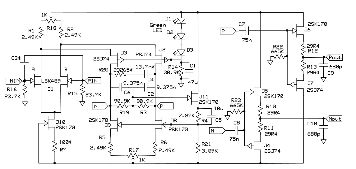

I promised Patrick that I would post the final schematic of this circuit so here it is. I have a lot of JFET's in bags here and there but I didn't get inspired until I realized how simple the common-mode feedback would be to do with nothing but FET's. There is nothing that special here, a simple undegenerated diff-pair, folded cascode, and buffers. J11 provides common-mode feedback and for a differential signal has no "work" to do but keep the common-mode DC level around 0.0V, so I don't even consider it in the signal path. So we have a purely current driven RIAA network with all the time constants between two nodes. The AC coupling in the output is optional, I don't like servos so what.
Almost everyone I show this to starts adding more supplies, extra cascodes, current sources, etc. that's not the point. Bob Cordell published a phono pre-amp in Linear Audio and I started looking at this as removing things from it until it stops working (Muntzing).
The output buffers are a little side experiment. I chose the FET's in a way contrary to just about what everyone else does. I did NOT match the Idss's, instead I sorted them such that a single standard value of source resistor would set the operating current at the same value. I picked 5mA and used a homemade curve tracing jig to sort 25 each N and P FET's. So now when they are connected together the input to output offset is 0, no trims. It turns out that this had less un-trimmed distortion (in sim) than selecting equal Idss's and trimming for just offset (story for another day). Worked fine when stuffed all four were < 5mV. I picked some reasonable matches for the rest of the pairs. I had to snub the output of the buffers with 680pF.
Notes on the amplifier:
I chose the LSK489 FET pair (thanks Paul Norton and Linear Systems for their support of the DIY community) because it had higher Vp and lower transconductance (gm) which gives a wider range of linear input and keeps the RIAA network's impedance level from getting too low. Bob used the LS844 which has the same gm at 1mA and chose 20dB midband gain but his load resistor value does not reflect that(Bob ???). I chose 26dB midband gain and used the 3mS gm at 2mA from Bob's app note which should be the correct value. R7 is chosen for around 1.0ma per side of quiescent current, that and a goal of 46dB of DC gain gives you a target for R19 and R3. At 2.2mS gm for the FET at 1mA two 90.9K resistors were chosen and the rest of the RIAA values fell from that. The caps were all chosen from a large NOS stash of TRW 1-3% polystyrene hence 9.375n was actually an exact available value. The resistors are all 1% Dales with R20 two standard values in series, while C4 was two caps in parallel.
Since all LSK489's have nearly the same gm at 1mA R7 was a trim on the second channel for gain, and it was easy to get nearly .1dB match. The lowish midband gain means a low noise line stage is necessary if you want the SNR limited by the input FET noise alone over the entire audio band, if you take A weighting into account I'm not sure this matters much at all. For first listening I will use a low noise in-amp at a gain of 14dB to bring up the midband gain to a more standard 40dB and give me a single ended output since as yet I don't have a differential input system.
R18 and R17 are redundant offset trims, the idea was that by skewing one and bringing the offset back with the other one might be able to null the residual second harmonic. The distortion was so low I would not include both again.
The three green LED's set the current in the folded cascode to around 1.75mA this is not super critical it just wants to be enough. R4 could be a trim, it sets the common-mode voltage but I just computed the value and put it in.

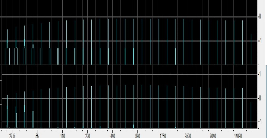

RIAA accuracy is pretty good (the drop at 20k is Windows brick-walling my soundcard at 22.05k in the background) and the low rolloff is half due to my added high pass at the output. Mostly +-.1db out of the box. Picture is both channels (offset is random and does not indicate the gain mismatch). The RIAA response used a 1/3 octave multi-tone (30 tones) signal pre-emphasized at the same .025mV rms in which will have a crest factor more like recorded music. No IM noise floor was observed.
This is a work in progress, the recent availability of complimentary pairs of FET's from Linear Systems means that it may be possible to realize this entire signal path with LSK489's and LSK689's. I know this is JC's thread but it is the lounge after all. Comments like, "We did this fully complementary 40yr. ago", etc. are inevitable, I've learned there is no point in asking them not to come flying.
EDIT - The supplies are +-15V and the bypassing is left up to the builders personal practice.

Scott -- how does it do on overload? I'm not in the mode of a RIAA, but the CM feedback mechanism and the overarching elegance of the circuit makes for a fun idea to play with (to this amateur).
And of course, thanks for the circuit, and, IMO more importantly, the explanation.
It behaves like Bob's for the most part, I'll look at clipping of the actual build since I have relied on sims for that. I expect very soft compressive behavior especially for tick and pops.

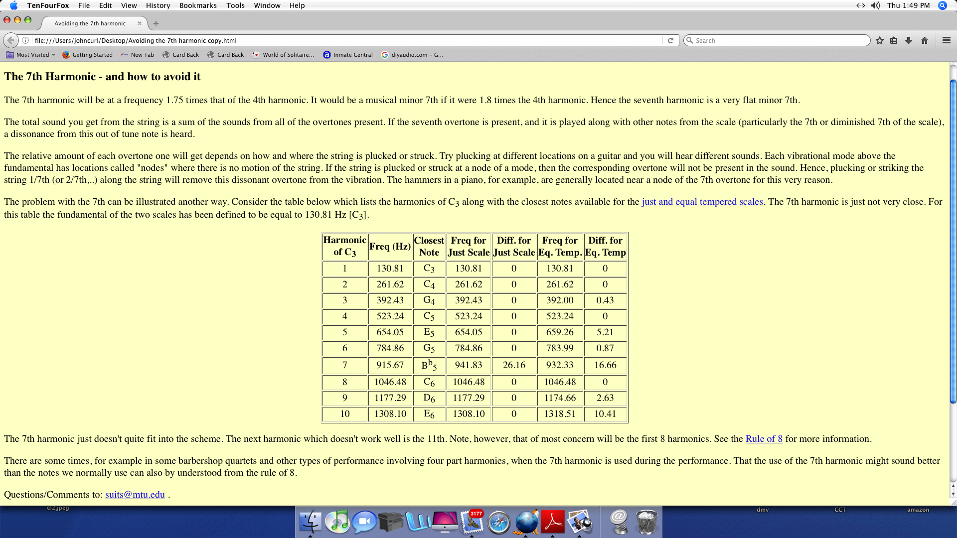

As good as I expected, more than 25Vp-p at clipping and at 20Hz there is a little droop after clipping from the common mode loop or the coupling cap, nothing pathological. Your woofers would be long gone before this. THD at 250mV rms in is still <0.5% and still no 7th's 😀. FET's just can't make high order harmonics.
still no 7th's 😀
Pity, sometimes a minor seventh really helps a chord out. 🙂

What is the CMR vs freq and the +/- PSRR vs freq?
THx-RNMarsh
CMRR was -86dB at 1kHz, pretty much follows the RIAA curve so I would say fairly constant with frequency. I was scared for a minute because I am using two channels of a sound card to make a true differential input and when I set the phase to 0 the CMRR didn't look so good. The DAC's turn out to have 0.5% gain mismatch, had to short the inputs and use one DAC.
I removed the bypassing and nothing oscillates so I was thinking I would try to measure PSRR by putting an old output transformer backwards to inject some AC in series with the supply with the 4 Ohm tap. Anyone try this before?
