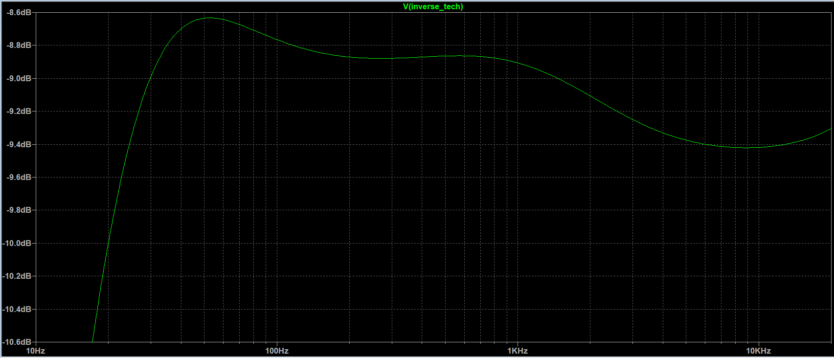

I plugged the values from Technics RIAA circuit in the original post into a circuit simulator. If you run the signal thru the RIAA equalizer, then thru an ideal inverse equalizer you should end up with a flat response. This is the response I get from that circuit. Usually you shoot for +/-0.25 dB from ideal. This one is about 0.5db down in the 5-10 kHz range. It has a little bit of boost below 100 Hz, but really that could be a good thing for many systems. But it's not entirely accurate. There's nothing wrong with the basic circuit, but I would choose different component values. There are online component calculators out there if you search for them.

So what you're saying is that the Technics designed a pretty damn good equalizer.

My sims show +/-0.33dB, which is better than claimed. For an All-Standard-Values design it is very good. The 5kc-10kc slump is very mild and may be a brand-preference.

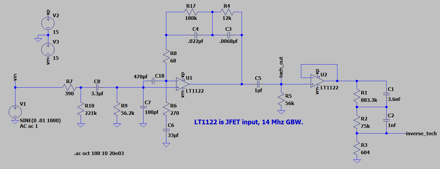

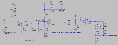

I'm interested to know how the inverse RIAA function in your simulation works. I used the network from Jung/Lipshitz. My schematic attached.
