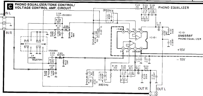

Look for the Kenwood KX-A36 manual on line, it has a nice circuit on a small PCB, and the foil side is also there.

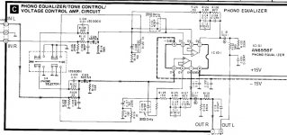

Here is a MM/MC version from Technics, in their better integrated amps.
On my Kenwood manual, AN6556 and M5218P are shown as interchangeable, on 14V rails.
In the extra phono pre section.
If it helps...
If it helps...
It's nice to know that there is a replacement for the IC, thanks.
