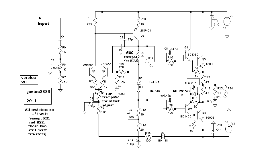

Hi all.
In the amplifier there are two compensations, miller cap (c5) and phase lead (c2). My question what is function of the R15//C8 and R16//C9?
One to ask the designer perhaps. They appear to serve no useful purpose.
(The 1N4148 in the negative rail could see transients at switch on that exceed its limits... supply rise time dependent)
You see that in old Grundig amps, too. Presumably this is intended to keep VAS loading in check at AF while ensuring a driving impedance as low as possible at higher freqs, i.e. making the output stage as fast as possible, which then in turn allows going easier on the compensation. How it works out in practice, no idea. Effectively not having a base stopper is a bit risky WRT local oscillation, but then again if VAS output impedance keeps dropping long enough it may still work out...
BTW, I wouldn't trust bias stability in this circuit much.
