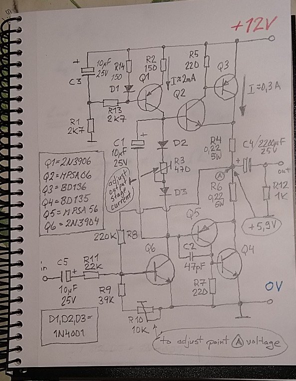

A simple discrete one-watt amplifier

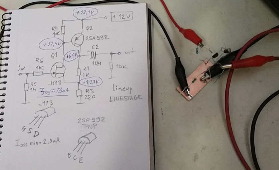

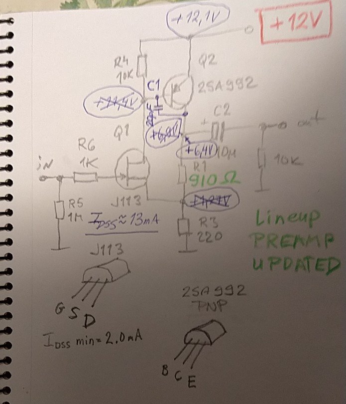

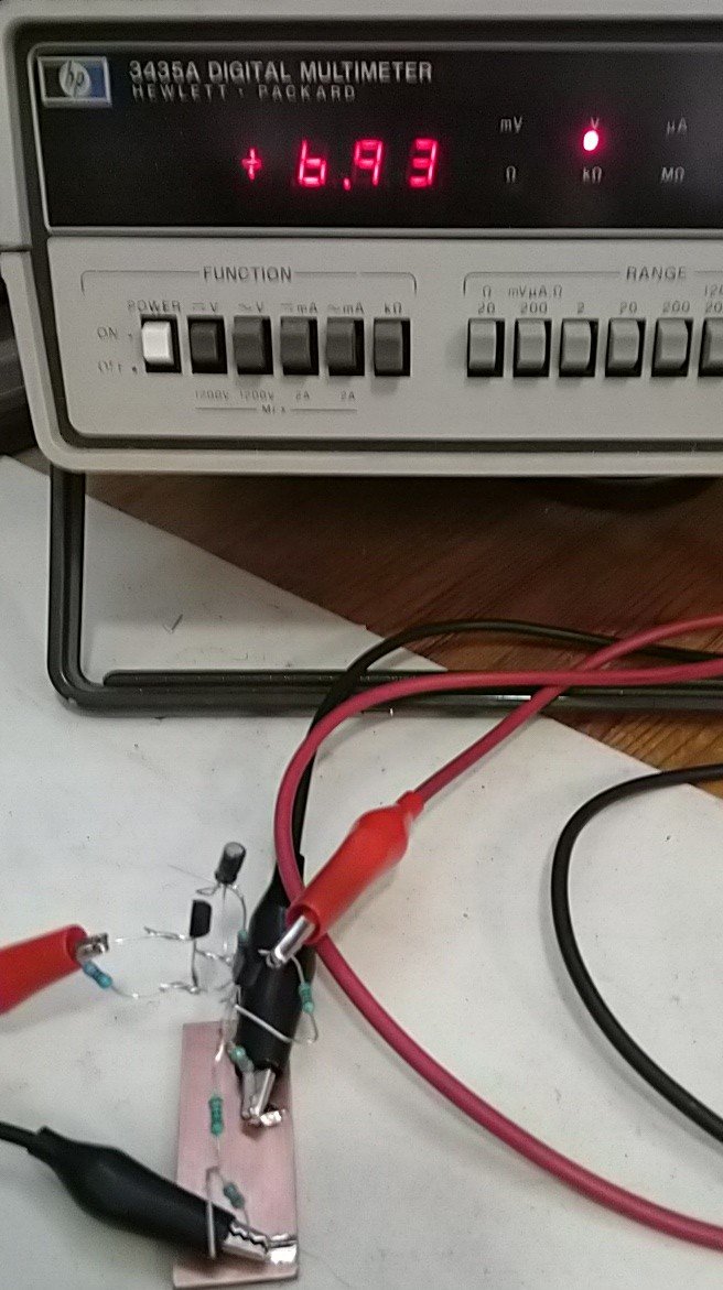

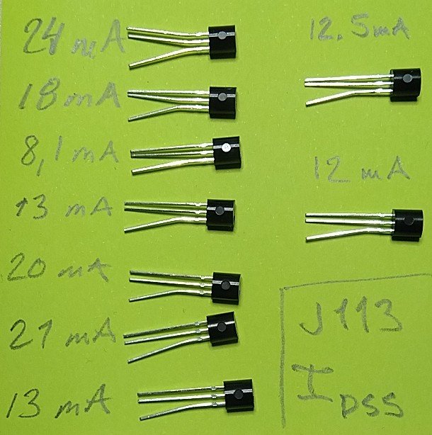

Some measured J113 for 'lineup' preamp. Message #210. They specify in datasheet only min Idss=2.0mA. Seems to be four fet's near 12mA.

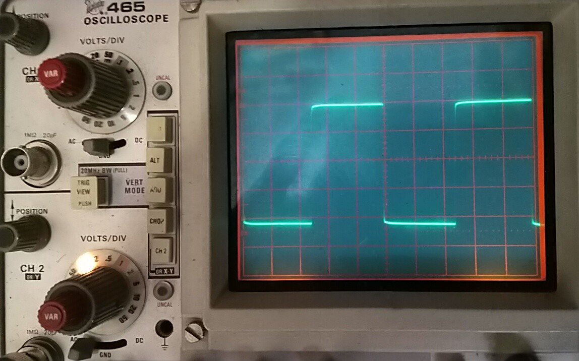

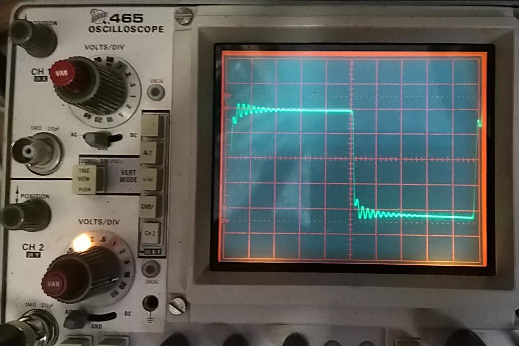

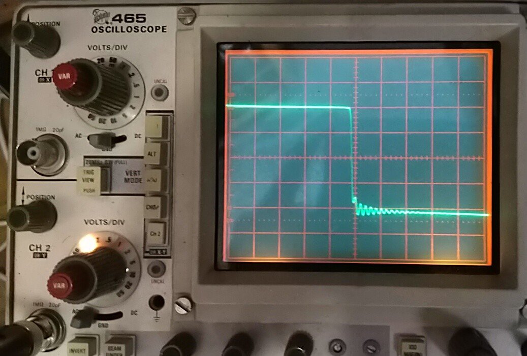

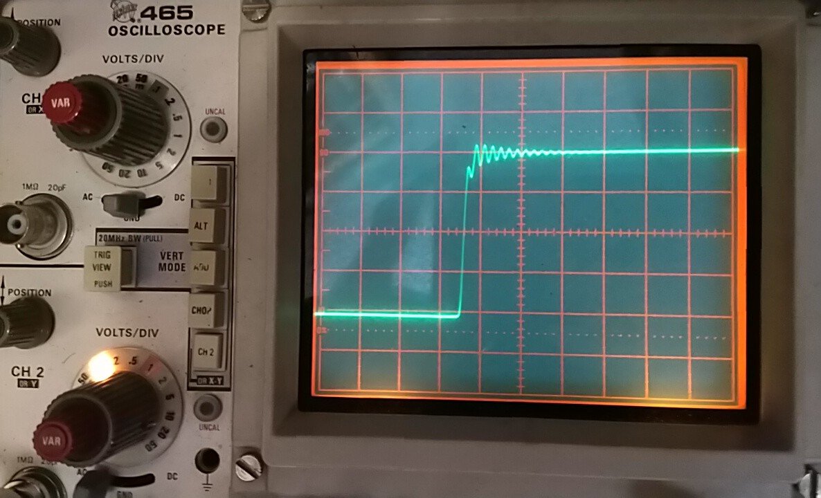

When using only sinewave everything works well, but 10kHz squrarewave shows some ringing and 100kHz is even worse. This amp needs some compensation cap inside feedback loop, maybe over pnp transistors C-B junction.
Edit: one 20pF comp cap is enough to correct this , last picture shows 10kHz sq wave with comp cap. Simulations are fancy, but in most cases they don't show all.

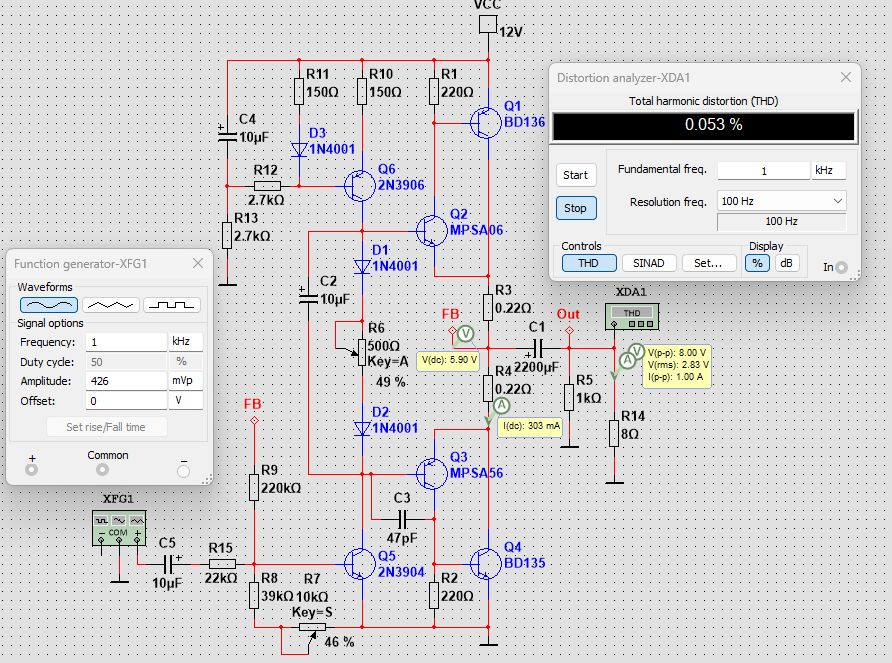

My amp in real testing.
The capacitor is a good idea - 20pF
I might test this in my SPICE.
Unfortunately I can not build anything for real - I just simulate.
What is good is that no input capacitor is needed for this preamp.

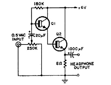

I like this project, reminds me of my own, because of the kinda Sziklai feel about the circuit.
There's something v satisfying in building simple topologies although there are plenty of details that need attention to make it an interesting project. I haven't used my amp for a few years, your thread has brought back some good memories of it.
