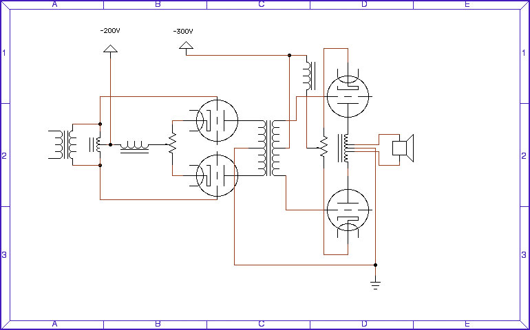

I have got a response from Victor Khomenko, one of the big guys from Balanced Audio Technology. First of all he said 150R is too low and 600R is too high. They use a somewhat similar OPT in the vk-55 amplifier, but specified 300R. The 150R suggested indeed a setup of four tubes. And also he suggested mismatching the OPT's. There is even a 2 Ohm section, so connecting wouldn't be a problem even with 4 Ohm speakers.
The setup I'm going to start with will probably be 180V and 150mA with fixed bias.

Hi Erik,
I agree. These are strange OPT's As I understand the 150R would imply 4 tubes while the power rating is 80W while with only two tubes this 80W is already possible... I'm stil a little curious why the 150R was chosen.
Also what I think is a bit strange is that my OPT's are slightly different from the datasheet. The datasheet shows one primary winding whith a center tap on the primary while mine have two primary windings.
When I've got something up and running I'll surely post some pics and comments. I'll probably start with something ultra simple like the input/driver stage from the monobill from Triodedick. I don't know if that would do it for this amp, so I have to do some further investigations in that.

I think the input/driver stage from the monobill has too low a gain. The stereo bill would probably be better, at least it has more gain.

if you have dual primaries, you probably have more options. Could wire in series or parallel probably - would change the impedance the tranny and tube wants to see.
what's the inductance? that's what really matters, not some (useless) arbitrary number like 150R. The things that matter are turns ratio, inductance, and power handling, when talking about trannies. Don't obsess about the 150R number. Just try it and see what happens. you already own them so you have nothing to lose.
the BAT VK-55 is basically a cheaper, dumbed-down, smaller version of the Vk-60. The vk75 is almost identical to a vk60, with the exception of the CCS-loaded driver stage using 6H30. So from the 6C33's point of view all 3 amps are very similiar, esp. vk60 and vk75.
Single-ended bridge mode is a fairly unique method of operation. BAT is kinda coy on how it works, I think. it's not PP, more akin to parallel SE I'd think.
BAT uses Plitron OPTs and power trannies, but likely not these exact same ones, (or if they do Plitron and BAT won't confirm it, I am sure), probably something similar but spec'ed slightly differently I'd guess.
Paralleling 4 tubes per channel is more than you want to consider biting off for a first-amp project, IMNSHO.

I think if you try to use them in a PSE mode, you will need to do it as a parafeed circuit. Not as difficult as it sounds with the low voltage you will be using. There can be no DC in the transformer and parafeed achieves that.
I think you can get by with 2 tubes per channel if you have them running at about 100V across them and 200mA per tube. That arrangement should be quite managable for a starter amp.

So I picked up the Morgan Jones book (great book btw!), and read through the 'crystal palace' amp scheme. My only question with using this front end with the 6C33C's is the supply voltage. Far too high for the 6c33c, but then if you don't use this high of a B+ then will you need to do seperate supplies?
I am also looking to do the phase splitting with an input tx, so then I don't know if this front end is best for my purposes. Dave's schematic looks like it'll work, but maybe I'll try 5842's instead of 6c45pi's. I haven't heard too many good things about the sound of 6c45pi's.

Sure the supply voltage is too high for the 6C33C, but if you look good, you see Morgan Jones uses a separate trafo/winding to power the end stage (the 13E1). The front stage has got its own supply. I would say the 6C33C could be fed very well with a cheap insulation transformer with 220VAC out into a fullwave rectifier with a C input (maybe RC) and than burn some volts - and lot of watts - with resistors.
Phase splitting with TX's is possible, sure, but I don't know if it is worth doing in this case. To drive the 6C33C you will need lots of swing, which are provided through the cascaded front end of the Crystal Palace. Just one amplifying stage will probably not be sufficient...but then, you have to look at it. I think the scheme as shown is excellent as a starting point, and tweaking is always possible (afterwards).

I used a main toroidal as a interstage phase splitter. It worked, but interwinding capacitance knocked the response over 8K. I had to pump a lot of current into it to make it working well. I also rapped some feeback around it and used plate to plate feeback to get the output Z of the driver down. After all that it has worked out well, though the -3db point is still only 35khz.
My suggestion is either get an expensive interstage - or step down the split signal and then put it through another meaty driver tube to drive the 6c33 grids.

I want to build this amplifier.
6C33C - PP-Amp von Ernst Roessler
Does anyone have experience with this?
Thank you!
Thank you!
Thank you!
I do not have personal experience with this , but it looks pretty nice.
Maybe I would replace the R13/R14/C6C7 with one resistor, to make a differential driver.
