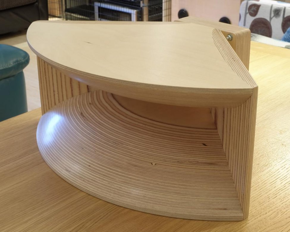

I thought I'd post a picture of a radial horn to show how it might fit into the space. It needn't be as elaborate though, a flat fronted commercial waveguide might be extended to fit.
Nice looking speaker, that. I hear they are quite heavy.
Maybe offering the radial was a mistake, it's not for everyone and SirDystic seems to have drivers chosen.
I hope he lists them, and tells us which ideas are good as they come up. This would be a good project to put effort into but without giving us the constraints, it's near impossible to move forward.
