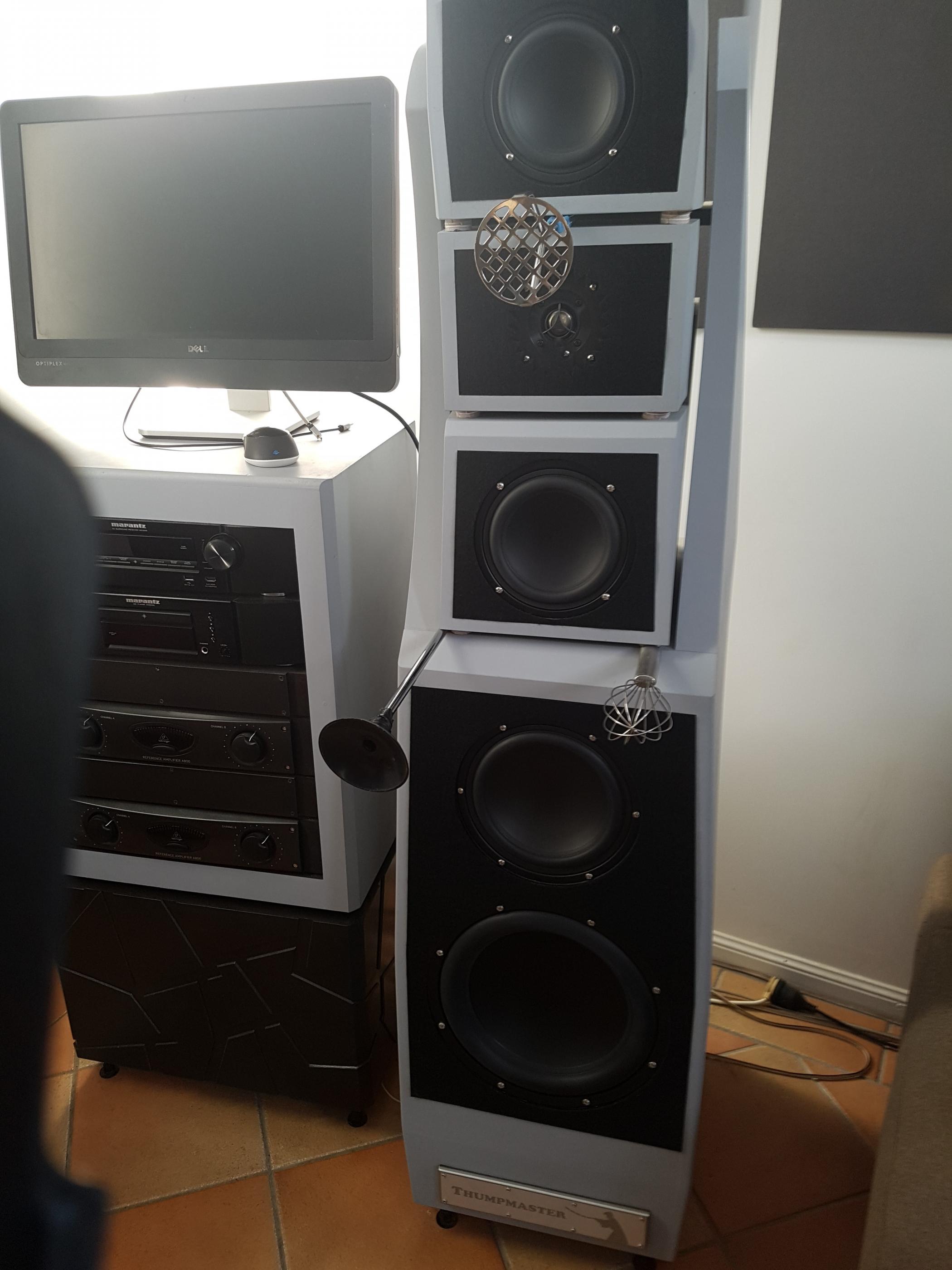

Anyway, I'm thinking horizontal MTM in the neck, upward firing woof in neck base, maybe ported to the light skirt. using drivers I already have.. Drawings to come...

That being said, what you suggested is going to be part of my build strategy.
I,ll try explain without pictures.

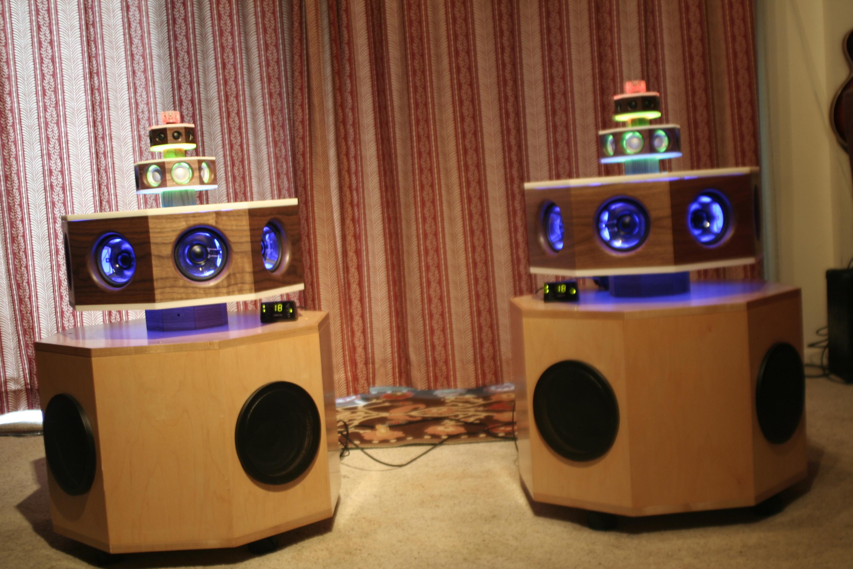

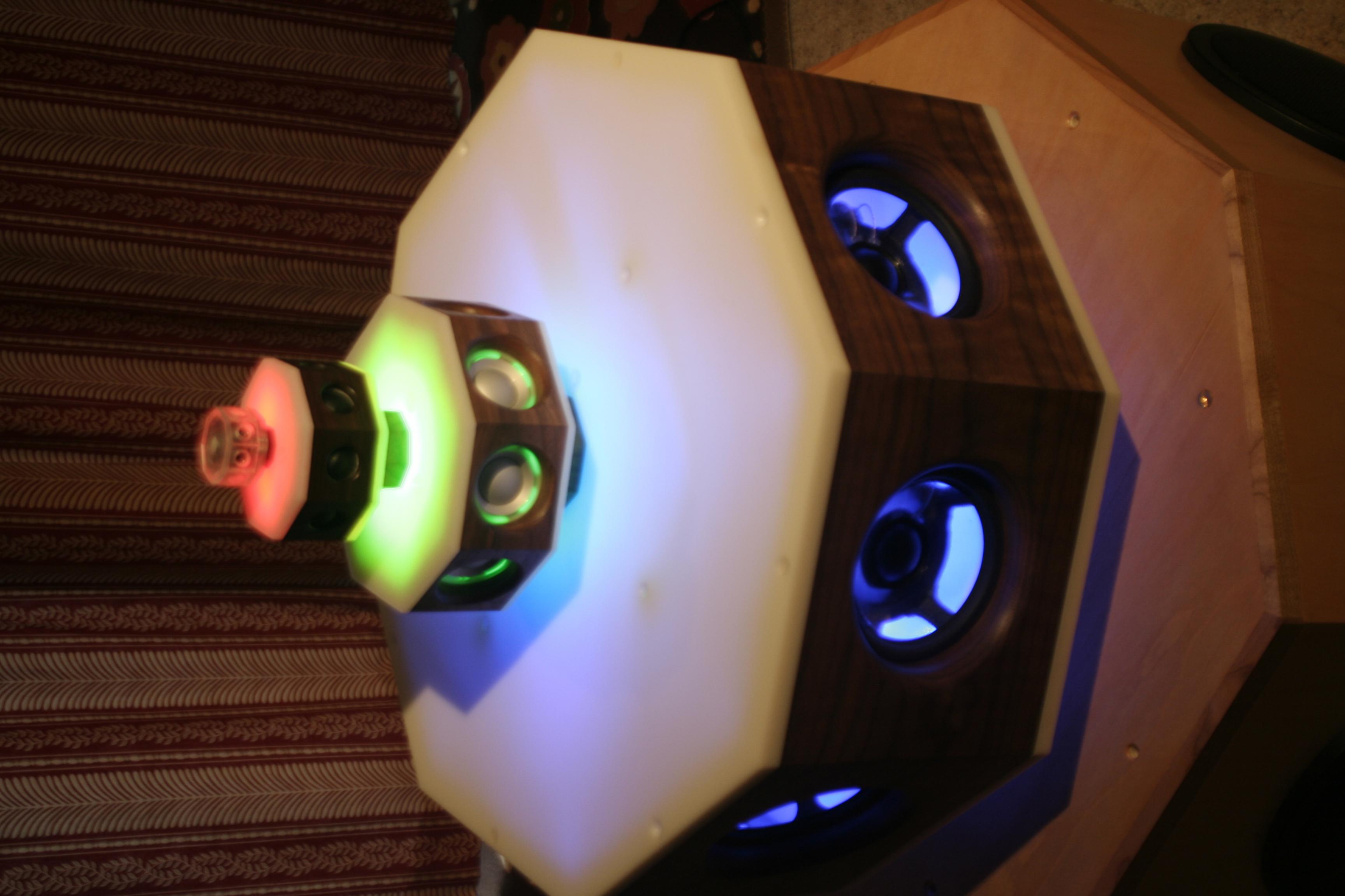

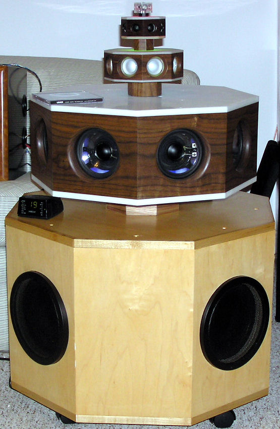

I will consider the driver unit and the dalek as two separate modules, the audio module will be a up firing 12" woof in a formatube housing ported at the bottom into the skirt cavity but firing at a horizontal plinth a few inches away on which the horizontal MTM array sits, as a module it will look ugly as sin, painted matt black to make it impossible to see behind the neck grill. Easy to make and no attention to detail required, because, well you wont see it / them.
These modules will just drop into the upper skirt plate, located on 3 captive balls for rotation / directivity. the grills and neck plates I will make as acoustically inert as I can given the design constraints. The outer shell although appears difficult at first then becomes quite easy as it merely a facade. Any other thoughts or ideas are of course most welcome, as long as it doesn't involve unicorn fur...🙂
