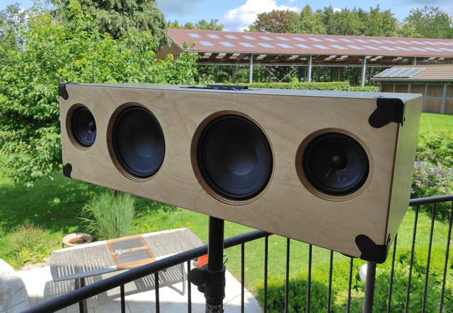

Yea this driver looks really promising. I have the brother 4FE32 here in a bluetooth speaker, to be used above >300Hz - build is just finished, still have to measure and configure DSP, but just fullrange driven the little Faital 4" play surprisingly well and complete:
The 4FE42 seems to be designed even more exhausted.

I would call it more of a midrange, suiting LR4 high pass 300Hz and low pass 3000Hz with a healthy 89dB/2.83V (8 ohm driver) following baffle step losses:
