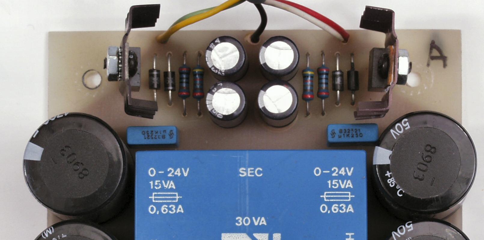

Some mods you can do, some are difficult to get the parts for.

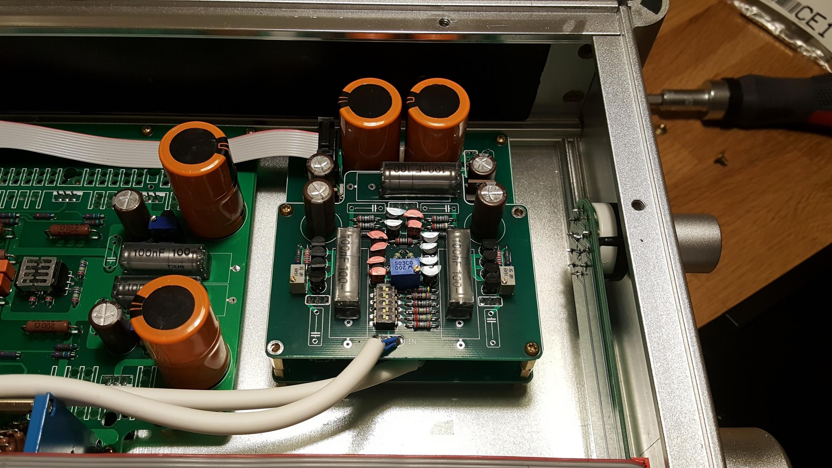

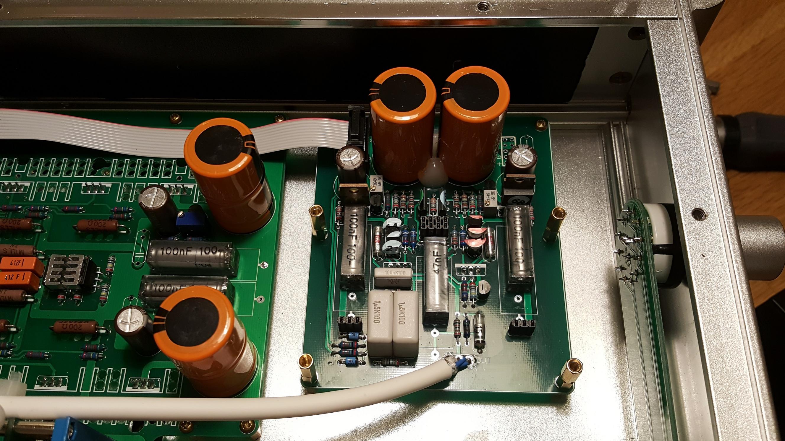

Interesting thread. Did anyone actually build the amplifier - except John himself of course? ��
Maybe I'm the first?
Yellow trace is preamp on top of power supply.
Green trace is preamp moved some distance away.
~80dB at 50Hz is quite sensitive for stray fields...
This is not quite what is the describe in the schematics in this thread tough.

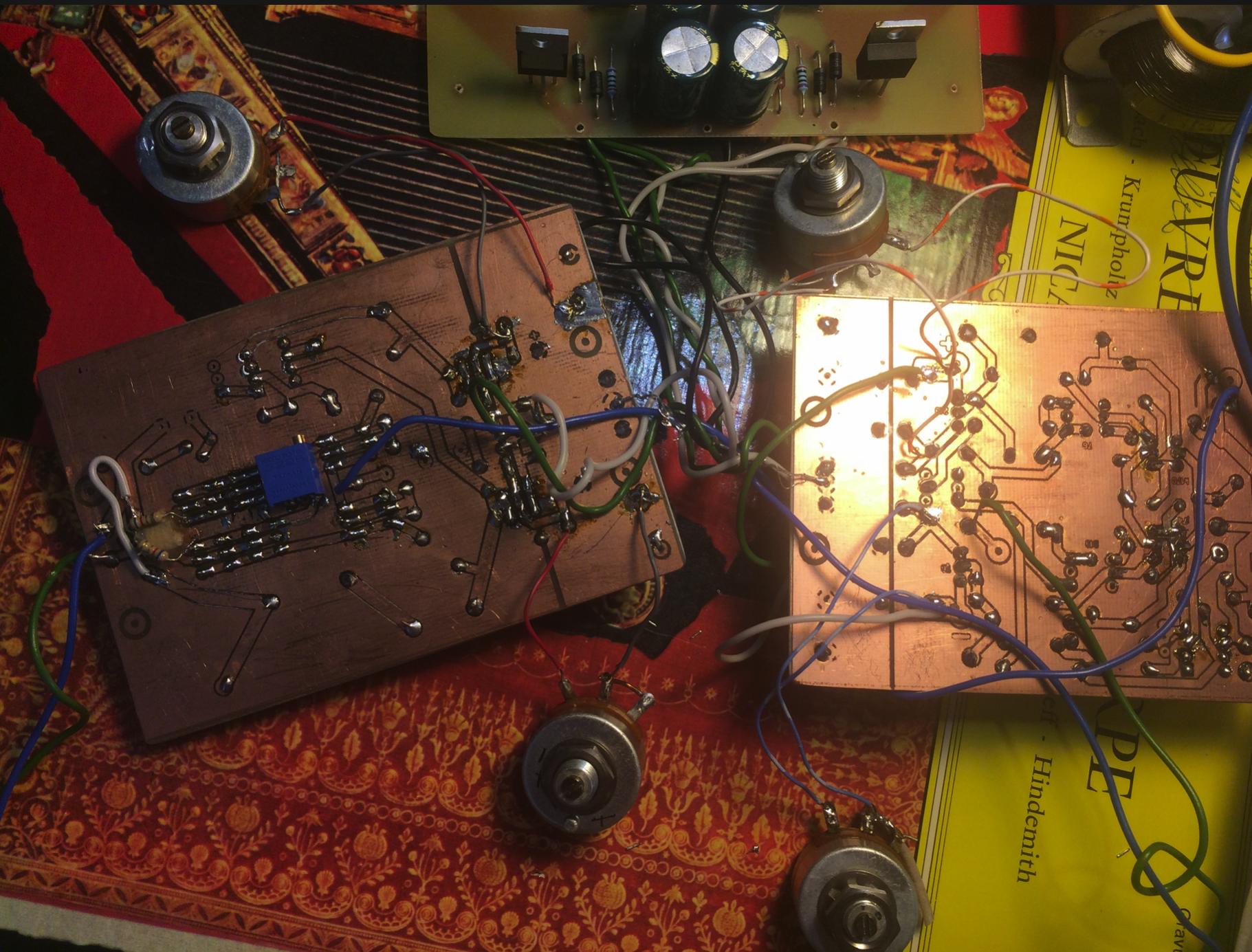

The gain is very good!

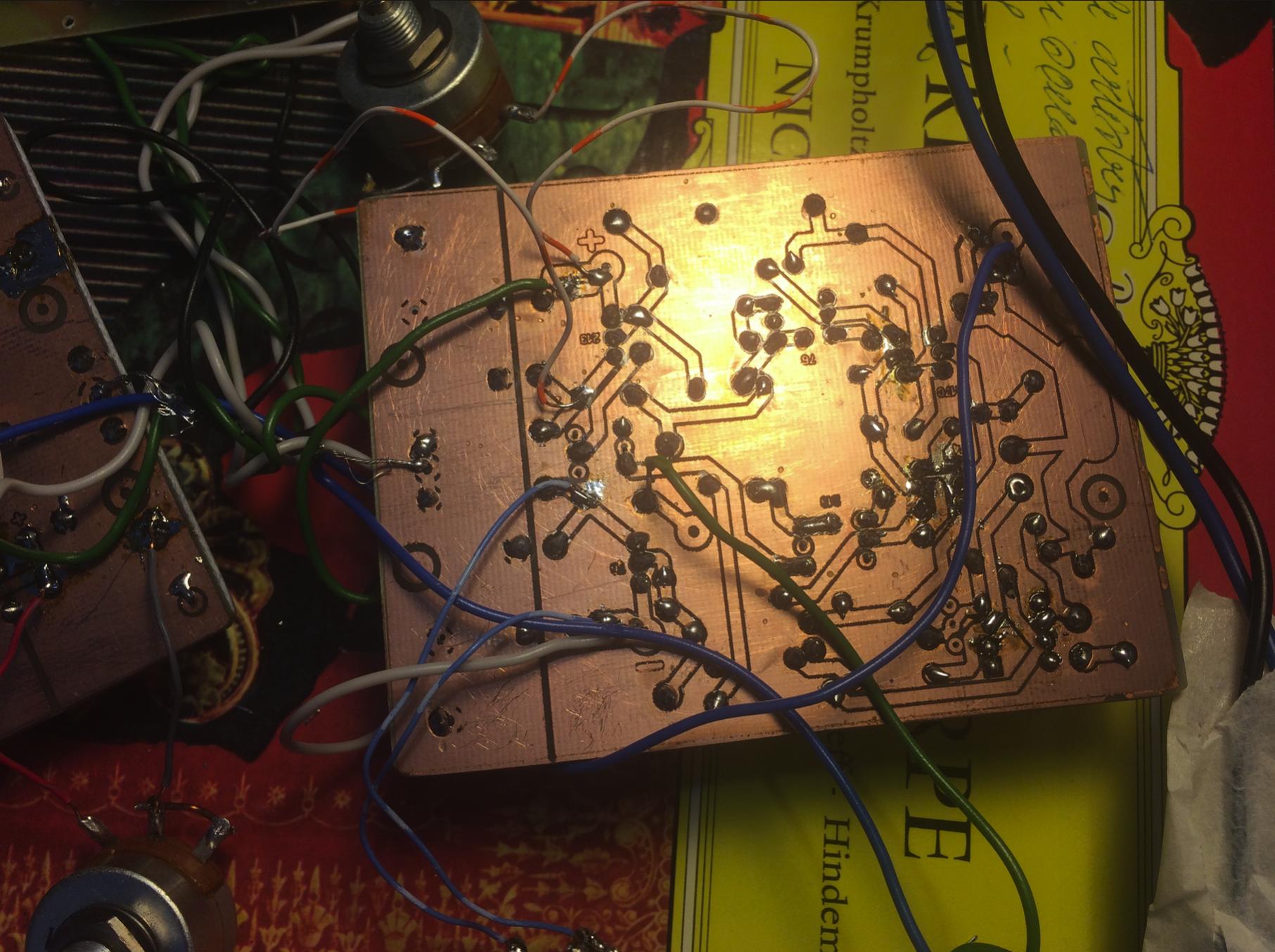

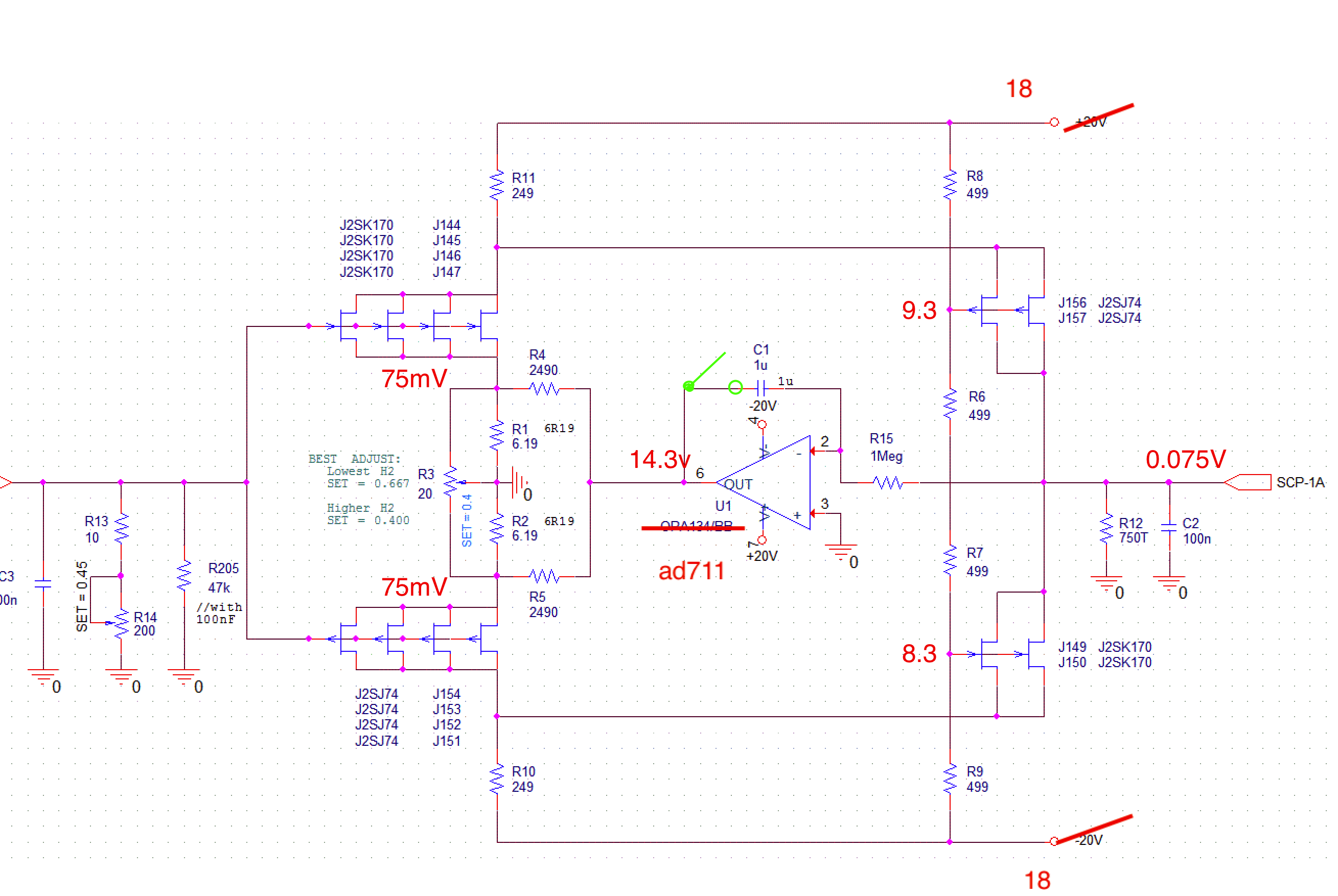

There is a problem ! There is a direct current at the start! A few seconds of a 19-volt DC then drops to 0.050.
I think the problem is in Chinese details = all parts are fake!
BUT IT PLAYS !!!!!)))))
How to overcome the problem!? I do not know

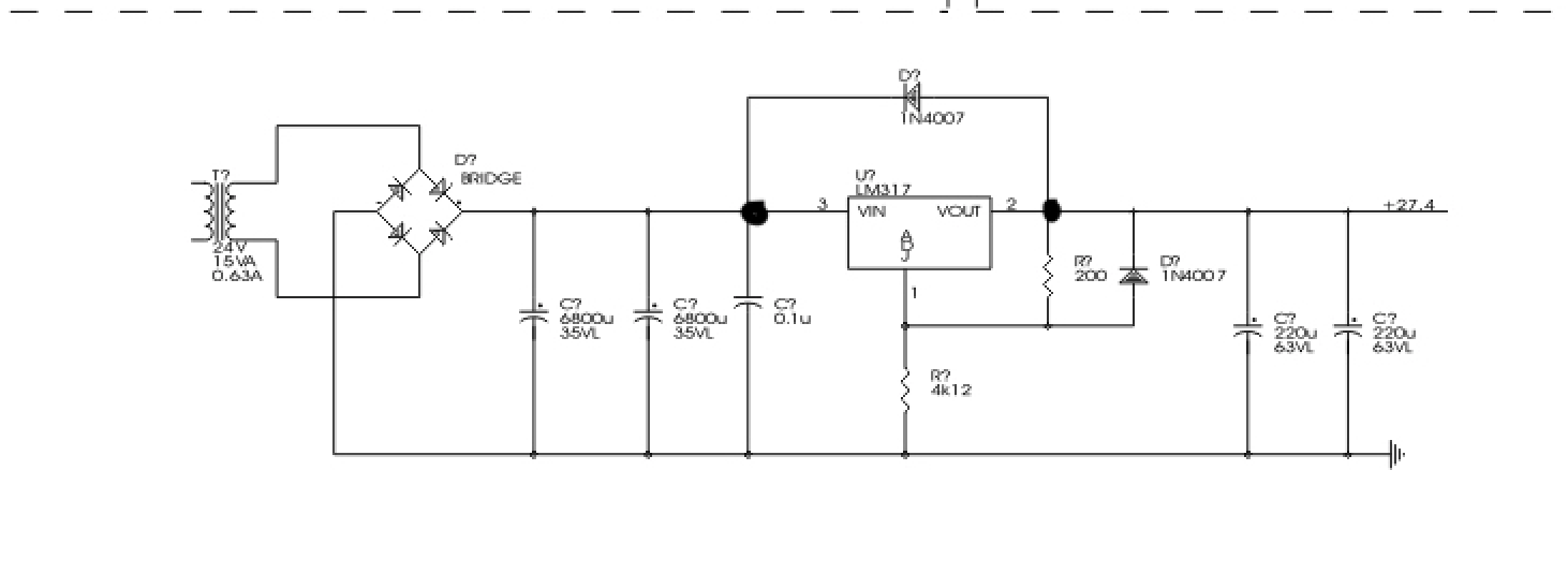

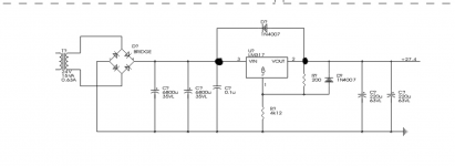

I can not understand why the AD711 chip is powered by 20 volts
schematic -EDDELARUE

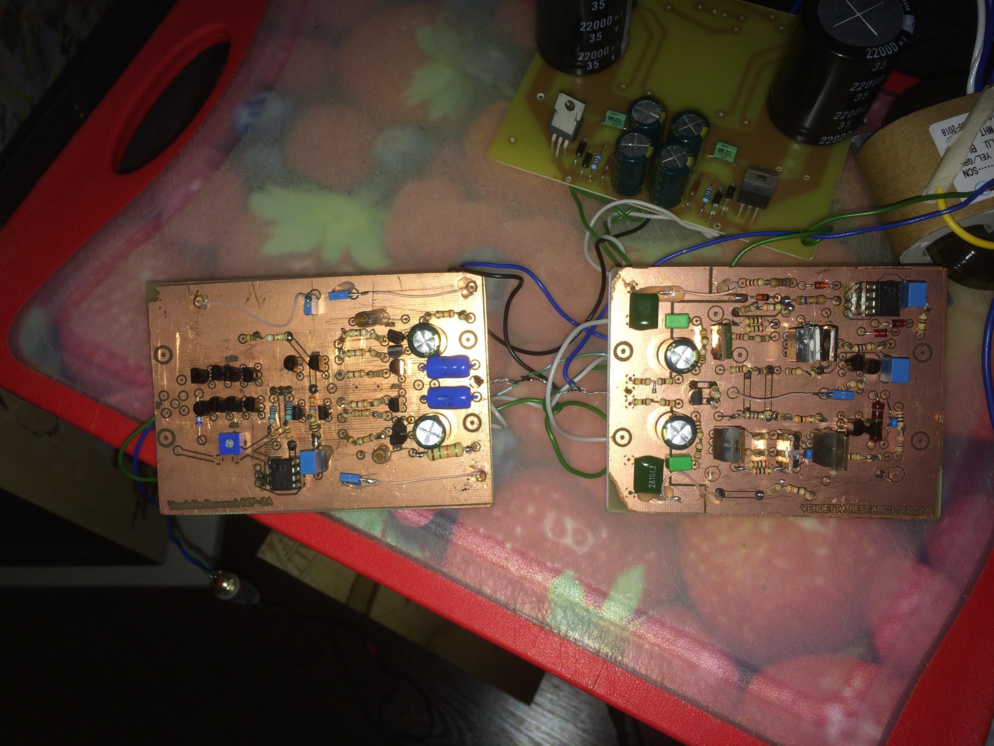

Try disconnecting the servo, to see if it still does that.
Is the output of the servo attenuated by two resistors?
1- I disconnected the capacitor from the circuit (green). The direct current of 2 volts on the first board and 21 volts on the second board at the output stood and was.
2- I removed two chips — I removed it completely from the board. DC 2 volts on the first board and 22 volts on the second board --- standing! was!
3- I put the microcircuits back --- in two minutes it slowly fell and came 50 mV. on first. and 50 mV to the second. in two minutes
4- if you measure the voltage -
1- to the mass of the input first contact + output (second board) = 20 v DC
2- the mass of the main power + output 50 mV
connect sound to the amplifier - great sound

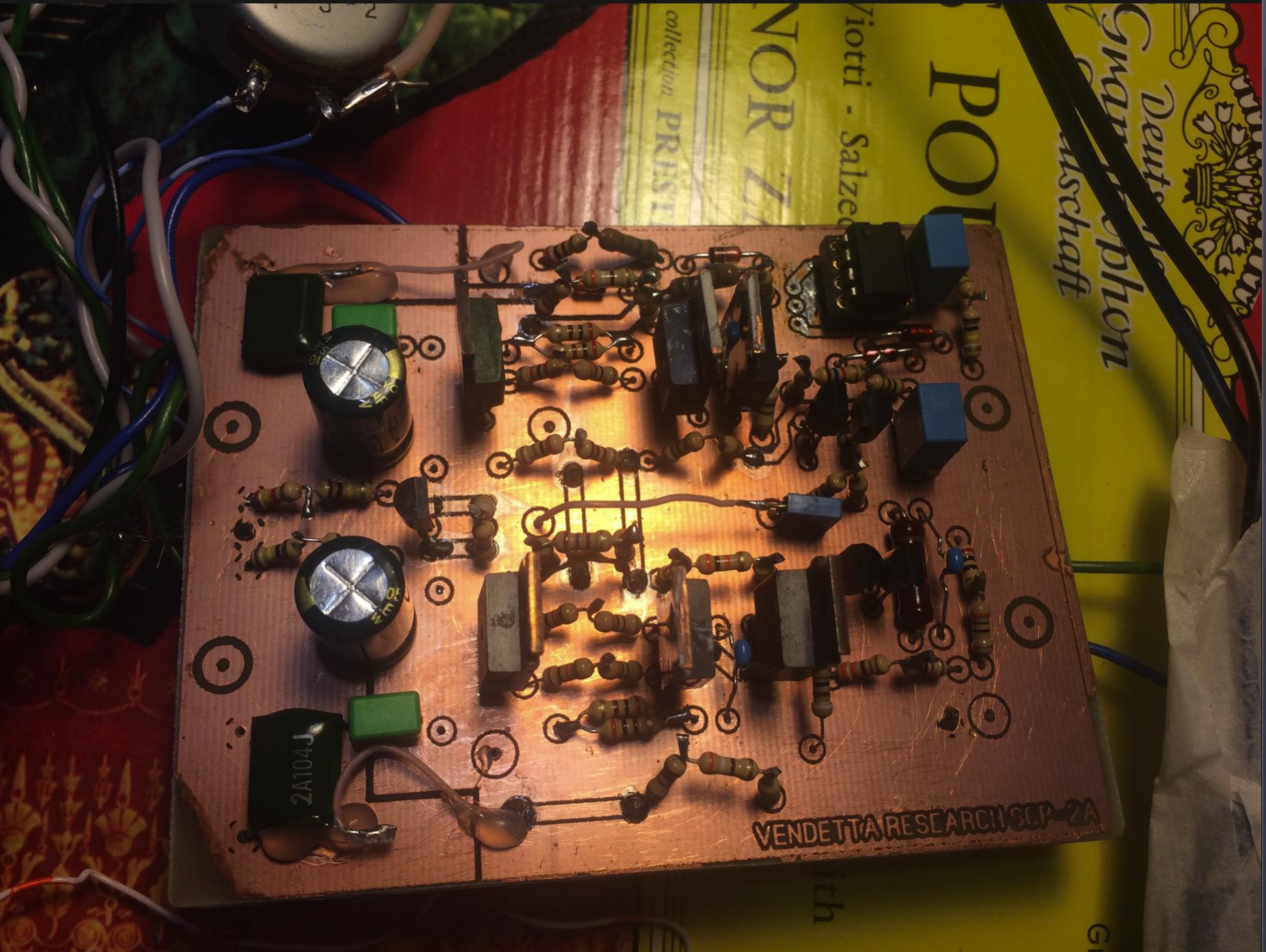

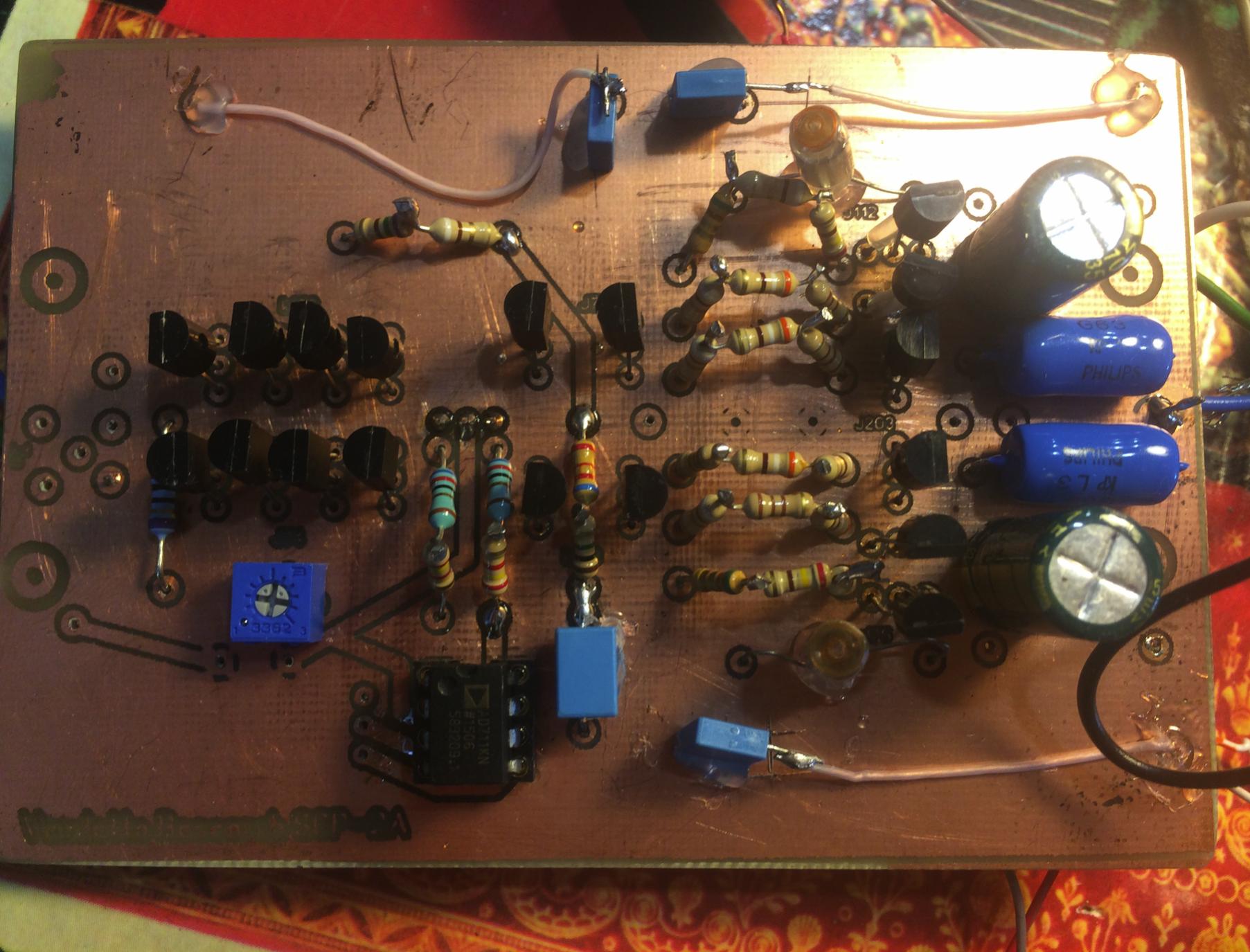

With fake parts it is not possible to build low noise phono preamps. You may attach PCB artwork for diy PCB-s for us who have genuine Toshiba J-Fets, to try.

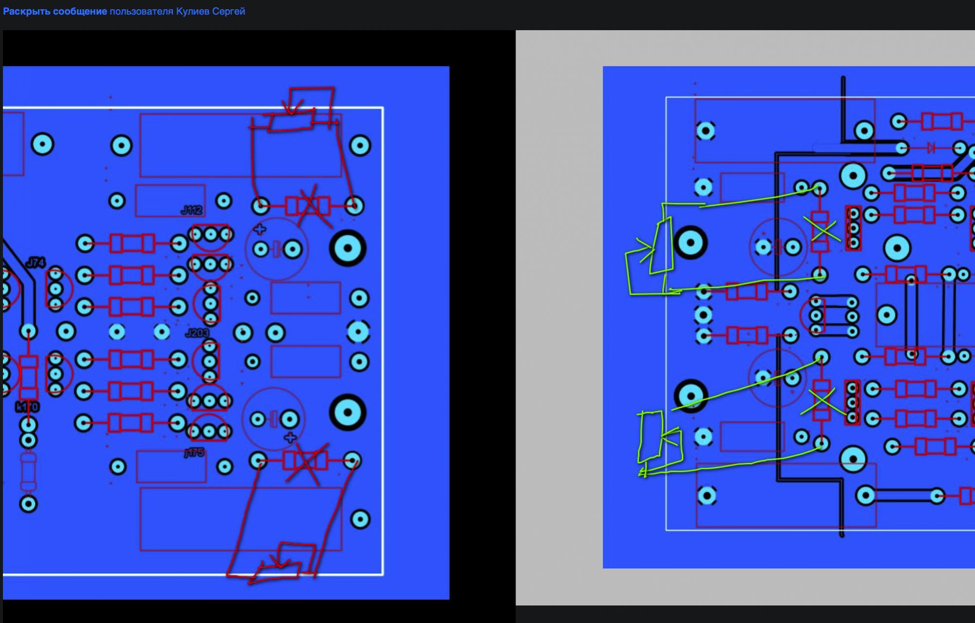

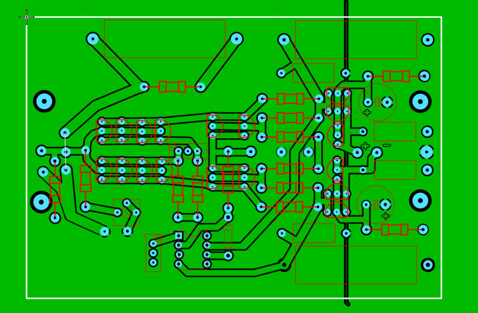

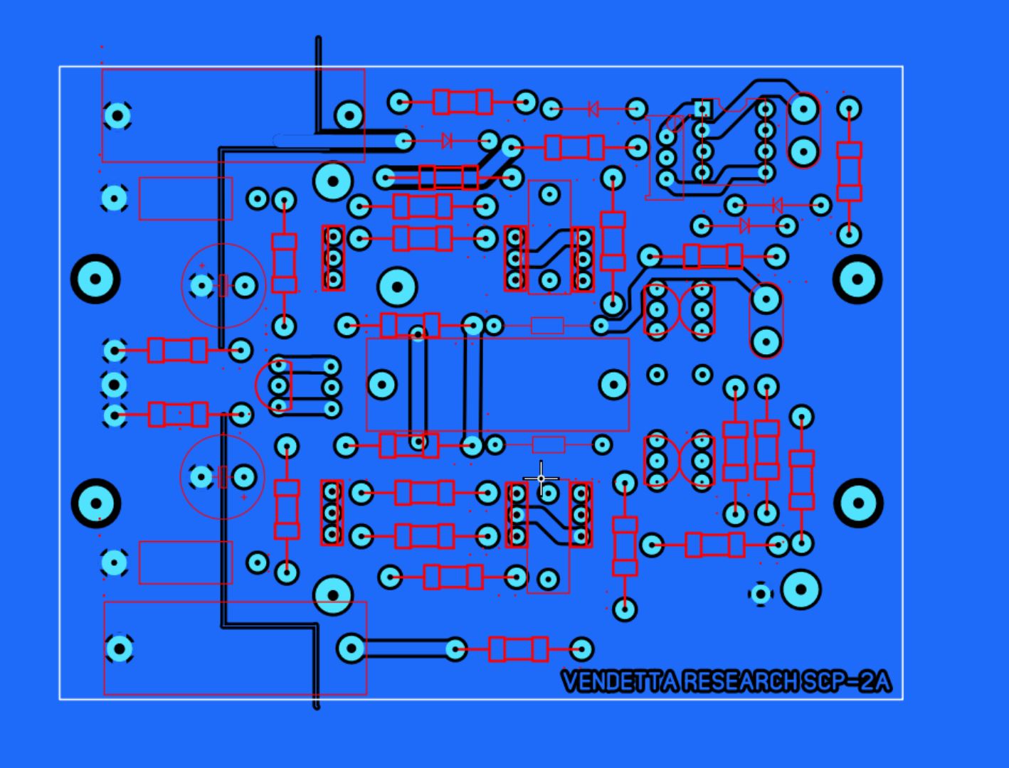

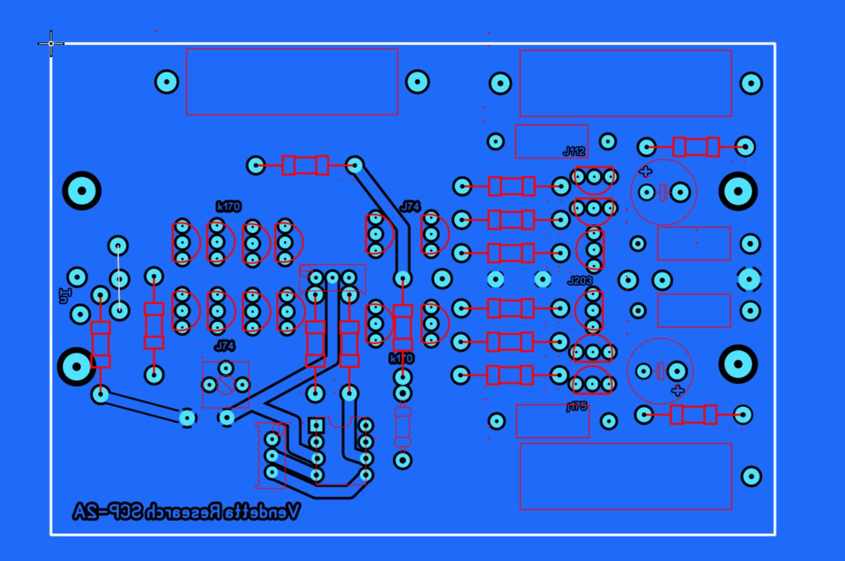

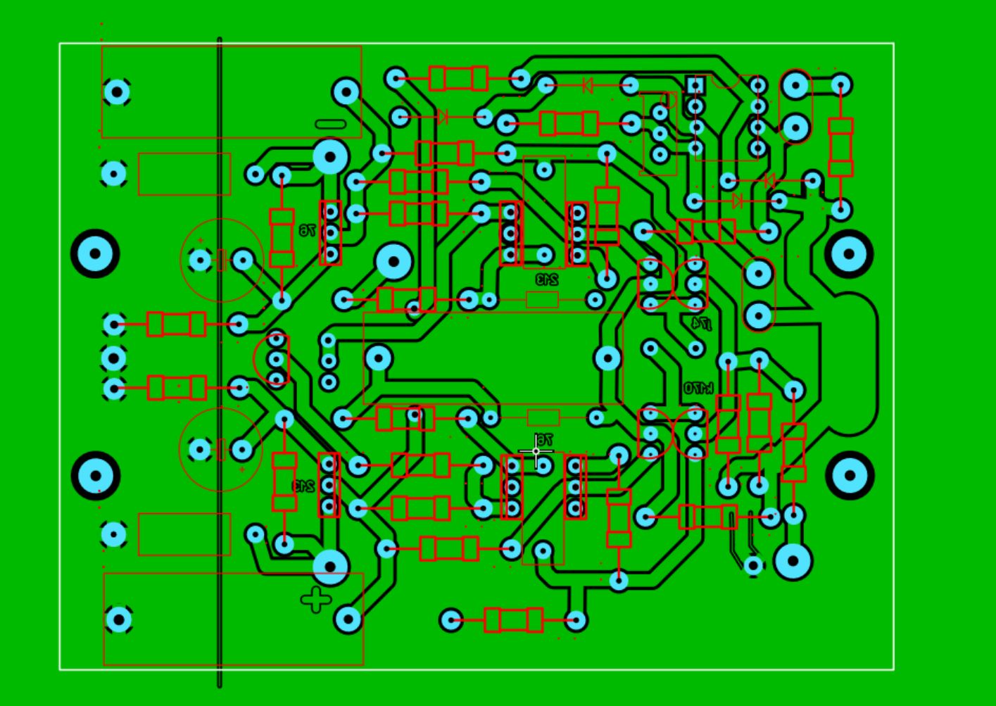

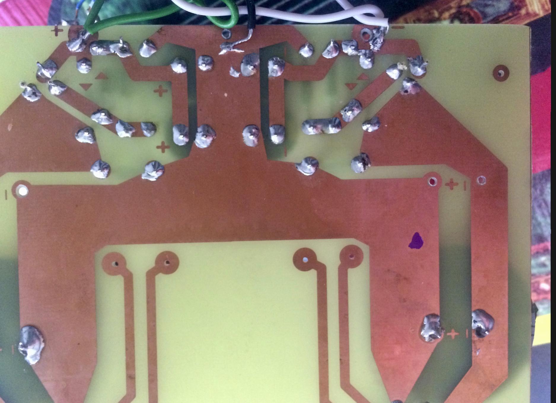

1-I'm not greedy - please- I used the schemes
EDDELARUE
2-The circuit direction of the transistors (some) is not true! carefully watch the diagram EDDELARUE
(or my photos)
3-power board remade for power scheme (there is a difference with the original photo!)
Hopefully with the original parts, this should work well! 18 volt power supply
I will wait for the results of repetition
I hope the AUTHOR of the SCHEME JOHN CURL (original) will not be offended! I took photos of boards on the Internet!
EDDELARUE
(or my photos)
