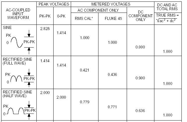

refference said:Hi vax9000 , Hi all ,
The RMS value of a half-wave rectified 120 VAC ( RMS )
is 60 V RMS ( measured with a true RMS multimeter ) .
And a lot of people saying "the voltage is halved".*
Rest assured, if the RMS voltage were halved, the power would be quartered. However, the RMS voltage is not halved, it is reduced by a factor of 1/SQRT(2), and therefore the power is halved.
I think that something is wrong with Carlos' multimeter. Why did it tell him that half wave rectified 120 VAC is 60 V RMS?
edit:
* hmmm... I think even that might be a figment of my own imagination. Oh dear, it isn't going well today. Maybe it's got something to do with it being 02:20.
I'd still like to know what's wrong with Carlos' multimeter.

Hi HarryDymond ,
NOTHING WRONG with my DMM , because it’s a FLUKE
TRUE RMS MULTIMETER model 45 ( bench top ) ,
5 ½ digits .
If you have a high-quality DMM like this , try to measure
the TRUE RMS voltage , after half-rectified , at the input
of a 50 Watts iron solder , before contest my measure .
When we are talking about AC voltage , the ONLY value
that has any interest is the RMS value , because is it that
execute the job .
My answer to the quiz , is 12.5 Watts , yet .
Regards ,
Carlos

Carlos,
You are only measuring AC component and not DC+AC component combined.
After all we have as result a pulsating DC after diode.
Measure also DC then take:
TRMS=sqrt(AC^2+DC^2)
Fluke 45 can be setup to do it according to page 45 in english manual.
I have this multimeter myself, nice instrument.

Carlos,
I was wrong about page 45 in manual, page 57-58 is correct regarding PDF manual.
You will find it here:
http://assets.fluke.com/manuals/45______umeng0400.pdf
It will tell how to set up Fluke 45 correctly for this purpose, altogether with curvforms and everything.
Did you measure according to my previous post, #48?
And...Please tell us that you will get 25W after reading manual.

Most multimeters are calibrated for RMS value of a sine wave. Clip half of it, or use a squarewave with the same amplitude, and all indications become wild guesses. It takes a pretty sophisticated mm to actually calculate the RMS for different wave forms to be correct with different so called "crest factors" which is the ratio of peak voltage to RMS. As an example, music has very high crest factors: very low RMS but relatively high peaks. So, a peak rectifier meter calibrated in RMS will indicte way too high.
Anyway, I digres. The point is that most mm are calibrated and designed with sinewaves in mind. If you have a cheap mm, that uses internal single rectification and indicates the peak value, calibrated in RMS, you wouldn't see any difference if you clip one side of the input sine. Or, depending on the polarity, your indication goes to zero if you clip the wrong polarity.
Jan Didden
Jan Didden
Carlos:
Here's the relevant part of the figure 4.3 from the fluke manual that shows how this meter reads various signals.
Examine the table closely. It says that for a true rms reading of 1 volt, you put in either a 1.4 volt (0 to pk) full sine, that same 1.4 volt sine but full wave rectified, or....a 2 volt peak half wave rectified sine..
What you are doing the equivalent of, is putting in a 1.4 volt half wave sine. So you are providing only ~70% of the equivalent voltage to give the 1 volt reading as per fluke's table. The meter will read 70.17% of the actual waveform.
Care must be taken when trying to interpret the readings.
As I stated, by inspection the answer is half power. Poobah has also calculated correctly on a lobe by lobe basis.
Cheers, John
Janneman,
I agree with you, but.....
Fluke 45 is capable of True RMS, the problem here is how he use it. Fluke can be setup to take into account DC potential or not therefore Carlos get wrong readings in this perticular setup.
Edit: Wrong readings for Carlos calculations.
