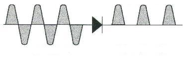

vax9000 said:Hello,
Here is a quiz about your knowledge of AC power. Suppose I have a solder iron that is rated 120VAC, 50W. Now I insert a perfect diode in serie with the iron solder. Ignore the fact that resistance changes with lower temperature. Now how much power this solder iron will consume?
jneutron said:Between 25 and 50.
jneutron said:A solution which can be arrived at by inspection is not fun at all..
A shame that you got the answer wrong then, isn't it? 😉 🙂
Assumptions:
1.) A "perfect diode" has no forward voltage drop at any forward current, and has perfect blocking characteristics.
2.) The soldering iron is not an AC-only device and is therefore not broken by the uni-directional current that will result from the addition of the diode.
3.) The soldering iron presents a purely resistive load.
4.) That "serie with the iron solder" was an accidental typo, and the O/P meant for the diode to be in series with the solder iron. Connecting the diode to the solder you are trying to melt should have no affect on the power drawn by the solder iron.
The AC voltage across the element will be halved. Power is proportional to voltage squared (for a load that is not voltage-dependant), and therefore the AC power is quartered.
For those attempting to solve the problem "intuitively", by saying "half the voltage, therefore half the power", think about it like this: what about the current? Isn't that halved too?
Half the current and half the voltage = quarter the power.
The answer to the question, given the four assumptions above, is 12.5 W.

Neither the voltage or current halves. The area under the VI curve is 1/2 the non-rectified case, the average power delivered halves.
Sorry, I thought we were joking around...
4fun: Shaded area = energy. Shaded areas per second = power.
