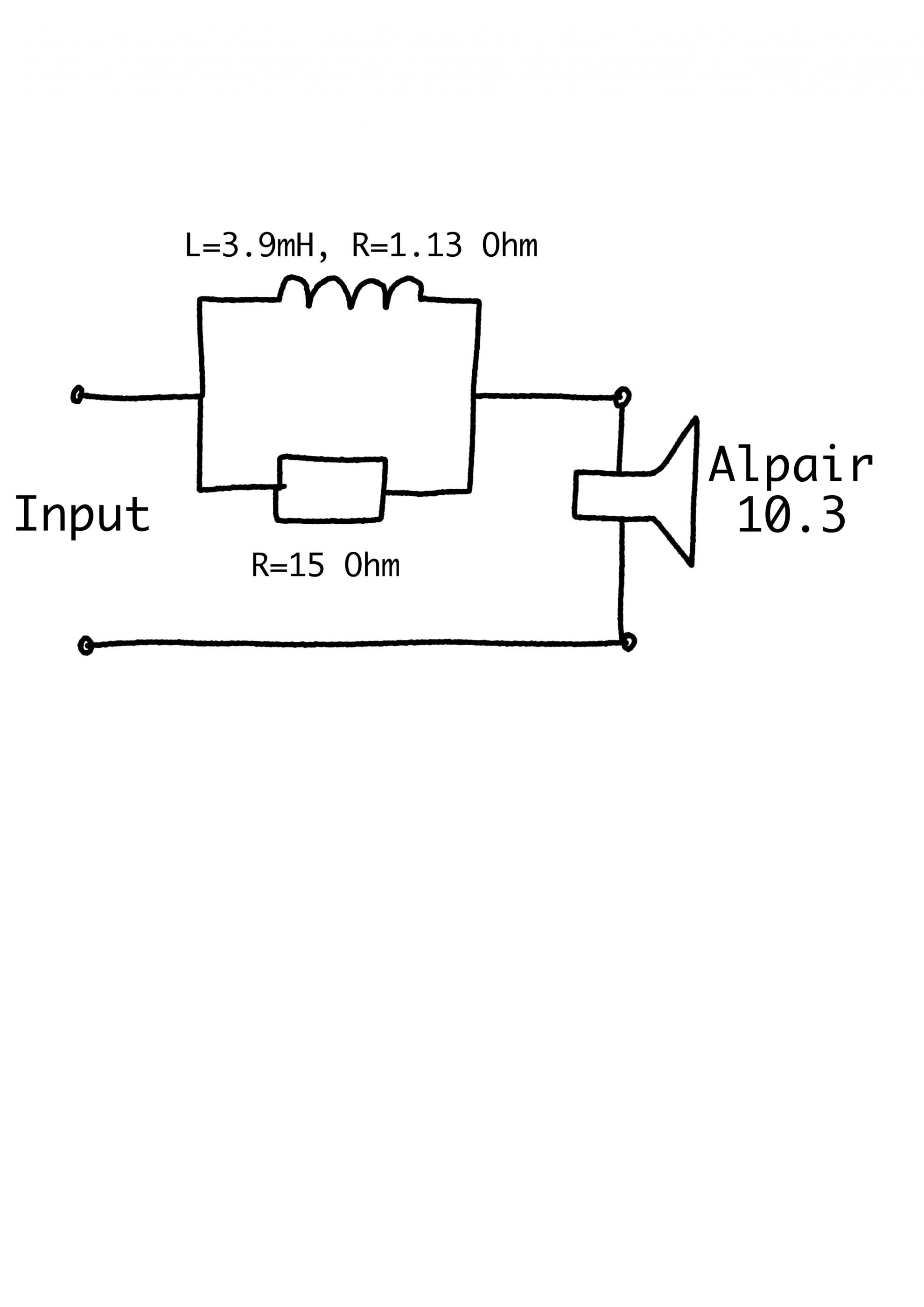

Now putting a fullranger into a small box without any sort of filter won't give a neutral frequency response as the baffle step is not compensated.
While I respect MarkAudio's attitude of avoiding filters, this simple speaker design is pretty much unlistenable as it is all treble, with little midrange and no bass output - which is exactly what happens when the baffle step is not compensated.

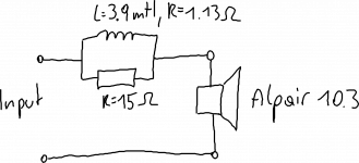

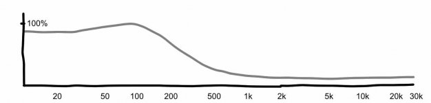

After tinkering, building and listening to 4-5 different filter designs, I settled for a very simple RL-filter which - IMHO - works very, very well giving a neutral, balanced sound. Of course with such a filter one can only burn away energy, so the resulting speaker does not excel in efficiency.
I like the resulting sound a lot and thought I would share it here, so that others can try it too.

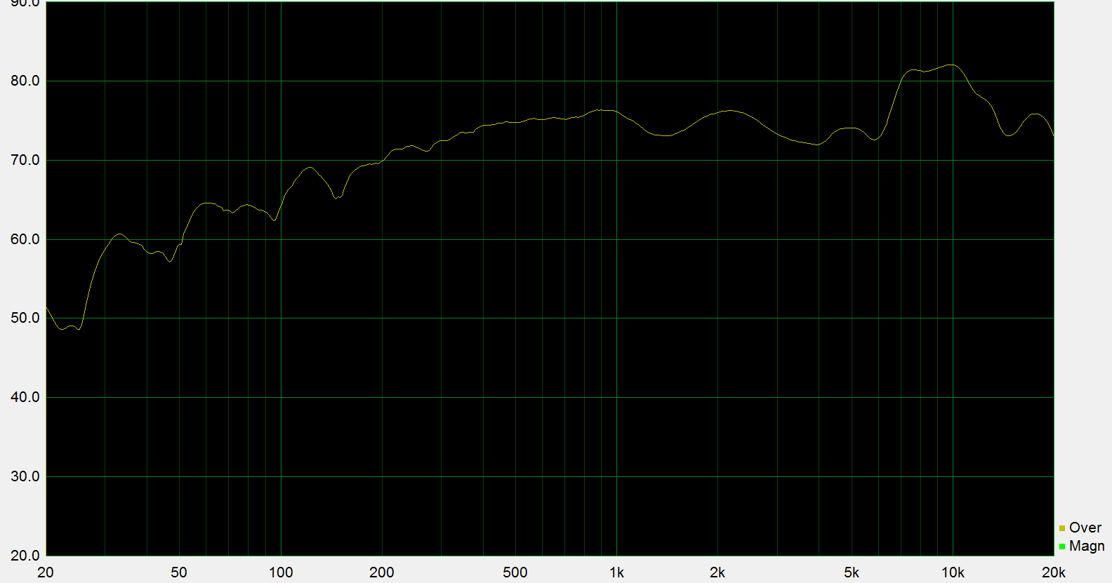

A note on bass: this speaker has decent bass output and I'm personally not missing anything in this regard. I know that the measurement might convey a different picture and one might be tempted to further attenuate mid and high range in favor for more bass.
However, my personal opinion is that full rangers should not carry the load of hefty bass output anyway. The required excursion for low frequencies doubles with every octave going down, which means that the full ranger works at least twice as hard at 50 Hz than at 100 Hz. The result is a strong increase in distortion - which can reach 10% for some transducers. If more bass output is needed I would opt to add a subwoofer and cross it with the fullranger at 100 Hz or so.

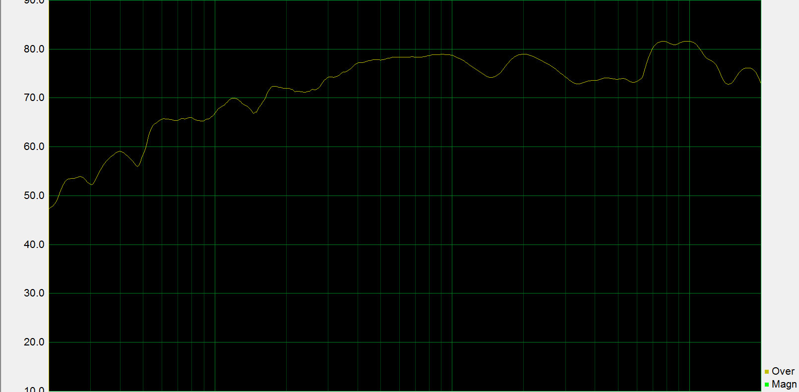

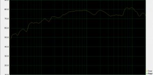

PS: attached is a periodic white noise on-axis measurement 10cm from the cone away, 50 averages taken. My measurement chain is not calibrated, so values might not be fully accurate but should give an impression.

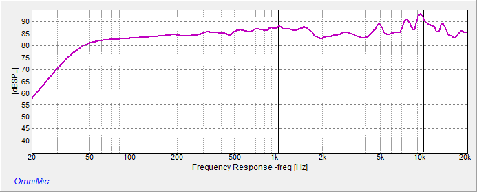

Measured 1m response of this design sans filtering below. This was taken a couple of years ago & I don't have any more data -I've lost a fair bit due to an HDD failure (Yes, I know: I should back up ;) ); as I recall it was hard splice to the nearfield @200Hz, & something like a 4ms gate window but don't quote me on that.
Hi there,
sorry if I was tipping on your toes here - that was not my intention! Great that you are also active in this forum!
Your measurements look nice - I didn't save my measurements without filter, but they certainly looked a lot different.
I suspect you did not run in the driver like is mentioned. It's very sharp when new but run it in for 100h and it becomes balanced.

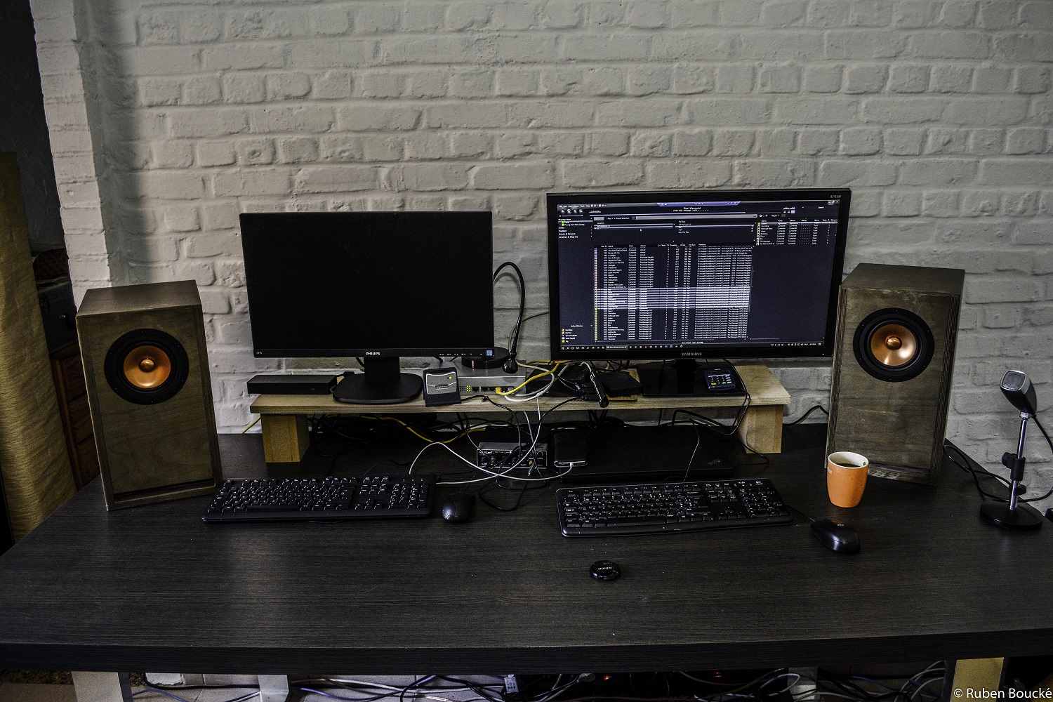

my design (including filter) is found in attachment.

I found an measurement of an early filter design where I tried a small bandwidth notch filter - it is not fully without filter, but the filter has only a limited impact in a narrow frequency range.
It can be seen quite clearly that midrange output steadily decreases from 400Hz or so downward. Also there is a strong almost 10dB peak at 10kHz.

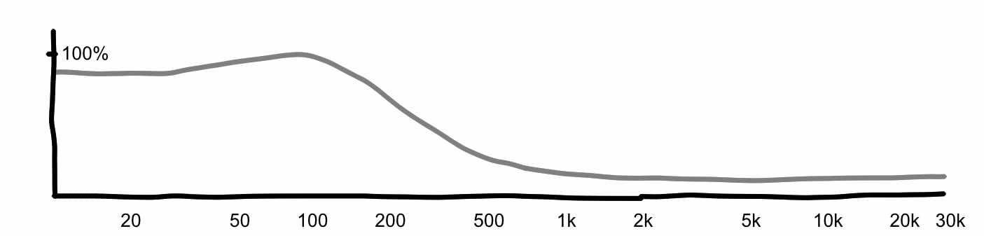

There might be a small misunderstanding here - I understand running-in this driver might be particularly important.
However, the filter I posted is not a small, detail correction (like a notch) - contrary, it is a MASSIVE correction, it is a low-pass shelving filter, starting to attenuate the driver above 100Hz and attenuating everything above 500Hz to about 30% of its original value - see attached transfer function.
This is a fundamental manipulation and I cannot imagine that running-in the driver is able change all of this.
As many of you are apparently very happy with this speaker without any filter, I can only assume that mine are out-of-spec or something like that.
