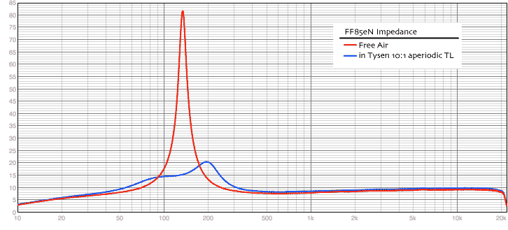

The attachment is an example of Planet10s Tysen speaker. It was a Fostex FF85KeN that had an Fs of about 130Hz and presumably a small Vas. The Pluvia 7 has an Fs of 67Hz and a Vas of 5.54 litres. Does this mean that the line would need to be considerably bigger in length and volume to get a similar flattening of the impedance?
Yes. They have a similar effective Q, but having a higher Vas and lower Fs, the Pluvia 7 requires a larger line for equivalent results. Which is not to say you will get terrible results in a smaller pipe (it might be, it might not, depends on the pipe), just that they aren't equivalent, and there is by definition more compromise.

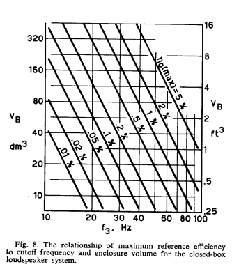

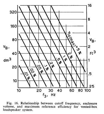

What folks tend to overlook WRT TL/horn design is that they are just odd shaped boxes, which takes 'x' amount of volume [Vb] to get 'y' amount of acoustic efficiency regardless of its shape, so less is always less as shown by Small's nomographs:
GM
Bearing in mind that efficiency of the low frequencies are unneeded, they will be filtered off. It's the impedance flattening that is desirable in order to make it easier for a 1st order xover. If I can reduce the Z somewhat and reduce it further with a parallel R across the drive unit that may suffice.
That may, or may not be the case depending on how far you compromise it, what your acoustical crossover frequency and orders are, and how much air-load you are placing on the moving components. If, for e.g., your target 1st order is relatively close to the acoustical rolloff of the driver on that baffle & in that pipe, you may end up with a higher order slope than you intended. Now, if you're fine with that and have confirmed the other aspects are not going to be problematical, you're bobbing. If not -be careful trying to reduce too far.

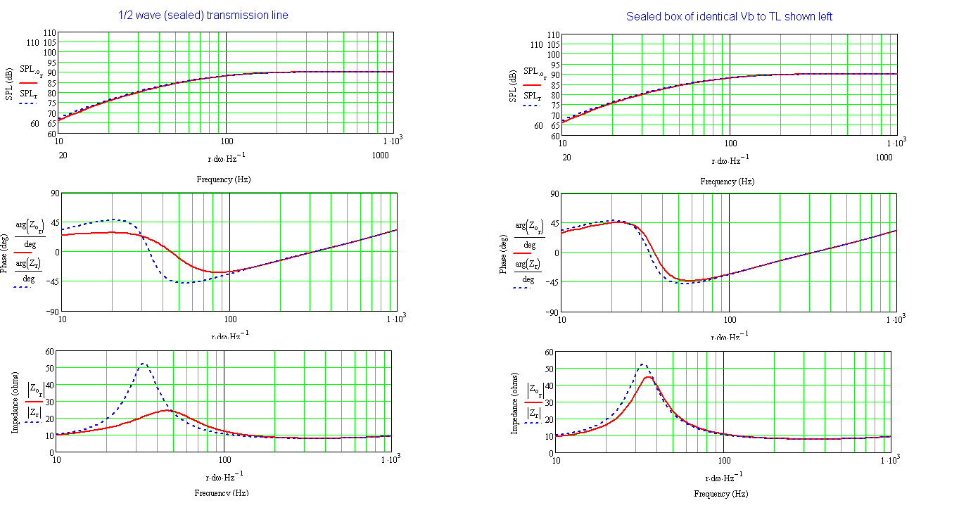

I found this other thread which ended almost 10 years ago to the day which goes into quite a bit of depth on the subject. Including a great pic from Scottmoose.
Closed end TL experiments, impedance flattening
I assume an open ended TL would give similar results to the closed one simulated.
