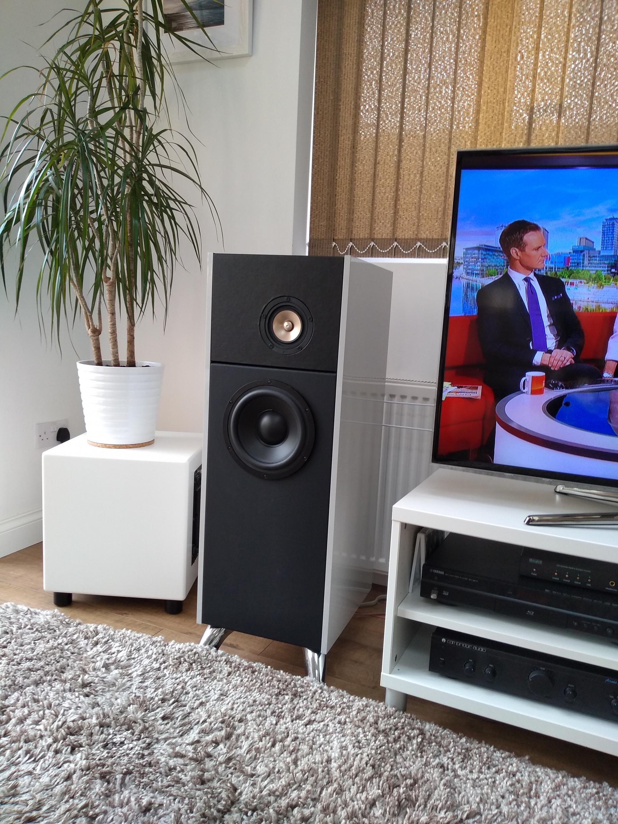

A question about mid-tweeter transmission lines.
Have you considered going active, it would make the speaker design much simpler and more easily controlled?
Yes, I have dabbled with active in the past. But I wanted to give passive a go. I recently purchased a new amp, Cambridge Audio CXA60 which has a built in dac a remote control and a pre-out. The remote control gives a certain higher WAF factor. The pre-out means I could use it as a pre-amp with active xovers or even a combination of the two, making use of the power amp part with a high level passive filter and a low level filter feeding into another amp. Lots of dabbling to do.😀
The other advantage I'm looking for (actually the main advantage I'm hoping for) is a reduction of reflections through the cone which is advantageous regardless of xover type.

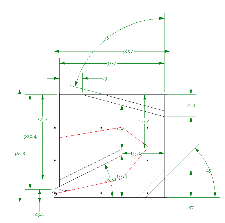

I am late to the thread, but as an adovcate of midTLs i should add my bit.
Whhat Scott says proves to be pretty spot on. Tapering the line is a benefit. We usually try for a 10:1 taper and integrate the midTL into the box with the bass drivers. A spearate box on top gives more versatility.
The goal is to lose all of the back wave and flatten the impedance (giving independance of amp choice).
Our 1st was in Tysen V1, also used in Tysen V2, Ellppsa (apologies to Sonus Faber), the Facets, and the big A12pw MTM. We have built those, i have drawn many more.
A heavily tapered midTL can be built into a simple rectangular box with a single partition.
attachment.php
This is an early work (midTL for Feastex IIRC). The deflector panels turn out to be unnecessary, and except for the bracing added, add nothing to the box.
Scale th econcpt to the size you need, as long as total volume hits the target Scott suggests.

A short conical TL sealed with stuffing progressively dense towards vertex works great as an acoustic black hole.
X’s dagger is a good design for a closed midTL. It should be 2x as long and at least the same volume. It will model as sealed. I prefer the low pressure of a quarter-wave TL so that the back wave affects the front as little as possible.
