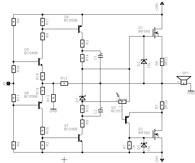

A push-pull differential stage- why not?
> Another non usual topology. What does it do?
Makes 50 Watts in 8Ω. Good if you can hear 1MHz.
T1-T8 run Class AB. They give voltage gain to the FET Gates. Source resistors unbalance the current mirrors.
I can't jot the bias or performance without knowing the properties of R17 R18. ("3cm resistance wire..." isn't enough.) But guessing:
At high current the whole T1-T10 chain runs in transconductance mode: input voltage sets output current. Special features are that: Beta can be very low, meaning performance is little changed up to nearly Ft; FET Gate capacitance is strongly driven and does not dominate response inside the audio band. Somewhere above 1MHz the declining Beta and Gate impedance makes the whole thing run out of steam quickly.

this 2 diodes seem to be not enough for 2 times Vbe voltage drop, so the input stage may work (depending on transistors) in push pull class A through AB, B to C.
you MUST use more diodes vith bjts in diffy..
also it seems hard to adjust biasing and nothing seems to preserve output mosfets fromturning off.
Also the purpose of opamp is ?????
I don't understand it - it is weak or as brilliant as I cannot imagine
> How can T3 and T4 form properly current mirror, if one has R17, and the other has emitors straight to rail?
I did say, didn't I, that it was "unbalanced"? Mirror ratio is 1:1 minus a function of output stage current. This gives negative feedback. It appears that output stage current is a function of error voltage. Also the unbalance vanishes at small output stage current, so the output devices are not driven hard-off.
Another (poor) current mirror. ASSuming that junction size is similar, diodes and BJTs (approximately type for the types specified) then T1 T5 current is similar to D1 D2 current. D1 D2 current can be trimmed with RV1 RV2. I assume these are trimmed for some small voltage across the 10 ohm resistors.
It will never run Class C (except in gross overdrive) and won't stay in Class A well. It is clearly intended to run in Class AB, probably with a few dozen milliVolts across the 10 ohm resistors at idle, and maybe 50mA peaks to whang the FET Gate capacitance.
The output stage T1-T10 makes good power and bandwidth, but has low and very variable input impedance, wide swing in input current, and voltage gain around 5. THD is low for a power stage but higher than we might want. DC error is non-negligible. For a complete hi-fi amp we want more gain, higher impedance, and (in best 1980 thinking) more global feedback. The opamp does that.
> i think R17 ,R18 give a temperature stable for mosfet.
FET tempco is completely inside feedback. Output stage hot-up can't cause thermal runaway. RV1 RV2 offset the BJT quad which forces a correcting offset across R17 R18, fixing output bias current. The BJT quad has large tempco which is first-order corrected by diode tempco. Diodes and BJTs should be thermally coupled.

How about this push-pull input stage? It probably doesn't work but it might be fun to look at it.

Have you ever used (or considered😀 ) something like this ?
seems to cancel some distortion compared to CFB, doesn't it?
Yes, except that I do not use D3-D10, but have 100R from the feedback point to rach LTP transistor, and 100R from input to each LTP.
The basic idea is the same, though, and it works great for me. 😀
