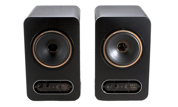

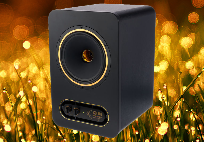

I have to apologise, I did a quick search and got as a result the Tannoy Gold 7/8 - but not described as Gold (though the obnoxious 'design' should have obvious, since it visibly said "Gold 8"). I don't know how that happened because after your replay I was confused, searched again today and it did not show up with the same picture of the speaker. I'm really sorry.
That's the speakers I saw yesterday:
Yes the latest Gold monitors are strange. I believe the drivers are good and they play loud etc but being assembled by Behringer I think quality suffer, like port noise and lose plastic. Cannot be compared to the old 800. I have S8LCR myself I believe are the same as 800 series which again is similar to Profile 636, definition 500 etc I really like this driver.

Oh yes their latest models!
My cousin just bought a pair. So far he like them ( nearfield project studio). I agree the box seems lower grade than what they made before. I have not heard them yet. Maybe later this year.
That said if the driver is based on their previous generation (revolution xt) it should be good. Some members here praised the 6,5' from this serie.

I agree, the Behringer influence was quite a step back in some regards. Okay, they've made the speakers cheaper but I don't like the look of them, not one bit. Yes, the Behringer stuff works and the bad image of the past (mostly for being unrelyable) does not apply anymore. Their new synths are really good, the PA stuff works and is cost effective. But seeing these Gold speakers, I've got the distinct impression they want to use the Tannoy name for cash grab. Okay, I haven't heard them, maybe they sound good but I expect something else from speakers from Tannoy. Maybe it's just me (getting old I'm afraid) but I'm disappointed.
