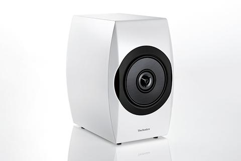

Technics had the RX-50 and RX-30 coaxial speakers in the 80s, they sound excellent, very good dispersion because of the flat membrane drivers. I always wanted to buy these, when I had the money there were none available and vice versa. 🙁

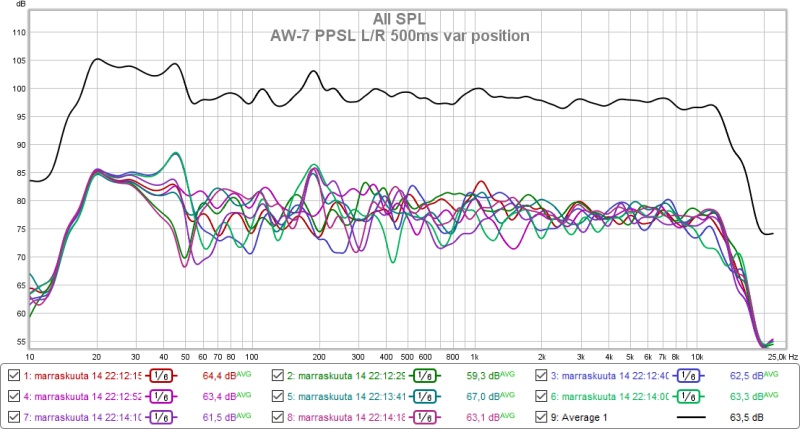

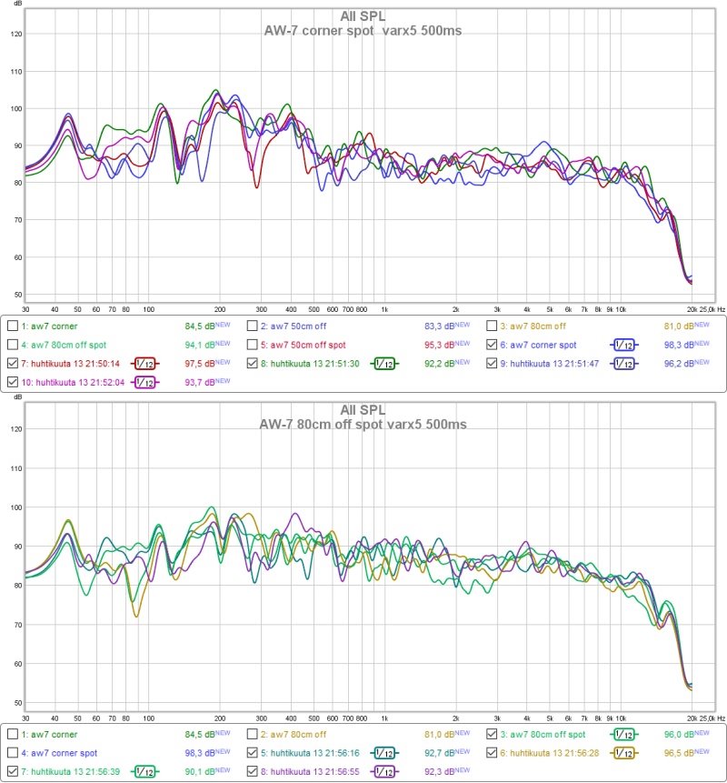

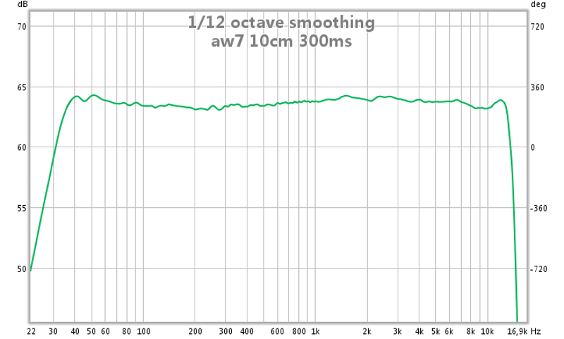

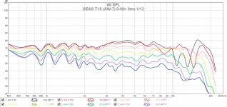

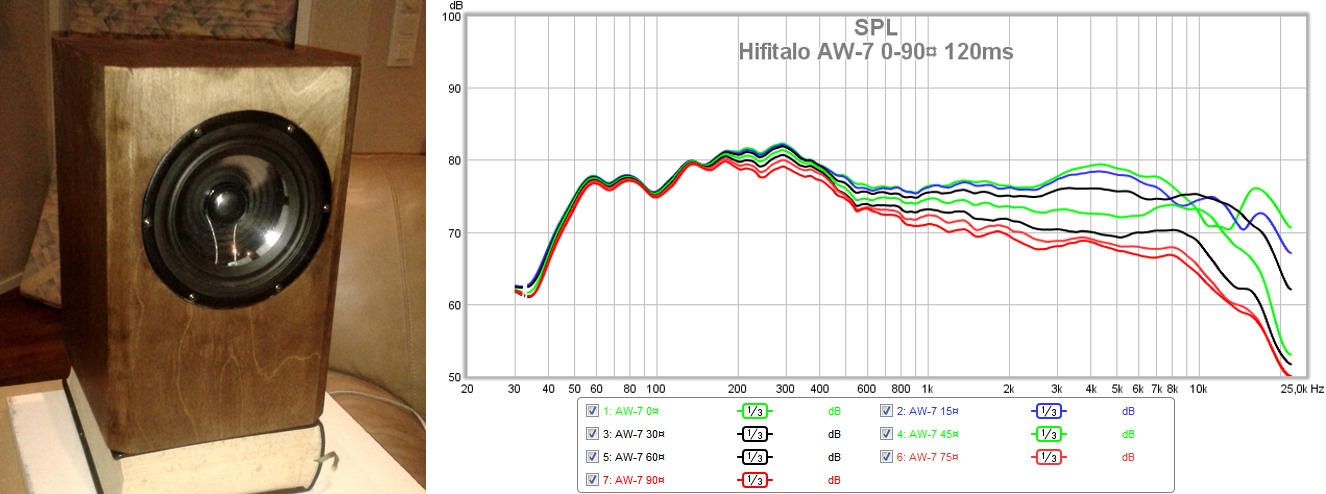

SEAS T18 coaxial in closed box
Uhm, the hunch from 140-500Hz is very dominant, that's 5dB!
The 30° (the first black one) measurement looks the best, quite linear.

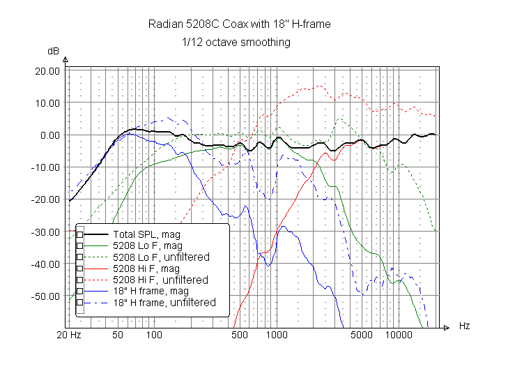

I recently completed an open baffle project using the Radian 8" 5208C coax, along with an 18" H-frame to extend the bass. Overall sound is quite good.So, best coaxial "smoothness" can be realized only with less than 10" woofers. Which will easily lead to a 3-way construction or one must have a subwoofer at least.
It took a fairly extensive (passive) crossover to tame the raw driver responses, but the end result has excellent phase alignment through the crossover regions.
More of the gory details can be found on posts 79 and 80 on this thread:
That measurement was done with a very poor mic. Hump in bass is an artefact, but you could see the speaker. Some better indoor measurements here. It is a kit speaker, Hifitalo AW-7 and I use minidsp 2x4HD to EQ it and highpass LR2@90Hz to a 2x15" closed box subwoofer (third measurement).
Ah, thanks for the information. It was probably the room influence then.
