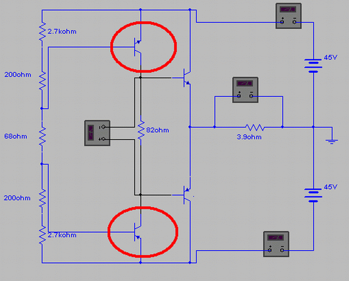

the resistor in zobel is cold, osciloscope did not show anything... it was going nicely all the way to the 100kHz and above nothing.....crazy thing....
i will recheck when i dismount the board.... and than i will let everybody know.... 🙂 thanks for helping Karl... now you know why i am so confused and why i can't figure what is going on.... hehhehehe

Hi, Final thought, if you are relying on fixed bias resistor do be careful, it would be so easy to over bias particularly on testing, and a few 10's of mv too much could fry the outputs. Use the 60 watt mains bulb trick untill you get it sorted. I think if it were me I would initially replace the bias network with a pot (say 470ohm) and make sure you can swing the bias current smoothly from zero upward, or more correctly that your voltage at A/B varies smoothly from zero to about 1.5v at which point the outputs should begin to conduct.

IT IS WORKING!!!!
i am stupid idiot.... that is what i am....
i didn't noticed that i forgot to solder base and emitter od the negative driver transistor......
as Carlos said - assembling error.....
it is working like a charm.... - going on a second channel - now, i bit smarter 🙂 heheheheheh
the schematic is original as i intended - with two bjt's and a trimmer in their base....
