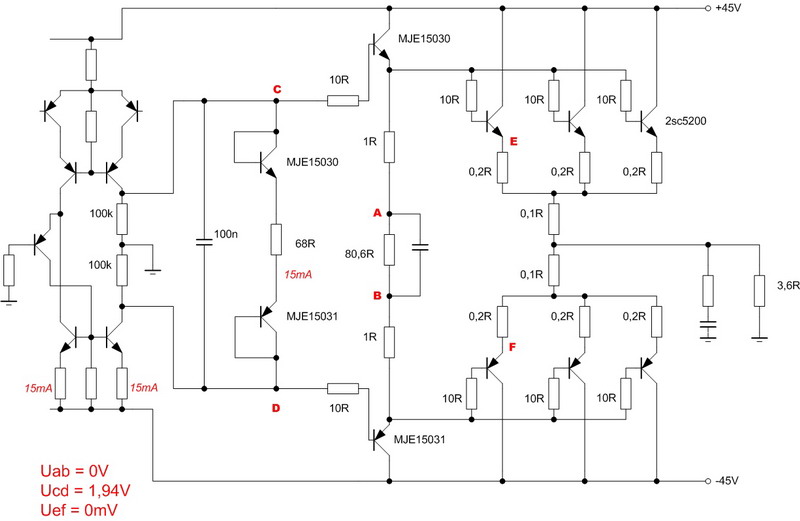

Hi, Final thought, if you are relying on fixed bias resistor do be careful, it would be so easy to over bias particularly on testing, and a few 10's of mv too much could fry the outputs. Use the 60 watt mains bulb trick untill you get it sorted. I think if it were me I would initially replace the bias network with a pot (say 470ohm) and make sure you can swing the bias current smoothly from zero upward, or more correctly that your voltage at A/B varies smoothly from zero to about 1.5v at which point the outputs should begin to conduct.

IT IS WORKING!!!!
i am stupid idiot.... that is what i am....
i didn't noticed that i forgot to solder base and emitter od the negative driver transistor......
as Carlos said - assembling error.....
it is working like a charm.... - going on a second channel - now, i bit smarter heheheheheh

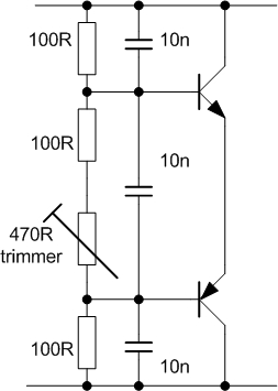

the schematic is original as i intended - with two bjt's and a trimmer in their base....

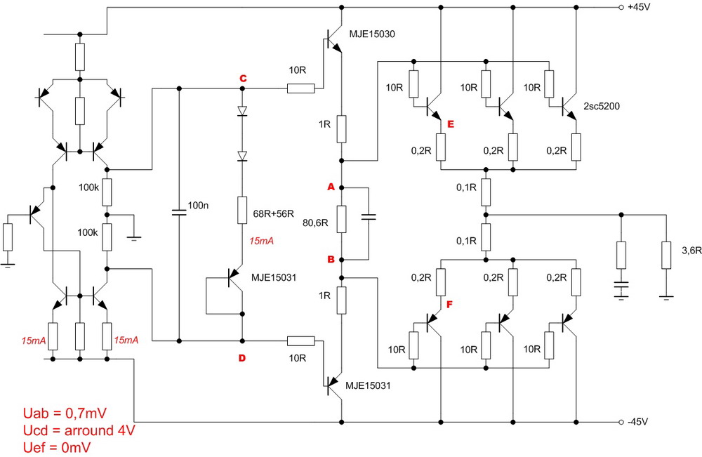

- a problem - no bias current
