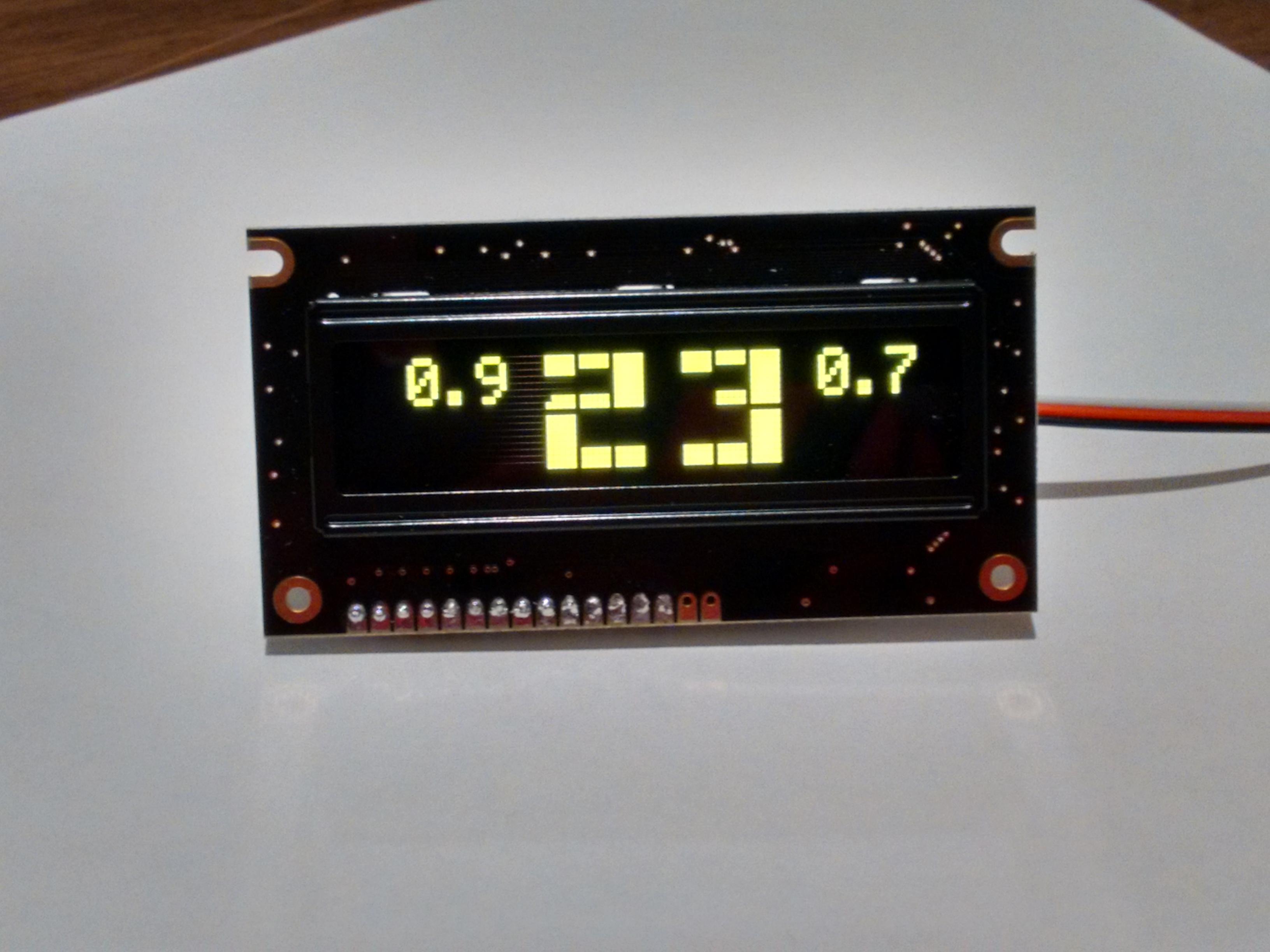

The OLED just got even better -- with improved readability across the room and display dimming.
The Volume number is now two rows high, and very readable from across the room. The milliamp display and the balance display remain one row high and everything can be displayed at once. The Calibration screen and the Balance adjust screen and the screen saver screen have not changed.
In addition, about 90 seconds after the last control input, the display will revert to 'screen saver' mode AND dim. With these two protective features in place it's going to be a long time before this display shows any degradation from burn in.

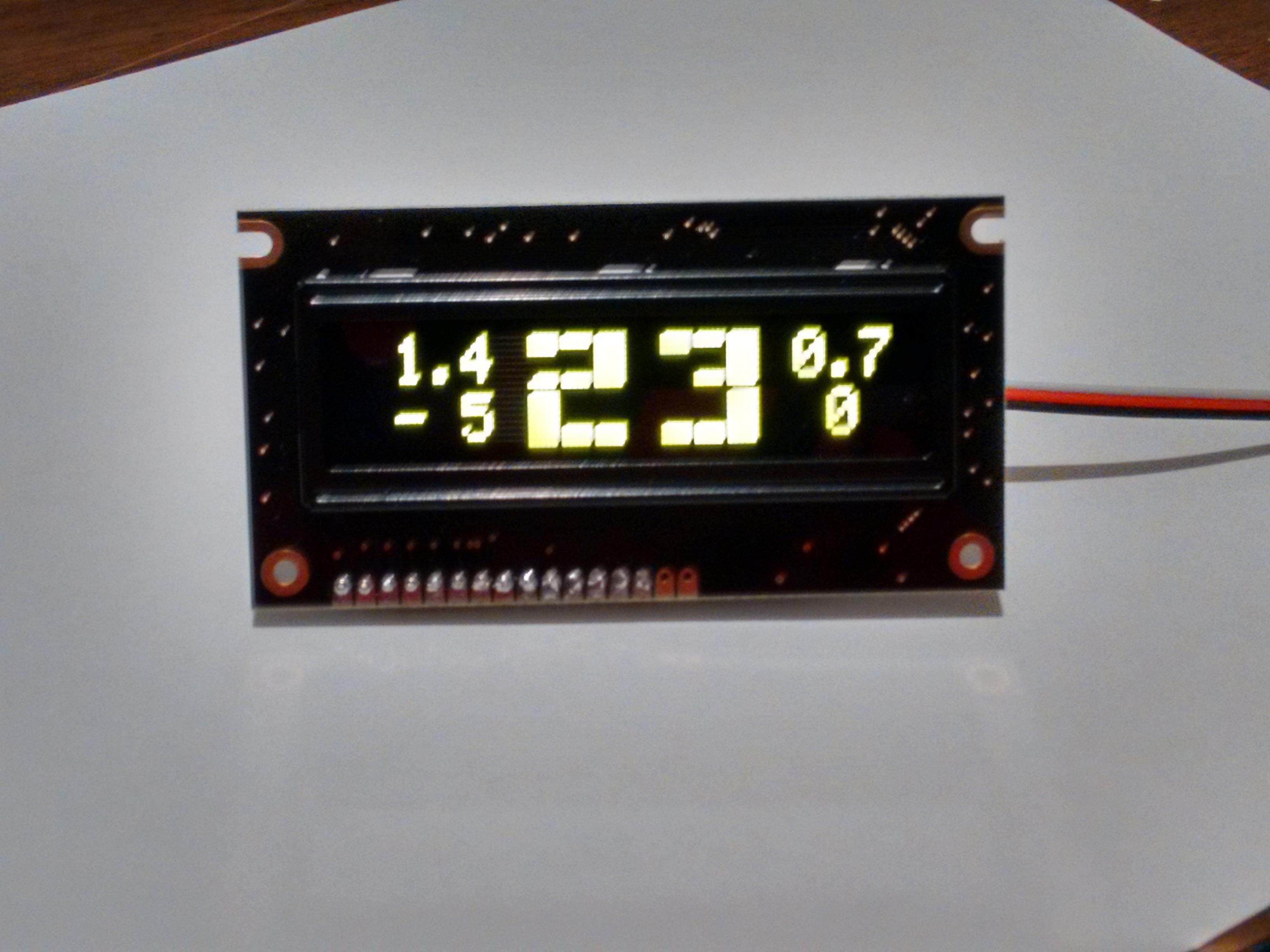

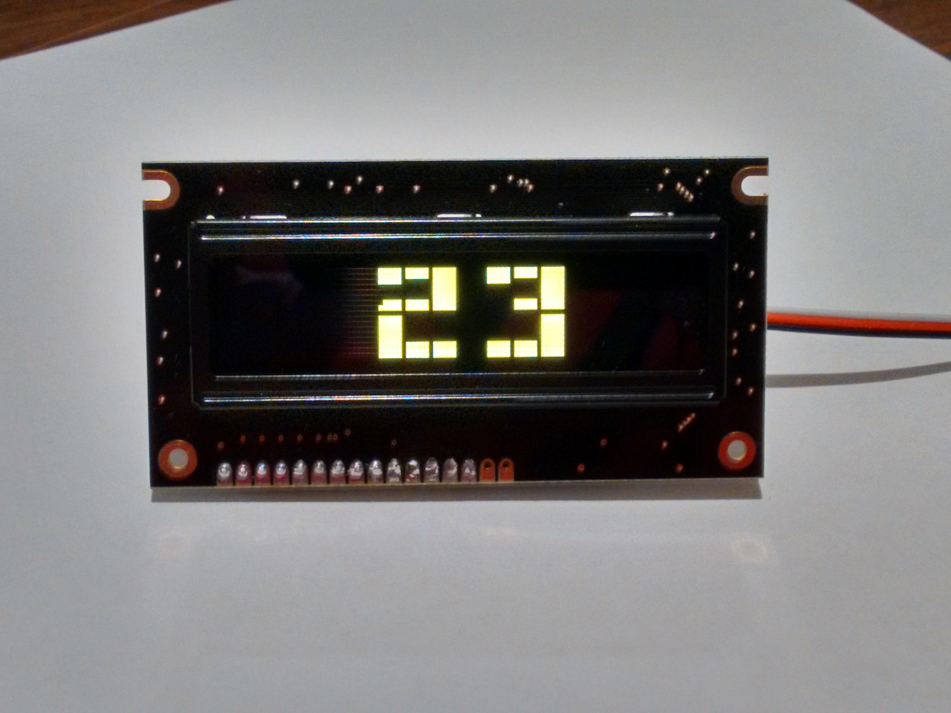

Here are images of the latest display configuration. Note that the milliamp values between channels is very different -- because the balance is shifted to the right (lower volume = higher current).
