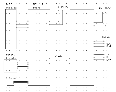

I will sell the pre-assembled boards with all components installed, and the two-line OLED display. All that is required is for the user to connect the boards together -- all the boards have .1" screw terminal strips -- and you mount them as you wish with audio connections and 9~16VDC.
The connections are very simple as shown on the attached drawing. The OLED is not necessary, you can manage the setup by interpreting the simple LED.

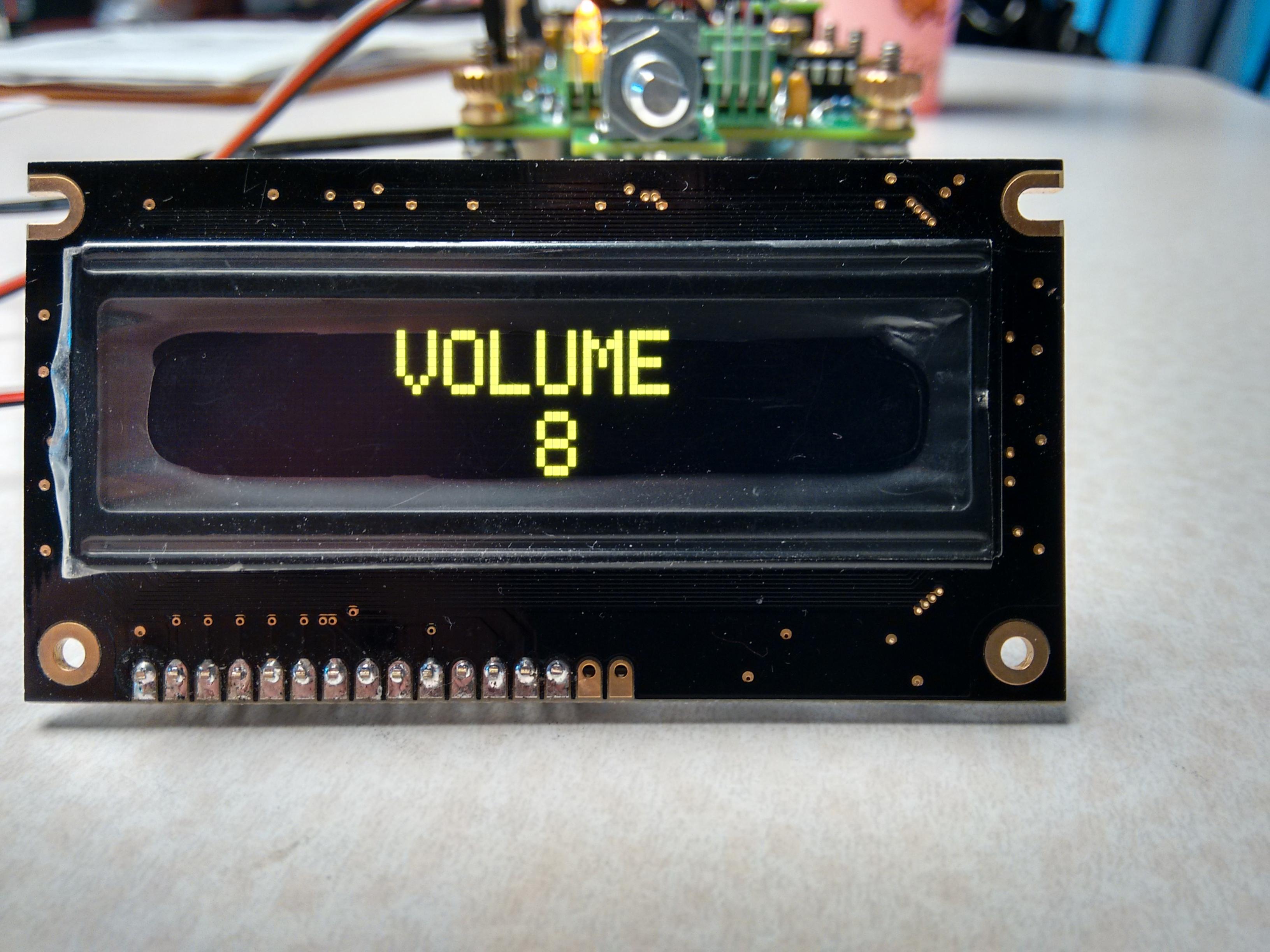

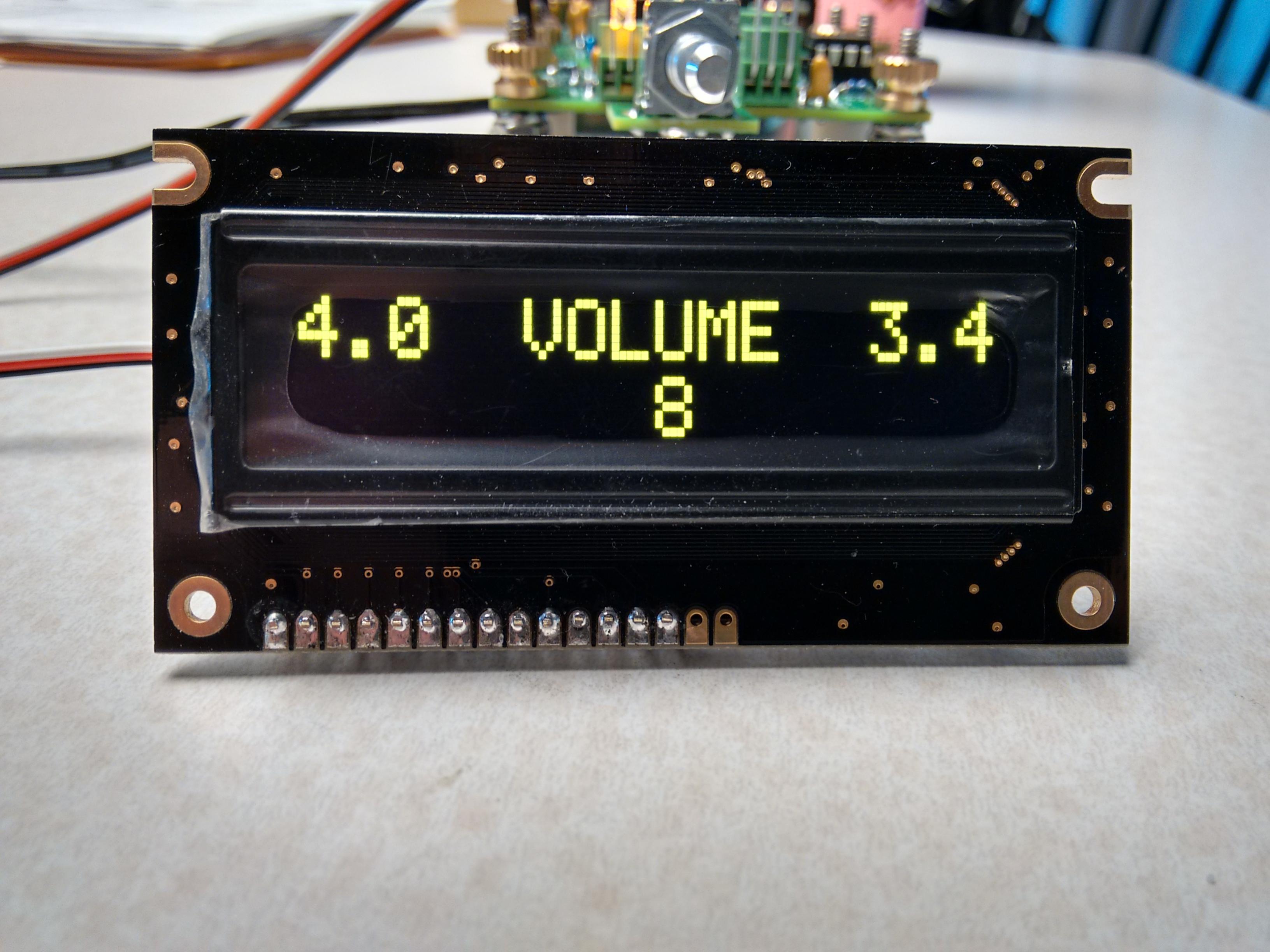

The volume display with, and without, displaying the current flowing through the shunt LDRs.
Notice that the currents are quite different -- this is because the LDRs were not closely matched before installation and therefore are drawing different currents while delivering the same resistance. This is the key advantage of PIC-controlled LDRs.
The volume levels are from 1 to 99; level 8 is fairly low level and therefore considerable current is flowing through the shunt LDRs. At midrange and louder, the display will show "< .1" which means that each LDR is drawing less than one-tenth of a milliamp. Resolution and control at the lowest currents is typically +/- 2 microamps.

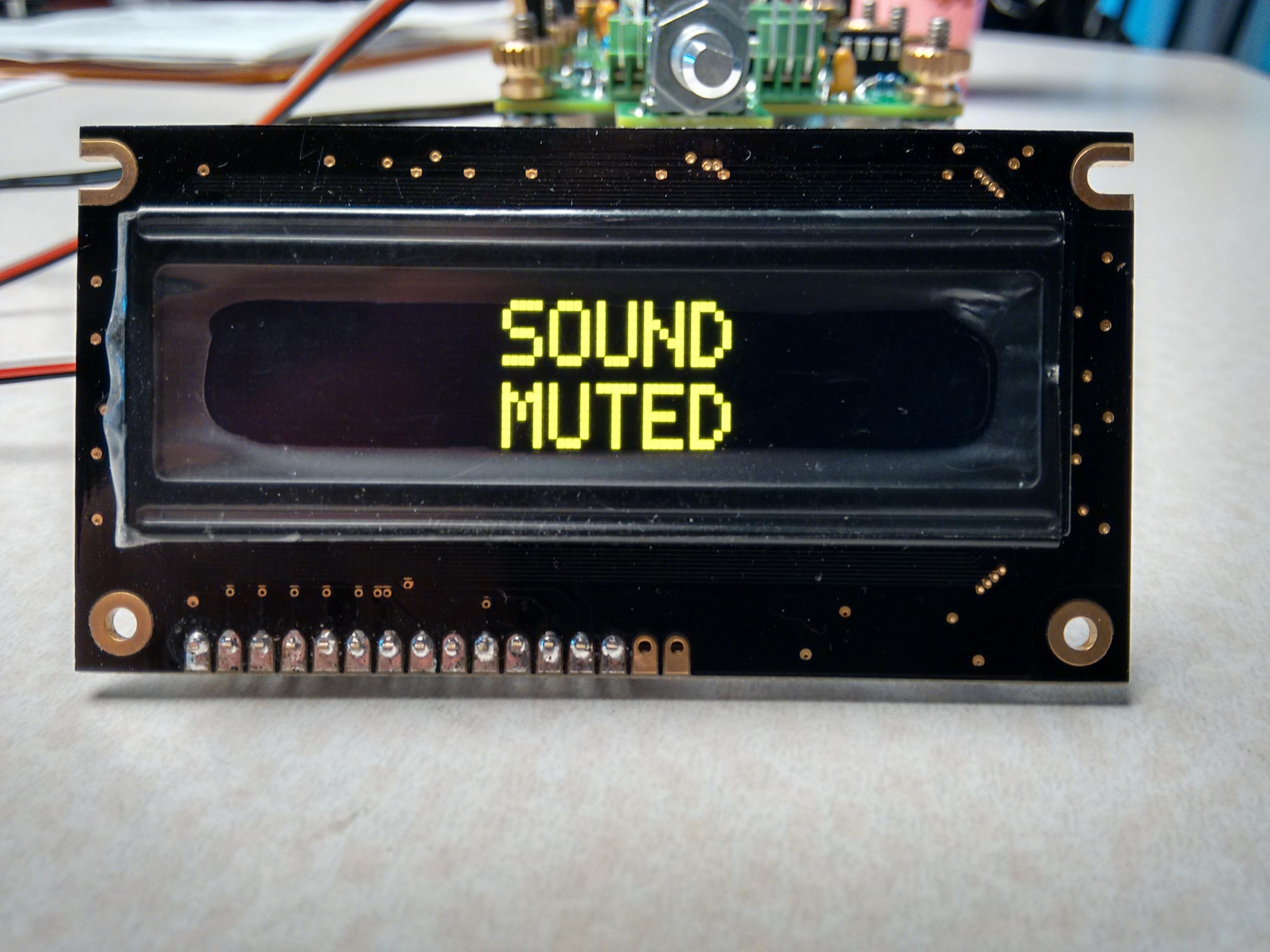

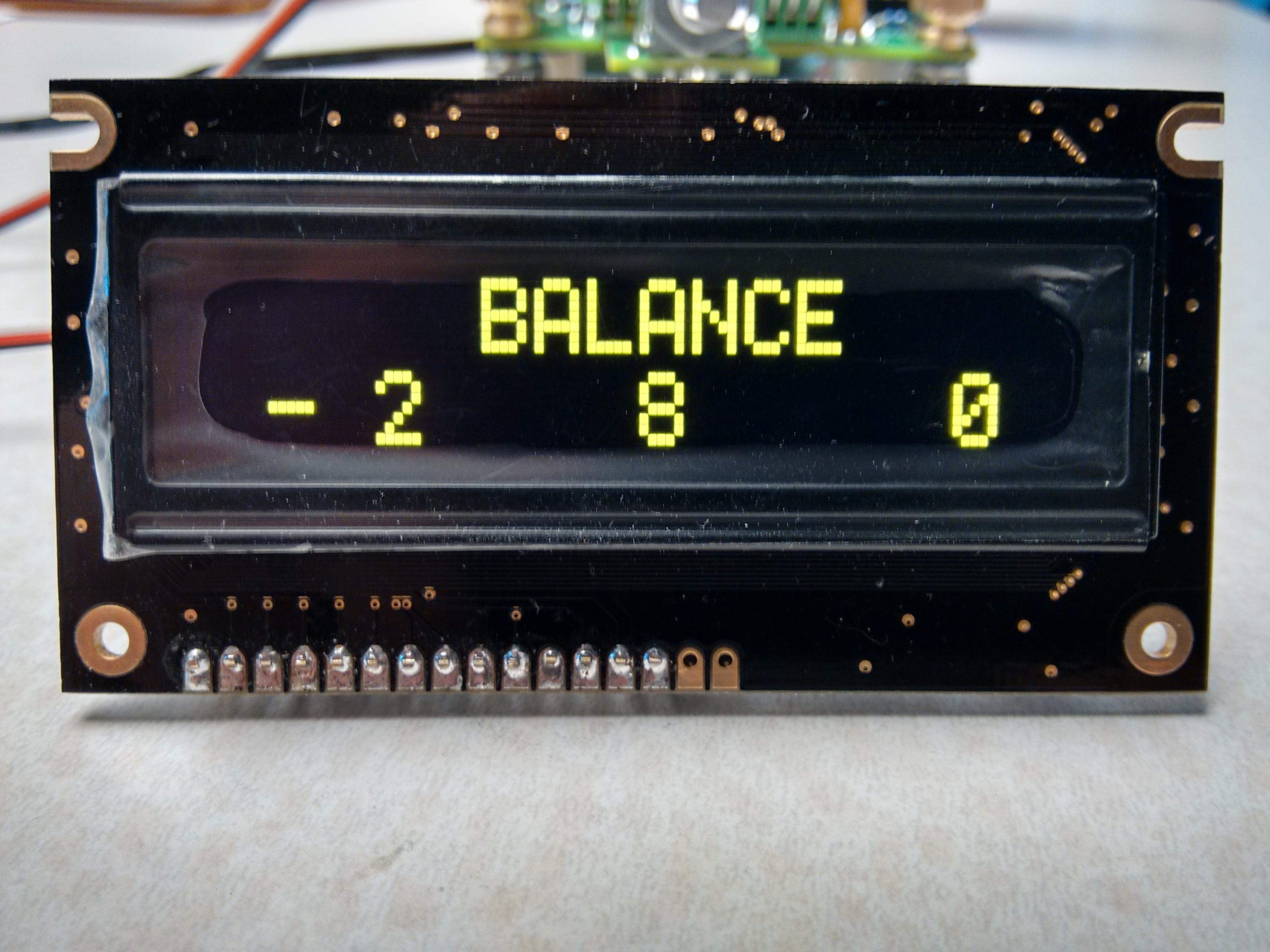

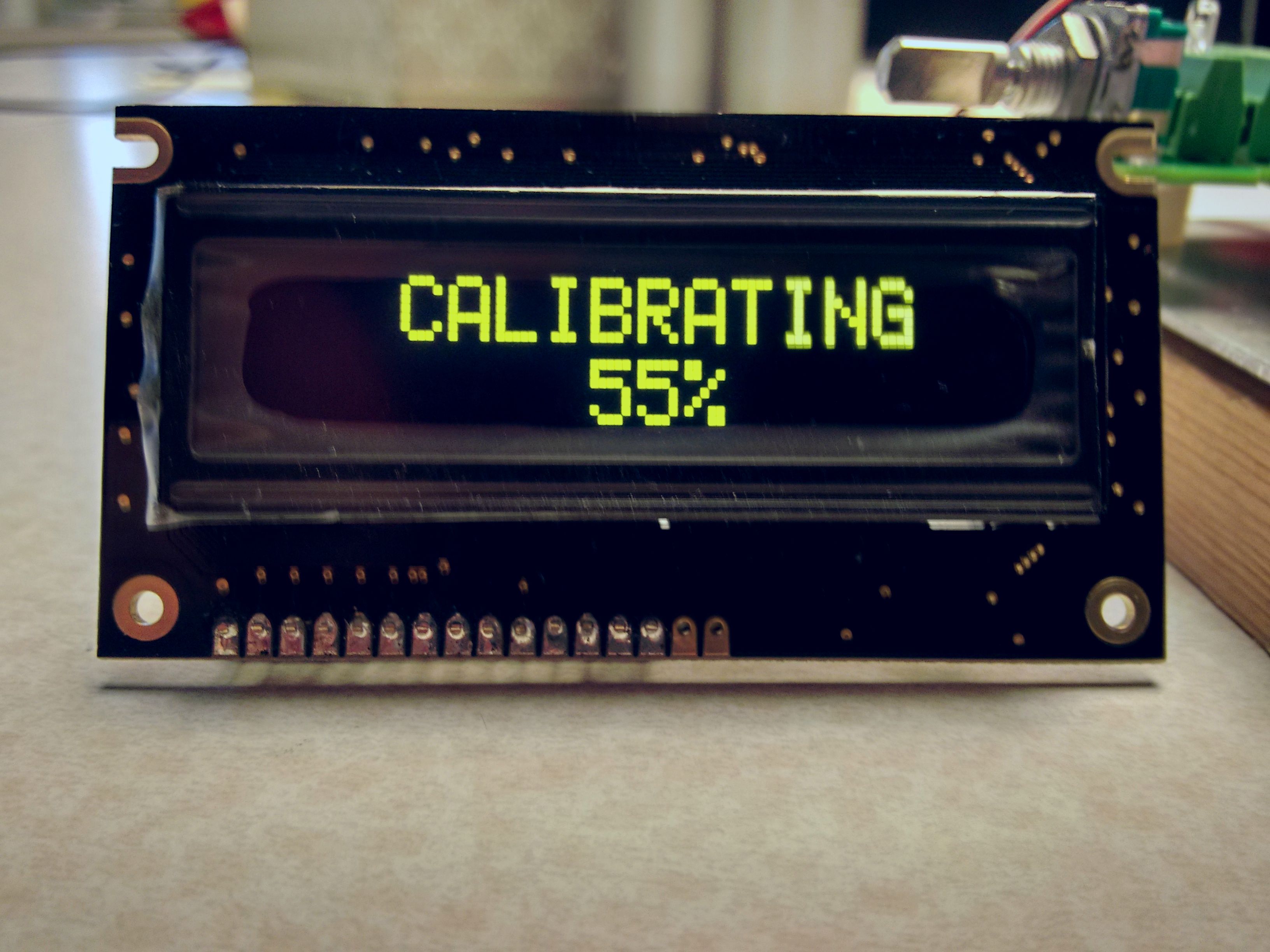

Other display modes:
Balance: with balance intentionally offset slightly. When balanced, both sides will show "0"
Sound Muted: When the device is muted, the display will blink.
Calibration %: When the jumper is inserted and power applied, the self-calibration cycle begins and the display shows the status of the calibration process in percentage complete. When calibration is 100%, the display will flash "CALIBRATION COMPLETE" and you can power down, remove the jumper, and you're good to go. Calibration typically takes 12~15 minutes.
