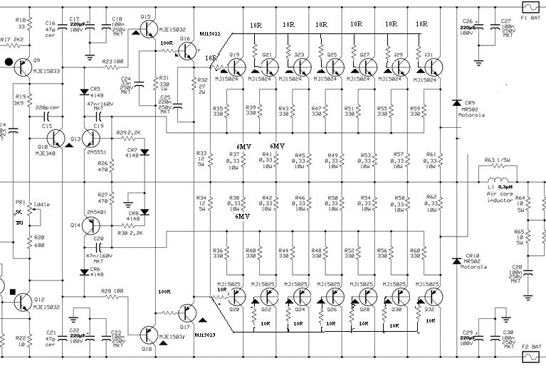

Re: Re: Hi fotios!
Hi zakzak
The main drivers MJ15020-MJ15021 are not common transistors as the rest of MJ1502x family of OnSemi. These have a large ft=20MHz and Cob=500pF, instead others have a narrow ft=4MHz. For this reason used in the driver stage, because their excellent frequency bandwidth. Unfortunatelly now are obsolete from the factory and the closest replacements as i can see are the MJL3281-MJL1302 with a ft=30MHz and Cob=600pF.
As for the bias trimmer, with the given values of 500R in series with the 680R resistor, you must get a voltage of +1,74V and -1,74V - respect to gnd - at the base of the corresponding predriver, so as you can put the output stage in class AB.
There is no need for base stopper resistor in each output transistor.
Regards
Fotios

Re: Hi fotios!
Hi zakzak
First of all don't worry. Also me in some cases of repairing i had the same problem of unavailability of MJ15020-21 and i used MJ15024-25 in their place with a little loss in frequency response.
Fotios

Re: Re: Hi fotios!
hi fotios. merssi
with 500R BIASE NOT STABLE AND THE MJ15024/25 IT,S burns(bom) .can use mje15032/33 in the place (Q16/17)
hi fotios. merssi

Fotios , it looks like a working good amp, but mje15032/3
are better for drivers (low hfe, high Cob, that is why you only
get 30/V uS . MJE340/350 has 5 times the gain -1/10th Cob.
Better to use the MJE15032/33's for a buffer stage in
a triple darlington config.Then use one of the outputs as
the final driver... put 50 devices per Rail to drive
1 ohm loads all day!!
A good example of this is on Rod elliots site..his insane 1KW
amp (project 117)...
http://sound.westhost.com/project117.htm
OS

Thanks for the good words and advices. I know this drawback of MJE153XX, and i am curious why Motorola (or OnSemi) does not make any effort to improve or to make new bjts suitable for the voltage gain stages where the common emitters they produce large TIM amounts if their GBP does not limitted.
As for this project, i have builded before 9 years about 40 units to drive each one a special subwoofer. This was the Peavey UDH (obsoletted now) a tremendous band pass type subwoofer equiped with four 15" BW speakers of 350Wrms each one. These subwoofers was imposible to give their killing bass driven by class D or G or H amplifiers. I used each set with the low pass frequency at the electronic xover placed at 120Hz! This amplifier due to its ultra low output Z (you can see the 7 matched pairs of output devices) proved very effective. I will try to post a photo of the interior of one amplifier because all are in work this moment.
At this time, i am not busy furthermore with such type projects. Instead, in my new projects for home use, i replaced all transistors from input up to the VGS with Toshiba.
If someone wish to make a reffinement of this project, then i am available for any help.
This project proved very durable for 9 years of continuous operation under peak power conditions for 5 to 9 hours per day.
