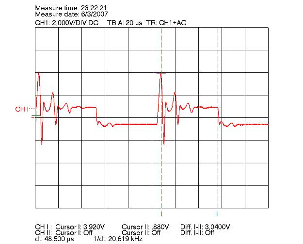

This is an oscilogram indicate the reaction of output inductor in a loading with 8Ù dummy paralleled with a capacitor of 2ìF. Of course it is not so good the damping. Maybe the inductor must be increased from 0,3ìÇ to 0,8ìH but his place inner the zobel - from error this! - looks to absorb the negative jump very well. From luck this! How it is happen this i don't know this moment.

Output Inductor Correction
Change the output inductor with a new as follows :

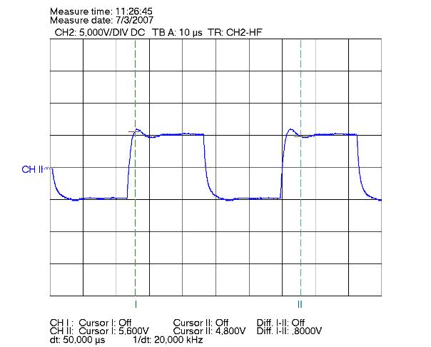

20 turns of Ö=2mm copper wire in two layers from 10 turns each, around a rod of Ö=8mm. A drill bit of 8mm is a good coice. Then the output reaction appears as in the oscilogram quoted in the same frequency of 20KHz. I repeat, this curve measured when connected in the output a dummy resistor of 8Ù in parallel with a capacitor of 2ìF MKT type. Finally, the inductor position inner the zobel looks like better from the usuall position after the zobel.

You can obtain a lower rise time than the original of 1,8ìs by changing C9 from 18pF to 10pF and R12 from 330Ù to 100KÙ. You can also remove this network but the Cdom (C13) it is small to suppress the overshoot and thus must increased from 100pF to 120pF. Either of the two changes offers a new lower rise time of 1,4ìs.
P.S. In the schematic does not appears the input termination resistor because in this place used a 50KÙ pot for level control.
Below it is the original curve of the rise time obtained in full output swing with a square of 20KHz in input and a 8Ù load connected in output. From this curve, Glen Kleinsmidth has calculated the slew rate of my amp at 30V/ìs!!! 😀 😀
