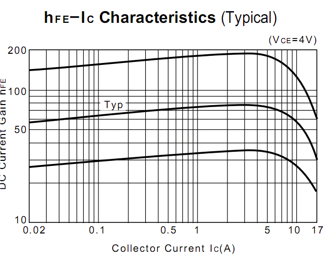

I will go for a Honey Bader.PCB already ordered. Did you do any changes from the original when you used 2SC2922SA1216? I will connect the output using wires because of the heatsinks that I already have. Any problems with this mounting of the devices?

I already did the preliminary on a badger - mt-200. The outputs will just barely
fit physically. The drivers will also barely fit. You might have to drill the Q13/14
holes out to mount the drivers closer to the PCB.

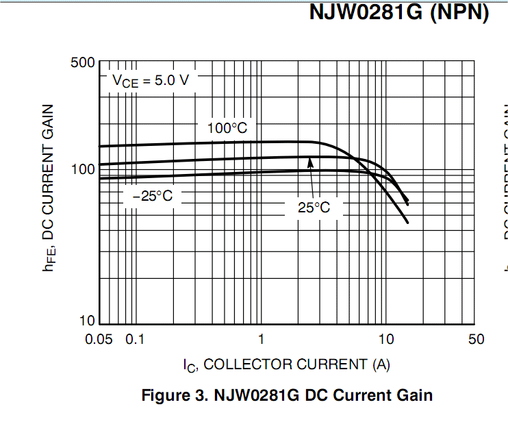

That the physical half of this. Electrically - compare the "typical" current gain
of a 2sc2922 to a njw0281 (below). The drivers will see a higher load <8R , especially
at 4R. In fact , you will never reach the 3 pair 2SC2922/2SA1216 maximum
SOA before driver failure.
In short , the badger is an EF2 designed for high beta outputs.
You might get away with 2 pair in the badger , here you could just run the VAS at
10ma Ic.
The multi pair 2SC2922/2SA1216 amps I've seen were all EF3 with huge mt-100
drivers.
(below 1 and 2 - 2922 and 0281 - middle plots)
