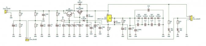

A particular LM317HV regulator
Yes, I read about this regulator. Time ago a made a pcb prototype based on this kind of schematic (with mosfet as pass element).

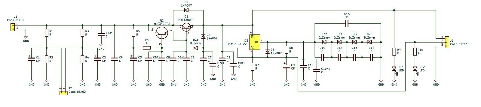

Circuit in post #1. My advice: avoid.
Tricky to judge without knowing what the designer intended or having component values. But for a pre-amp I'd say it's overly complex. Bizarre zener voltage source for the regulator. Regulator output fed back to its input is problematic. Too many capacitors. Just doesn't look expertly designed to me.
