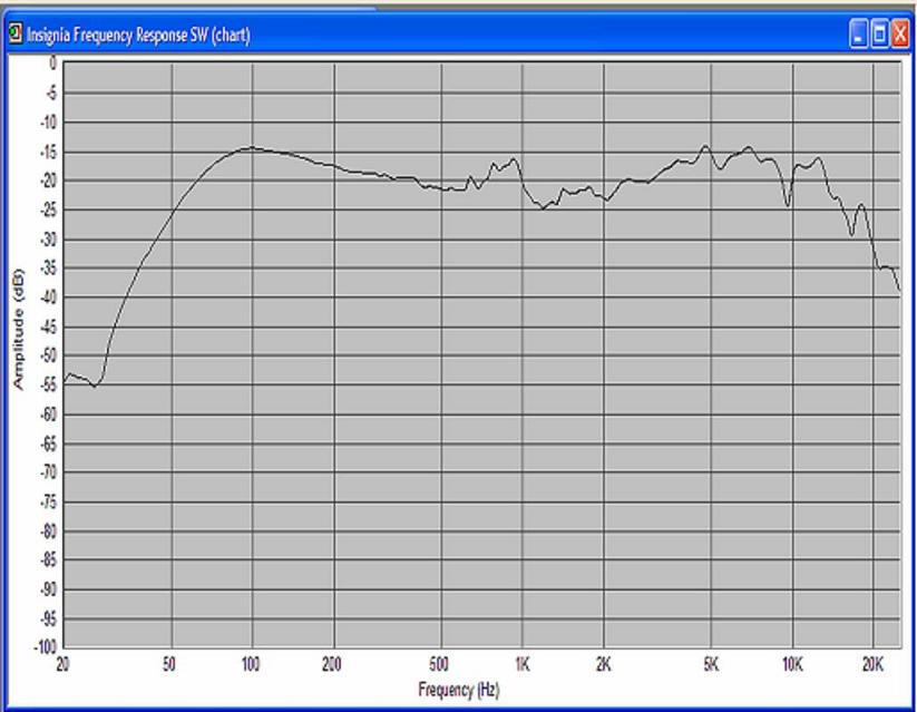

All right, I just finished the FR of these but I cant get a copy of the chart out of SW, im rather irritated but thats expected at 3am.
So I now know that my system measures almost exactly like Zaphs except for more of a hump around 100-180 hz, this might be a port merge error though, and I need a different mic mine rolls off around 18khz, $35 well spent. The mic is, was used by audiologists although the output is really low and all 1m measurements averaged -60dB.
Anyways, if anyone knows how to get a copy of the graph out, I would like to know.

Thanks for confirming the measurements. Like you said...$35 well spent.
After 7 days of 8-10 hrs of play, I've noticed improvements in bass. One guy said his treble only STARTED to open up correctly at 8 days. So mine may still improve a little more.
This is really good to know, I will use them as mains for awhile to break them in. After that I will (eventually) stiffen the boxes up and retest them, tweeter and woofer separately of course and redesign the crossover.
