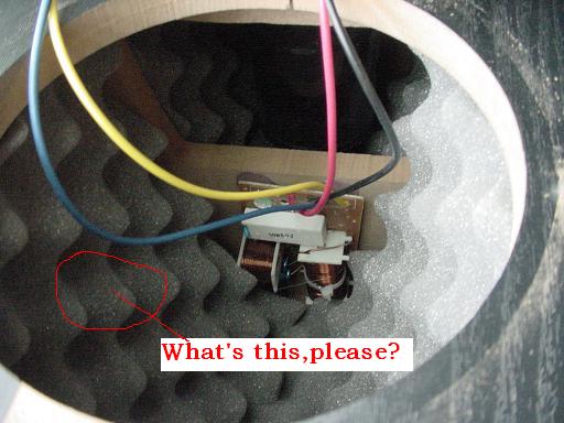

AJinFLA said:An externally hosted image should be here but it was not working when we last tested it.
does this kind of stuffing increase apparent volume and attenuate mid bass on the inside of the box?
i know softer materials do that and i was going to buy some for a couple of speakers i'm building, but now having seen that picture... i've got quite a lot of that grey foam!
thanks a lot.
It is very low buget foam that 'purports to appear' to be acoustical in nature. Of course, most acoustical foams fall under that glare as well.
As for Chinese manufacturing, well, I'd be telling tales out of school, now. But rest assured, it is churning along just like Japan and Tiawan did, except the change is talking place twice as fast.
I mean, I even know guys from this side of the pond who go over there and design woofers right at the chinese factory. It doesn't take long to trickle down. Then, we send all our metals over there, and we can't afford to buy the raw materials over here any more, thus driving the price of our OWN product through the roof, while facilitating the manufacturing of even cheaper chinese stuff.-augmented by teaching them the finer aspects of bulk 'quality' manufacturing.
They use the same hardware, and are learing very quickly to manufacture their own hardware. For example, We'll be buying chinese made blow molding equipment soon-at 1 TENTH the US made prices.
And round and round we go. Where we stop, nobody knows.
