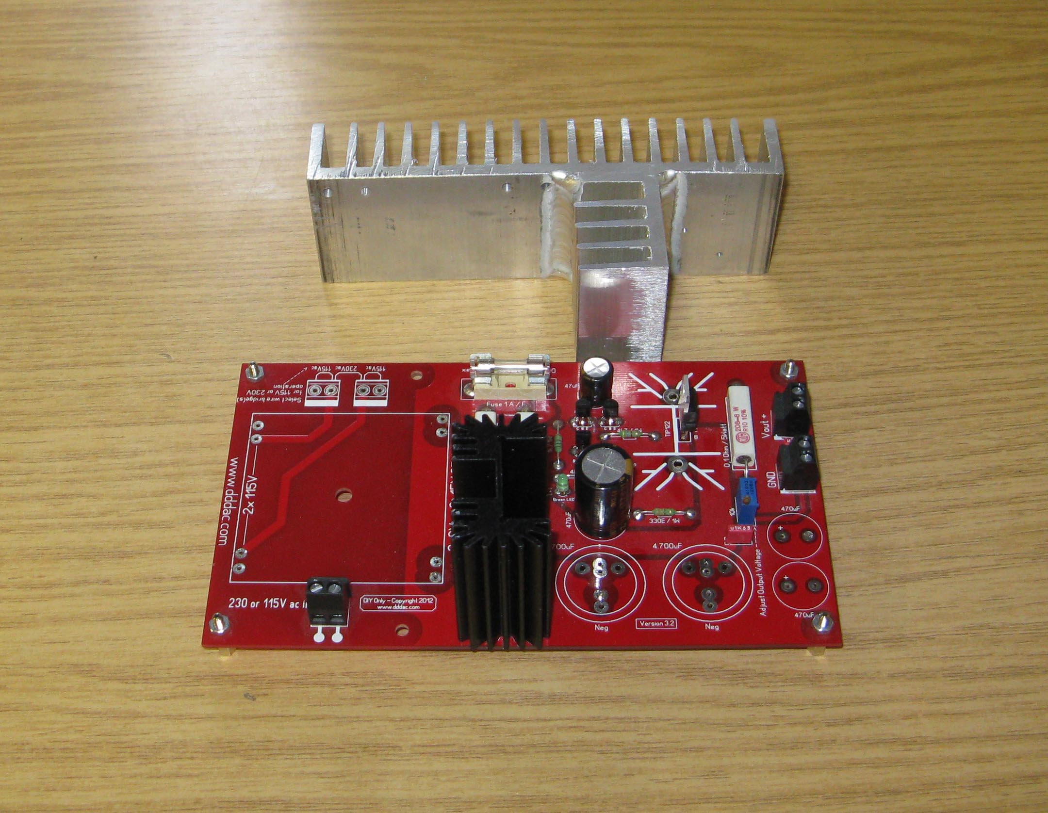

I can possibly get a bigger trannie but I'm not sure how easy it is to replace the heatsink with a bigger one on the PCB. I don't have a chassis yet so chassis mounting is not an option now.
Any one know if it is okay to just parallel two 12V supplies for the required current output? Would there be undesirable interactions between the two regulators?

I have the advantage of being able to weld Aluminium so I have made up the heat sink below.
I normally test heat sinks using the finger method but it was a bit hot for me this time which is why I used a temp gauge.
I hope to run 10ºC above ambient .....

Hi Almeg, is there a reason why heatsinks are aluminium and not steel?
Just curious, nice welding by the way.
As I know alu has 3 times better heat conductivity than iron and 4 times than steel.
Plus lot lighter and heat conduction needs thick material.
Plus lot lighter and heat conductivity needs thick material.
Ally is a very good heat conductor and as it has low mass compared to iron or steel will dissipate the heat better due to less heat soak.

Almeg69: isn´t it easier to just bolt the reg to chassispart?
best
Leif
Yes, but I want a self contained module that will be easy to swap for comparison duty
