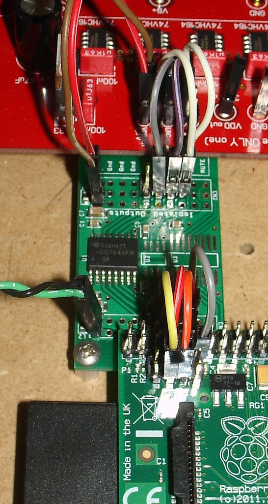

has anyone else tried Palmitos approach and feeding the DAC with I2S coming from an raspberryPi? I am highly interested in this because if you look (hear) at the sound quality you can get from a very simple DAC like the Hifiberry I am wondering what would be possible with a "state of the art" DAC.
I had not commented on the sound because I'm currently playing with using the LL1684 transformers for output. The i2s rpi input in my ears sounds better, more dynamic & more detailed, than the waveio. I like the waveio better than the amanero for i2s, so this implies that the rpi also sounds better than the amanero, but I have not actually compared them. I removed the waveio permanently and have been testing other things (isolator and transformer output) with the rpi. I think it will stay there until a better embedded platform offers i2s support (udoo, beaglebone black, cubietruck, etc.).
I tried using the diyinhk amanero isolator between the rpi and the dac but thought it cut on the dynamics and detail some. But I made the mistake of powering the rpi side of the isolator with the rpi 3.3v supply. I will hook it up again later powering the rpi side with an independent 3.3v supply, using only the i2s lines from rpi into the isolator. Even though the isolator cut on the dynamics and the detail, it did make the background very quiet when compared to the direct i2s to the dac.

I have been trying the pi I2S output last weekend and I am not impressed yet.
I used a cheap samsung switching power supply so I expect that contributes to the bad sound.
You can hear rough highs that are probably created by; power supply, jitter and digital noise on the pi ground.
I would also expect that the wave io is better due to the nice clocks, asynchronous streaming and ground isolation.
I do not want to jump to conclusions because I believe that dispite all theory one can only judge by listening to the differences.
I will try it with a nice linear shunt supply later.
The waveio clocks are much better than the rpi's, no question on that. An isolator board will help with the ground sharing problem I think?
When I first hooked it up with the cap output it did sound harsh compared to the waveio, but even then the dynamics and detail were better to my ears in my system. Adding the LL1684 instead of the caps took care of a lot of the harshness.
Last night I added the diyinhk amanero isolator but this time powered it from the 3.3v external power supply instead of the rpi's 3.3v pin. It does sound cleaner and regained some of the lost dynamics and detail. I'm leaving it like this for now. Maybe a better isolator and a reclocker would help (like an Acko board or Ian's FIFO or maybe just changing the TI chip for an NVE IL715E in the diyinhk isolator). I will try later and see.
The waveio clocks are much better than the rpi's, no question on that. Maybe a better isolator and a reclocker would help (like an Acko board or Ian's FIFO or maybe just changing the TI chip for an NVE IL715E in the diyinhk isolator). I will try later and see.
I am running the pi with an isolator and a reclocker and it sounds fantastic! This setup is called Wave IO
But seriously: I would expect a good isolator would help. Wouldn't it also be possible to put an accurate clock on the Pi?
But the waveio is a usb receiver that has to process the usb stream into i2s. The rpi is bypassing that and giving you straight i2s, unless there's something I'm not getting. Otherwise there would be no purpose in using the rpi with i2s.I am running the pi with an isolator and a reclocker and it sounds fantastic! This setup is called Wave IO
I'll try hooking up the rpi to Ian's fifo see how it sounds. But with just the isolator it sounds good for me, others mileage may vary...
