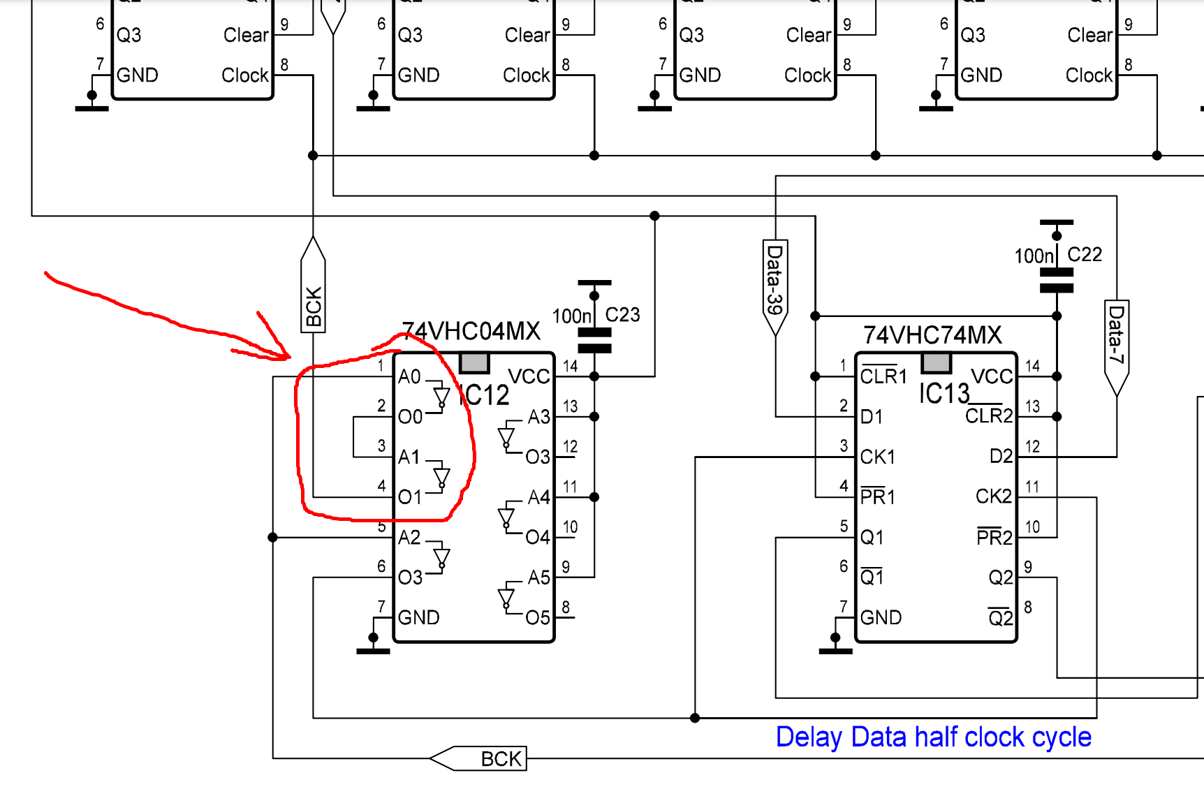

Hi everyone.
I was wondering if these two not gates in series (circled in red) are only a buffer for the BCK signal going to the shift registers. Is this correct or do these gates have any other function?

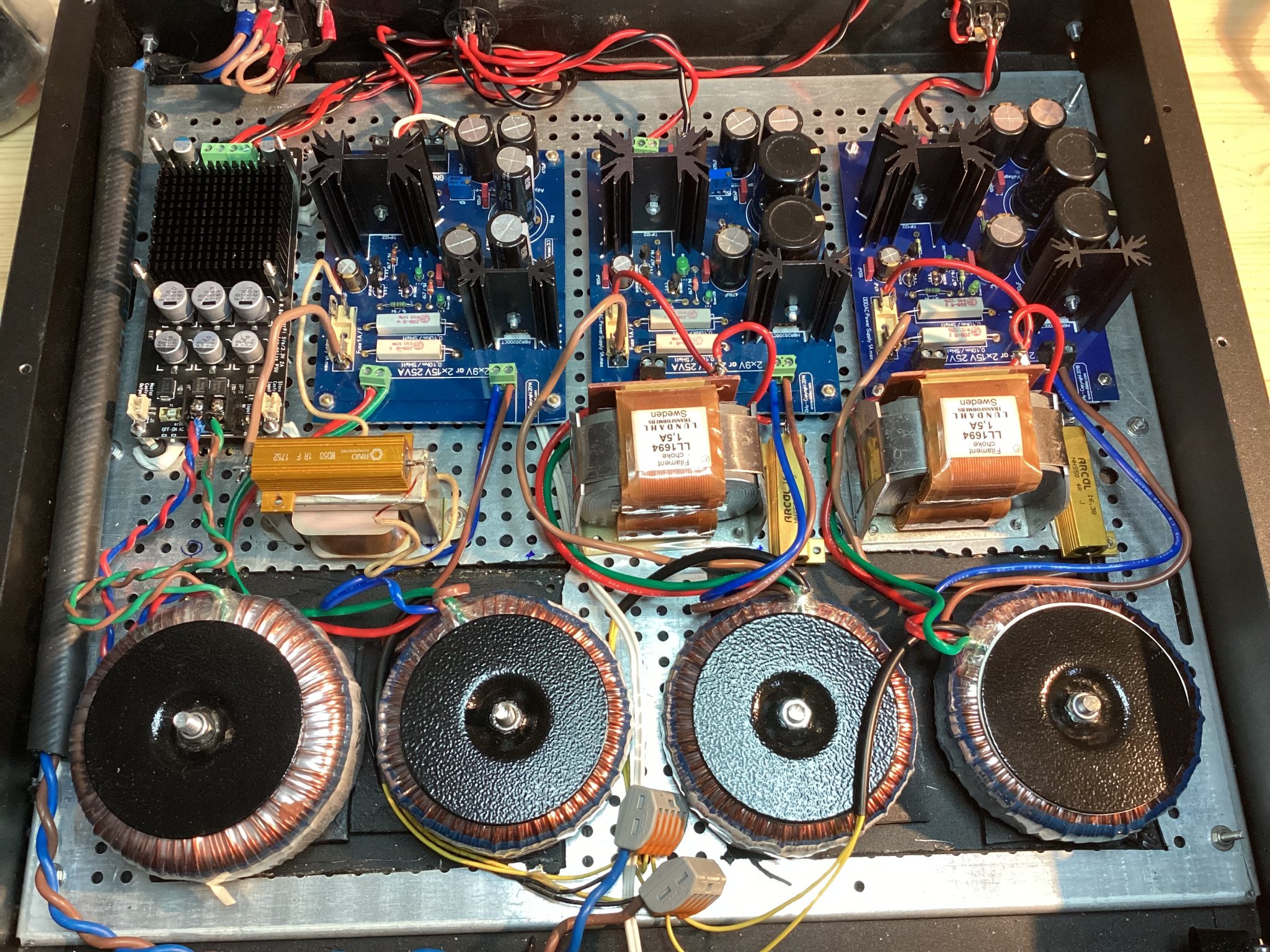

Inspired by doede I took some bleeder resistors I have and connected them the ‘’doede way’’ after the Lundahls and Hammond choke, in my power sypply. The two resistors for the Lundahl chokes are rated 4 ohm and the one for the Hammond is 1 ohm. As the picture show, I have bigger trafos (80vac) than the stock ones from doede.
All the chokes are 1.5A, and 160mh (serial connection). The improvement was easy to hear. Tighter bass, in fact everything sound better.

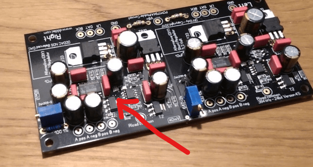

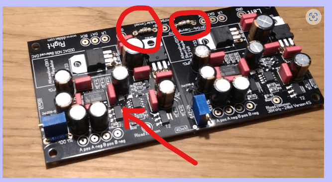

I have a 1794S (blue) mainboard and just stacked up two more decks from the last series. On one of the channels I can't adjust current. There is no voltage drop across the 100R resistor.
Solder joints are redone. Trimmer has been taken out and checked and is ok. Voltage across VB+ and the associated GND is 12,4V. Turning the trimmer doesn't change current, voltage across test point stays at around 35mV.
Voltage drop across the 7810 on the "good" channel is 1.85V, across the 7810 on the "bad channel" it is 2.12V.
Does anyone have a hint how to troubleshoot this further?
OK, so we have the cause, not enough voltage for the PCM1794 to work.
Could you please measure the following voltages:
at both BAD and GOOD side of the Dac Module:
Voltage across the resistors directly next to VB+
At the bad side:
Voltage input AND output vs GND of the 7810
Voltage input AND output vs GND of the LF33
Just ahead of things, as you are in Germany (?) if all fails, you can send it to me for check & repair...
ok, seems the error is in the embedded Tent Shunt or the DAC chip itself....
There is nothing you can do yourself here, as the Tent circuit is not public.
Also replacing PCM1794 is not easy if you do not have the right SMD soldering tools.
probably best is to send the stack (mainboard with dac-modules connected) to me. no chassis or PSUs needed....
best regards
doede

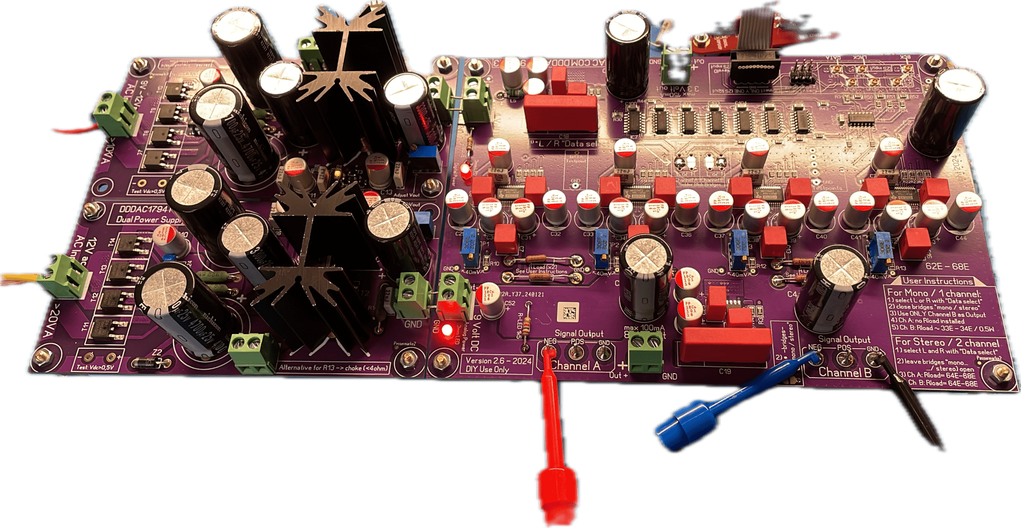

MK3 quick update….
DAC and PSU Boards with SMD Parts are in. I received all parts for the DIY kits. I built two test versions. All is working fine, AP tests are great and very satisfying. I am having the boards a couple of days on burn in right now. Listening tests will be in the coming week. If all is 100%, the boards/kits will be sent to Audio Creative, who will be “taking care of business”
Here is a photo of the test bench…
