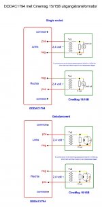

I've got a set of cinemag 15/15b for my dac but can't find the wiring scheme for them. Anyone able to help with this?
Check out the latest posts re this topic. The posts are #8712 to #8714.
here it is....
here it is....
Thanks Doede, what value resistor should I use for R-load? Is a standard 1/4w metal film resistor will do?

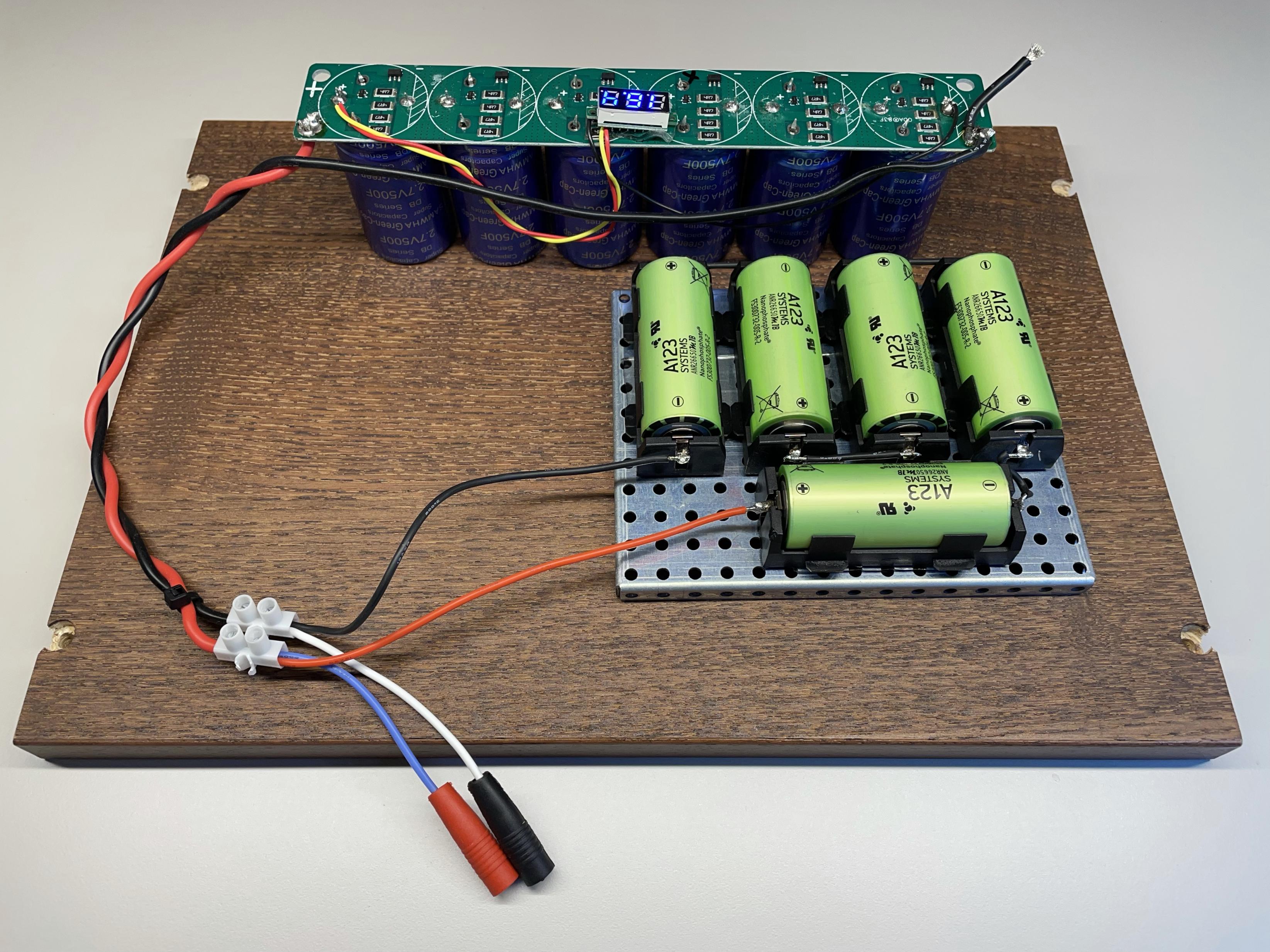

Agree Ed, for experiments fine, but in this bank of 6, the highest is 2,9 Volt and the lowest is 2,45 Volt, when having 16,5 Volt …. I would not trust this for long term solution. When time comes, I will buy some quality stuff
1k8 should work best for minimum overshoot, but it is not critical - standard will do
sorry i mixed up the 15B with the 600 series
the 15B should be terminated with 10-15kOhm (that includes the load of the next input of the next stage
